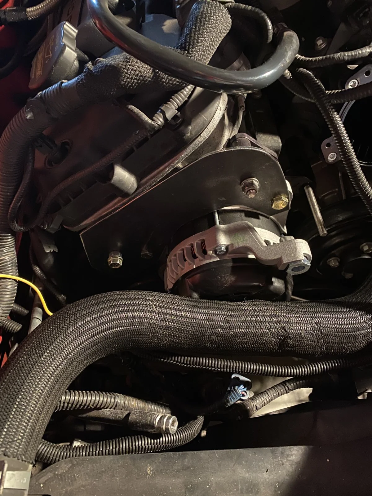

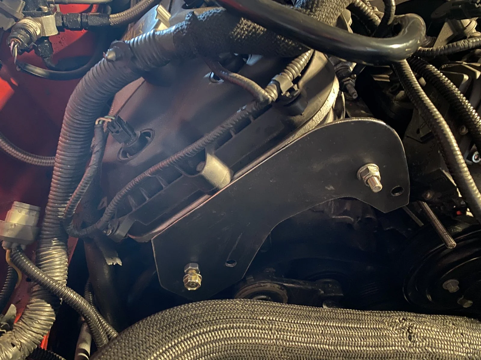

So I ended up getting the 2012 alternator and running it through the control pack. Also upgraded the power wire to the alternator to a 4 gauge. Homemade a bracket instead of paying $250 through PBH and so far so good. Only time will tell if my issue is fixed.
