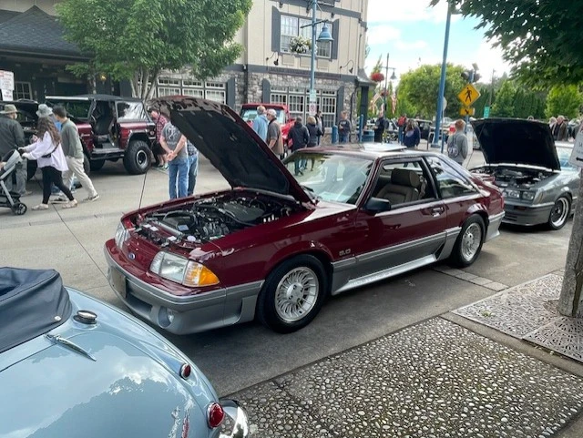

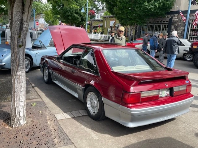

Been driving the car pretty much daily since it has been back together. A couple months ago, the wife signed up both our foxbodies for a car show that was last weekend. The front suspension was tired when I got the car with 212K. Car now has almost 224K. Needless to say the drive quality and handling has been getting worse and worse. Memorial weekend I decided to start cleaning the cars for the show so out came the pressure washer. I cleaned the engine compartment and front suspension in preparation for the front end rebuild even though I did not plan on doing that till later this summer. Well after the cleaning, the front end squeaked after about 5-10 miles of driving which drove me crazy. I had everything to do the rebuild but new front struts so I decided to start on it. Unfortunately, I just could not swing the extra money right now since I just spent $700 for a phaser kit for my wife's truck. So the KYB's, which are still in good shape, will have to do for a while longer.
I couple months ago, I rebuilt the original control arms off my Saleen so I could just swap them when I was ready. Moog ball joints and TRW bushings. I bought a set of MM camber plates a couple years ago but they would not work with the MAC strut tower brace that came with the car. Local guy had a MM that was just used for mock up that I picked up last summer. I also found a set of Saleen racecraft springs locally last summer that were cheap so I picked those up. The sway bar end link bolts were all bent up so I picked up a set of energy suspension ones as well as the D bushings. New rack bushings, inner tie rod ends, and a MM bump steer kit round out the parts list. Oh I also put all new wheel bearings in the front. The original ones looked like they have got hot a time or two.
After lots of hours, working in the evenings, I got the car all back together and aligned early last week so we could go to the show this past weekend. Car is about 1.25" lower now
Here are a couple pics from the show last weekend. The wife was nice enough to wax both cars
