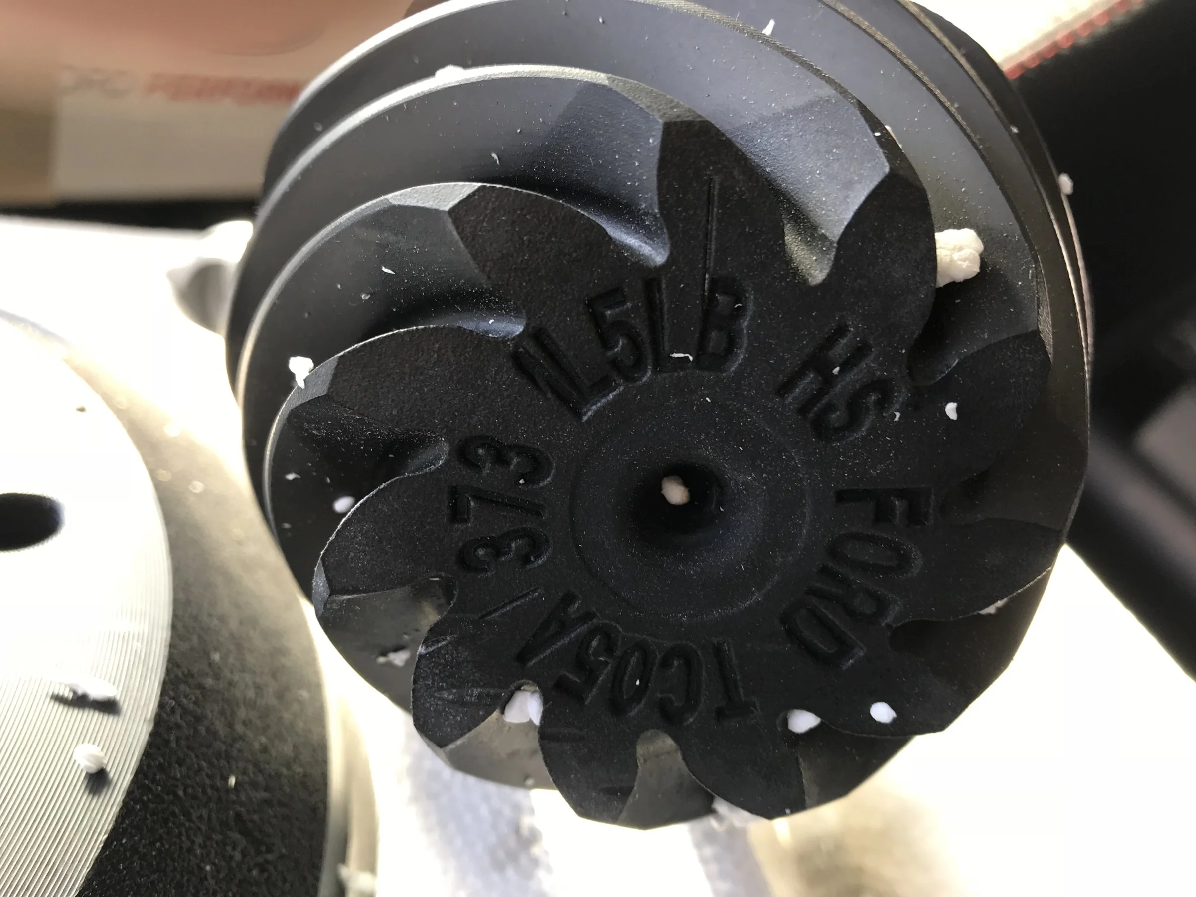

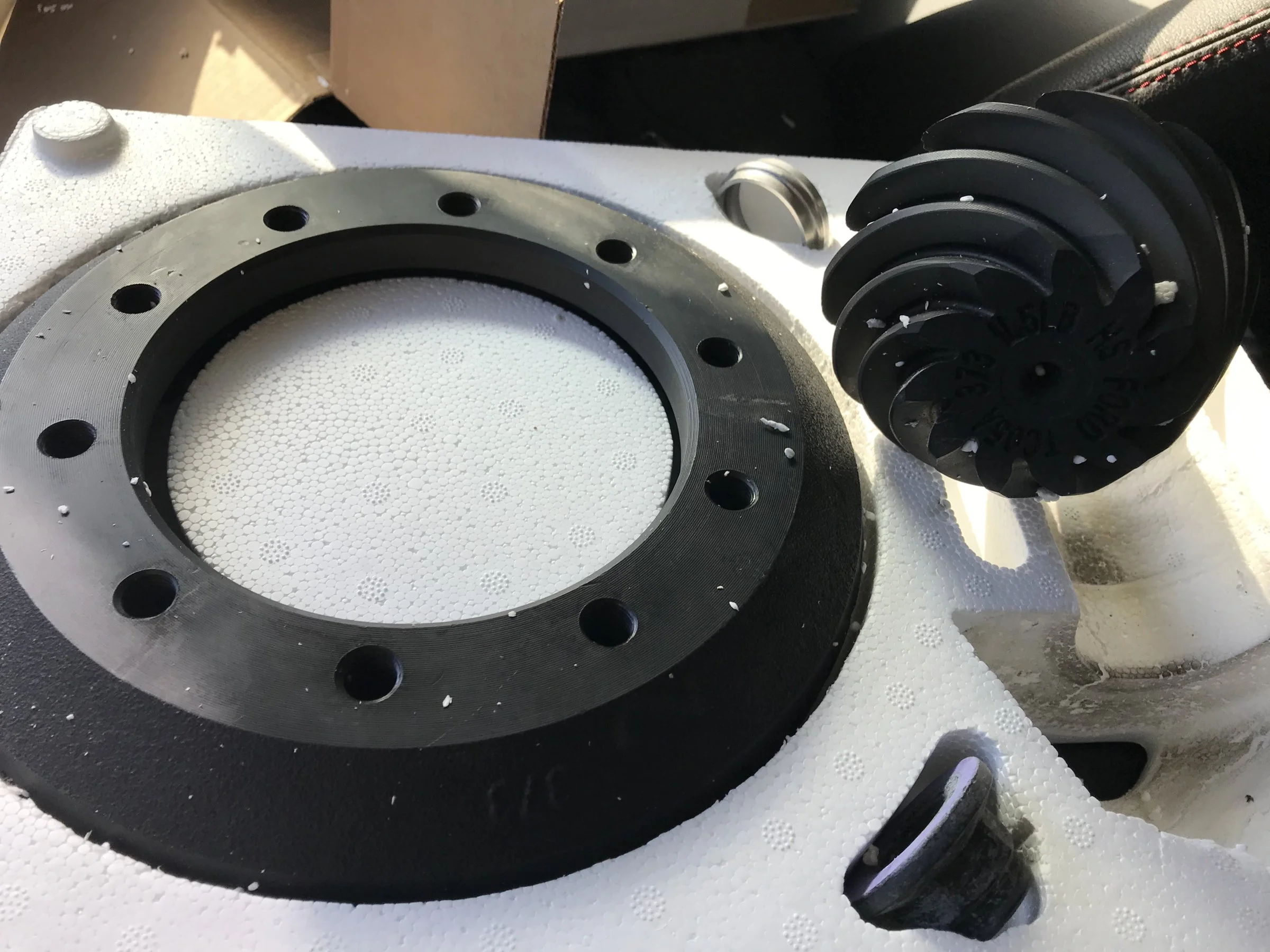

MOAR PARTS
Ford Racing 3.73’s for the rear end. Hopefully these will be a good match for the trickflow top end kit I have planned. Either way I’m confident they will be an upgrade from the stock 3.08’s. Still expecting a couple more deliveries this week. Stay tuned.

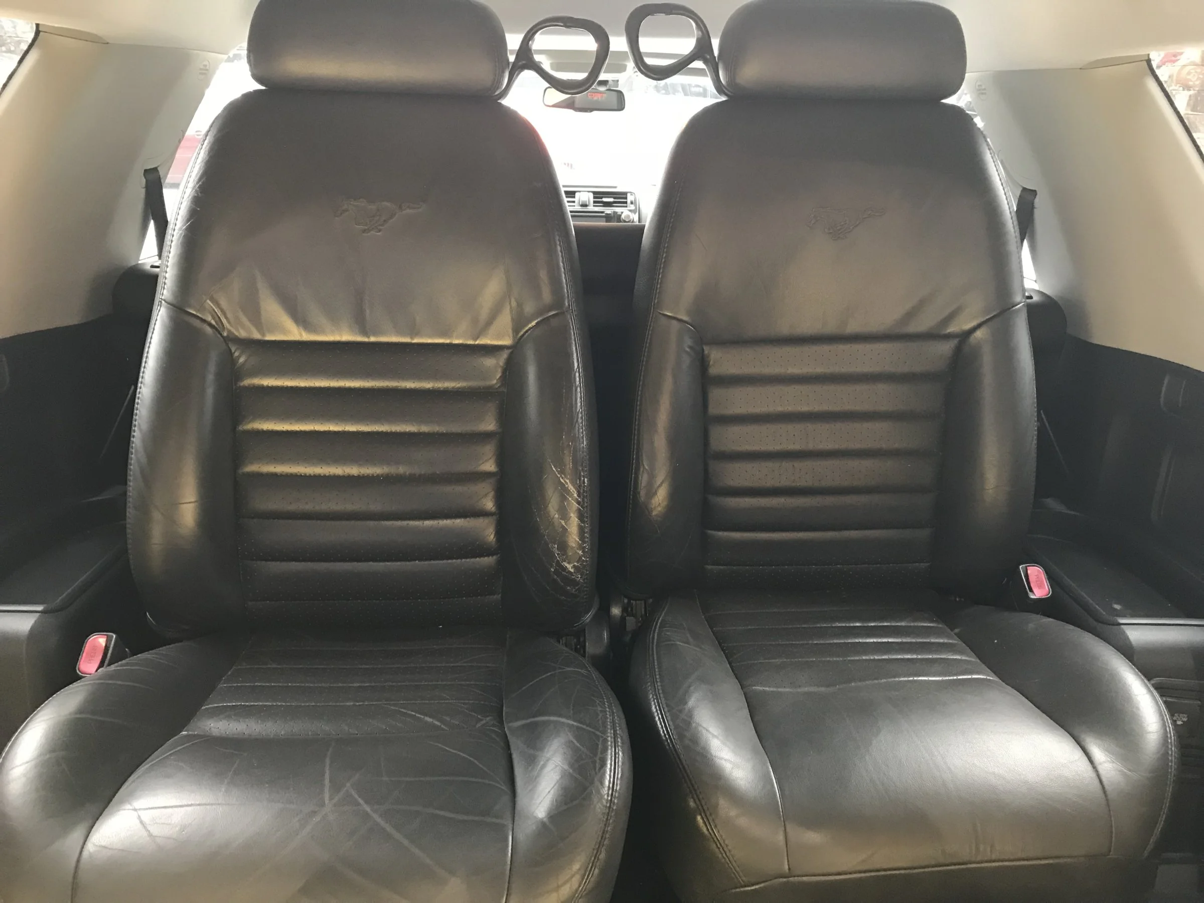

And I know I’m a little out of order on this purchase, but I snagged these today. Some minor wear on the drivers side, but otherwise comfy and possibly a good start to a black interior conversion. I know they sit a little higher than the originals, so if I don’t like them, I’ll just sell them. Gotta love leather.

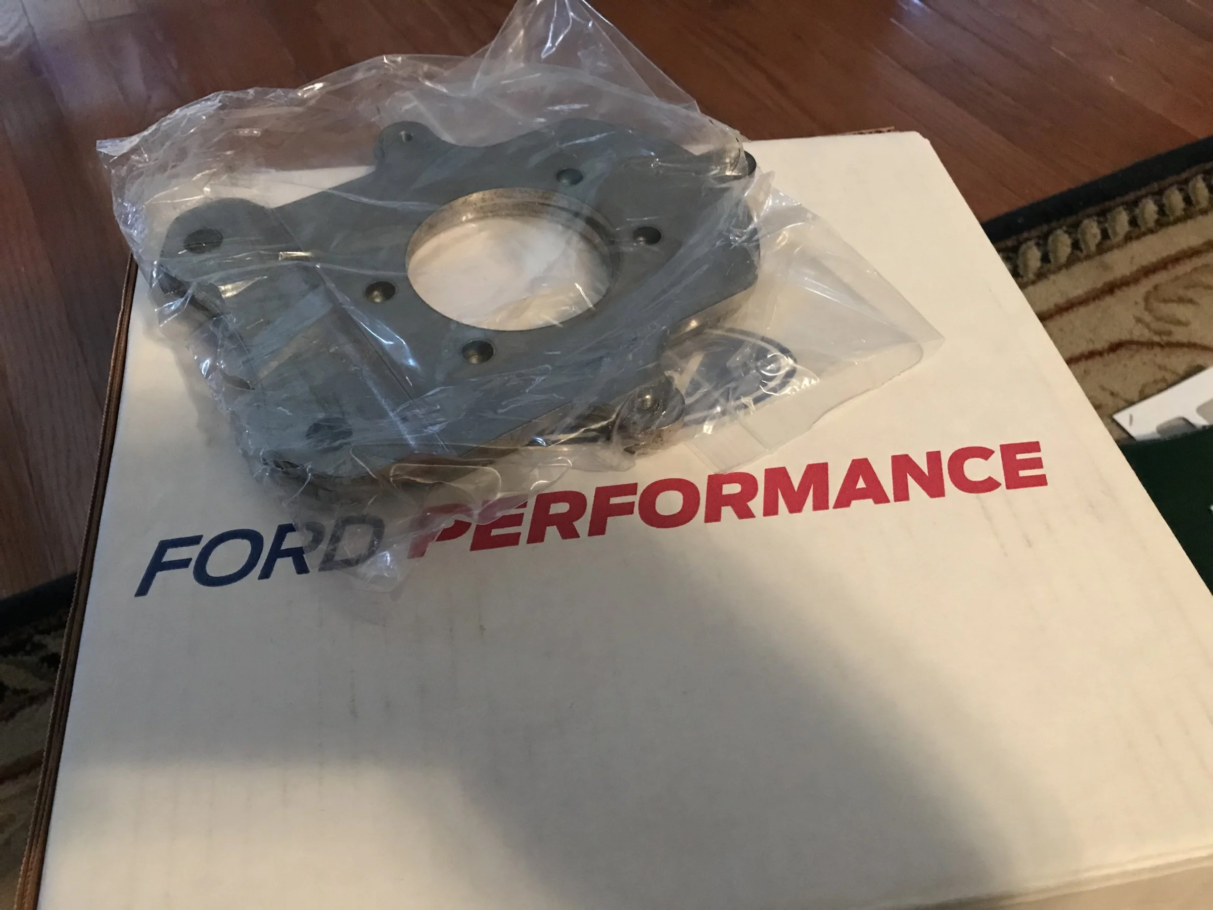

Some more parts came in this week.
NRC brackets for the rear cobra calipers and the Ford Racing rear end install kit. Lots more inbound.

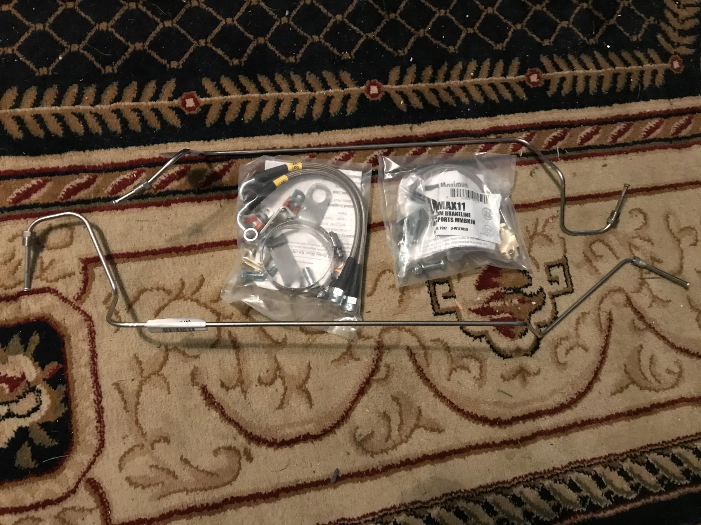

Max Motorsports rear plumbing kit arrived today. Hopefully by the time all my parts are here, the garage will be ready.

Which one is hot and which one is cold?
Ha. Hot’s always on the left. Also, poop goes downhill. Basics man, basics.

Thats why the contractor said the new loo had to be 50' from the back of the house. The property runs slightly down back there. He also told me that the hot was placed on the left so right handed people didn't burn themselves.

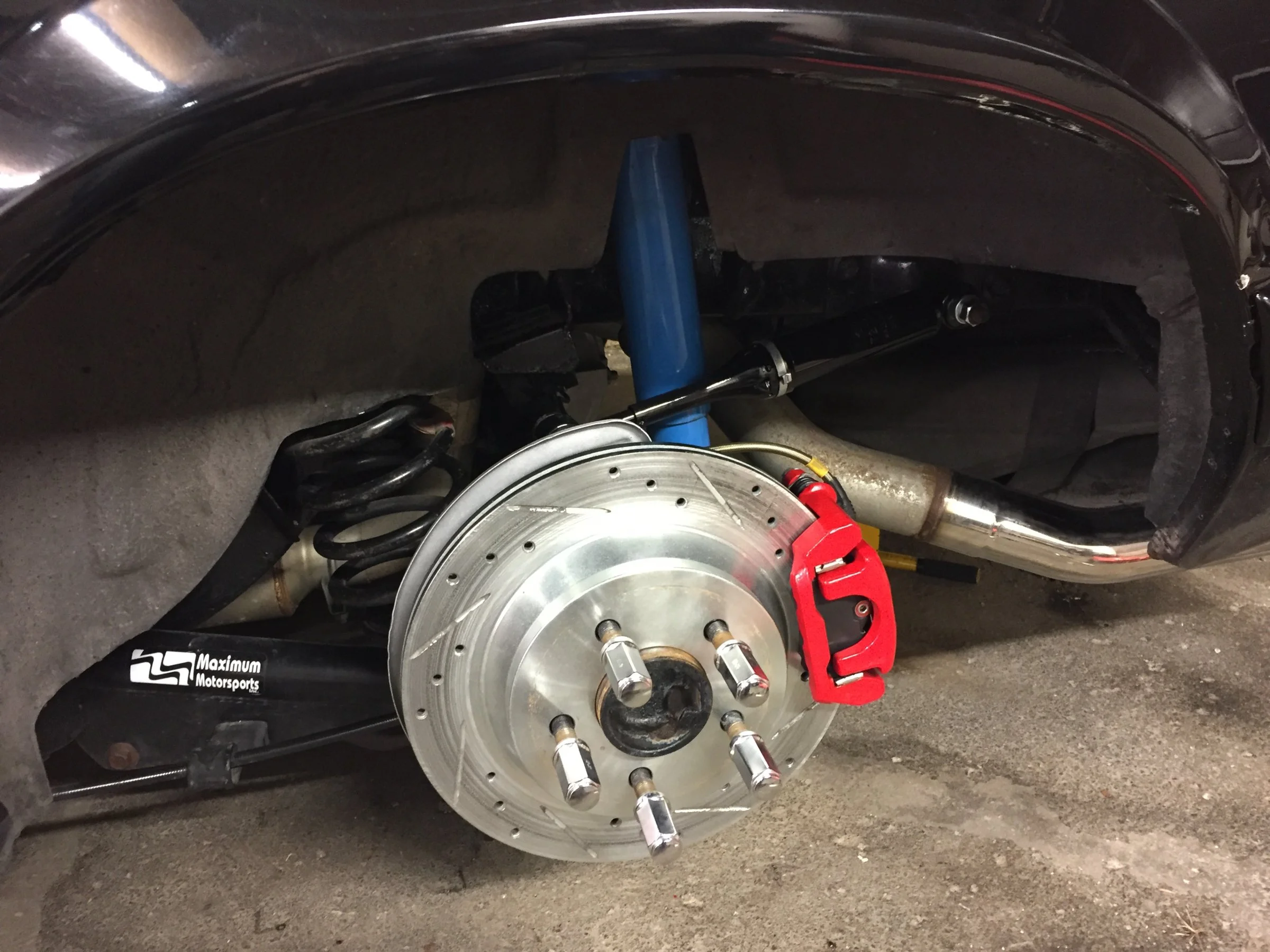

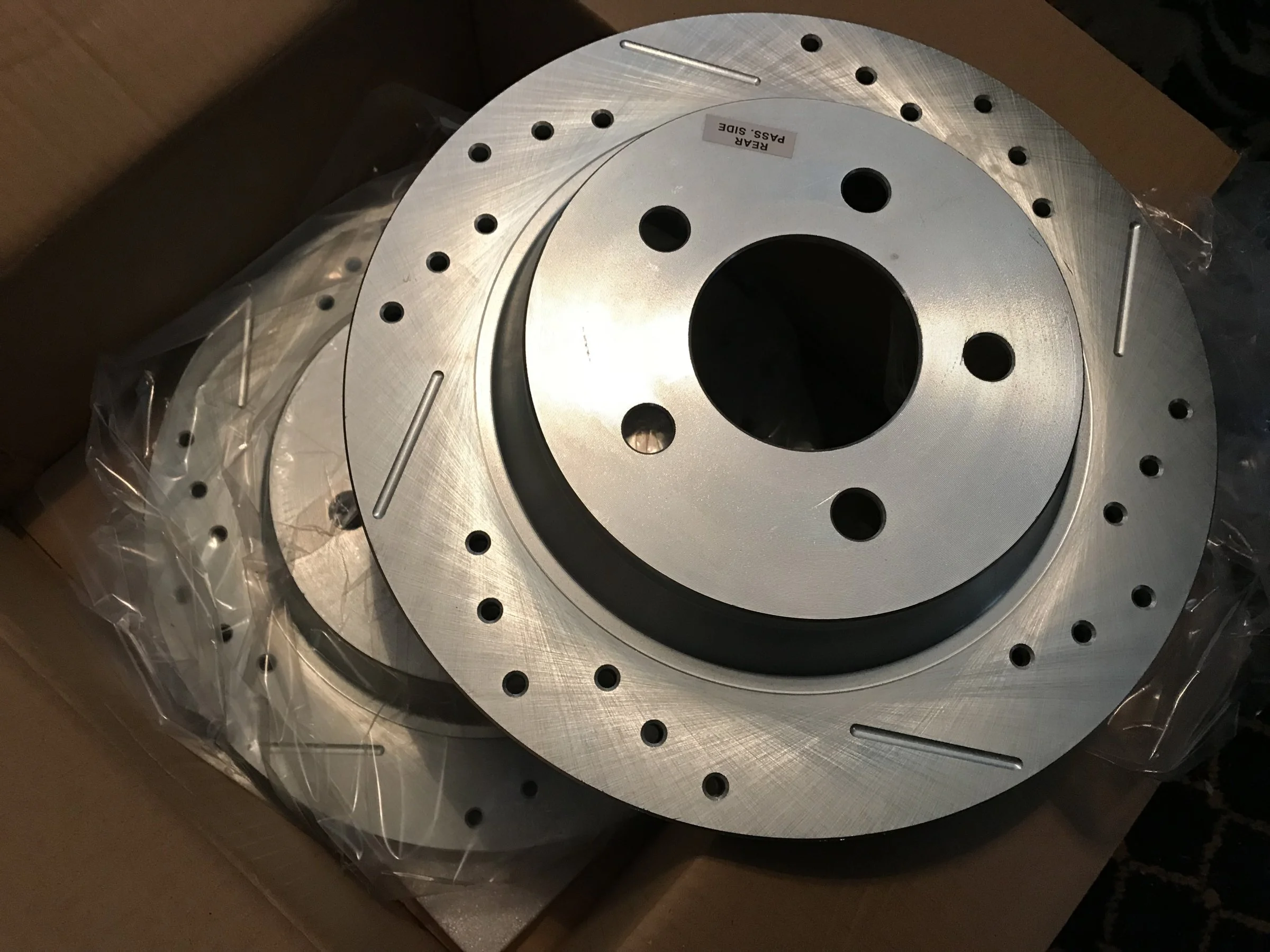

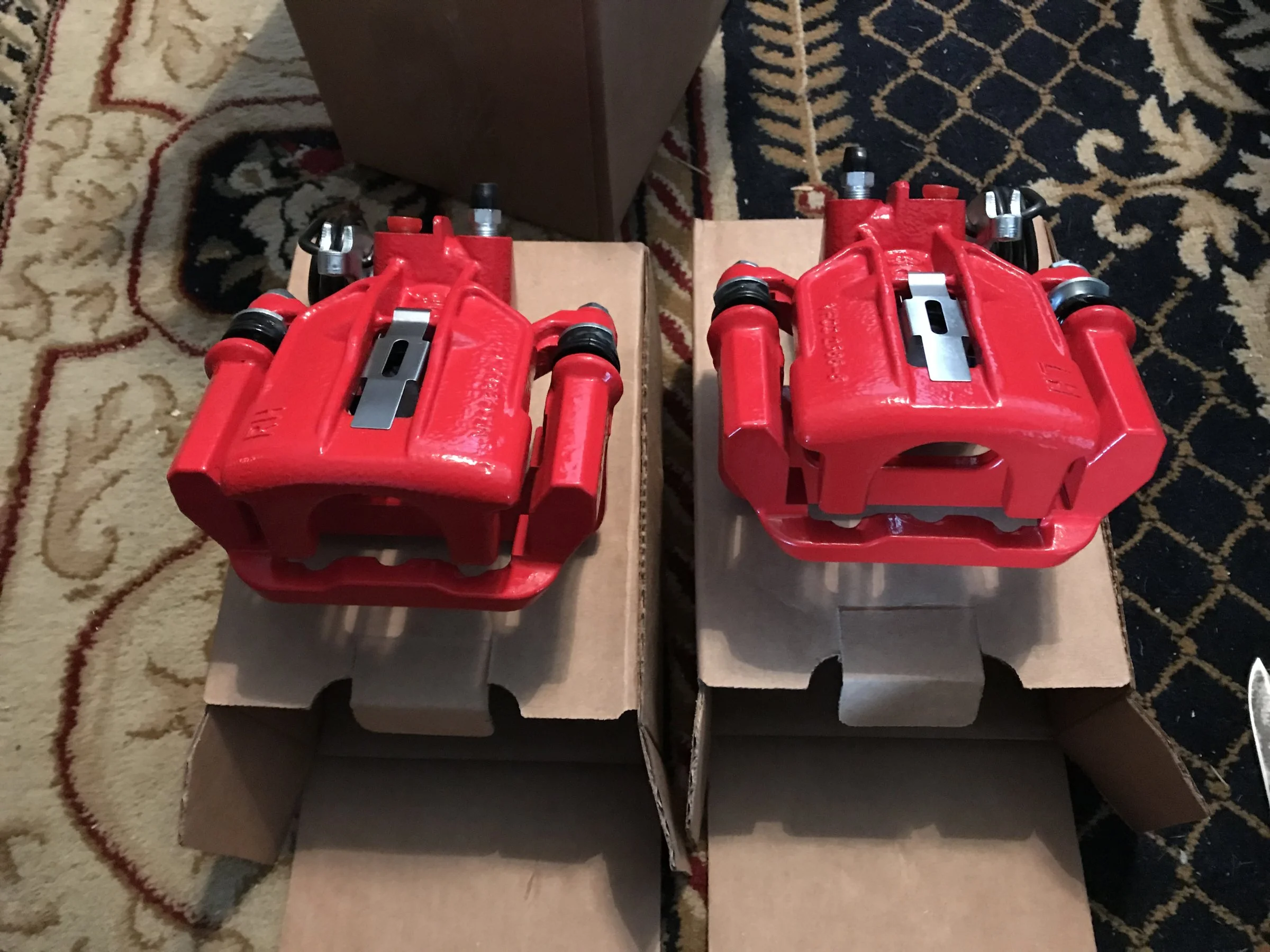

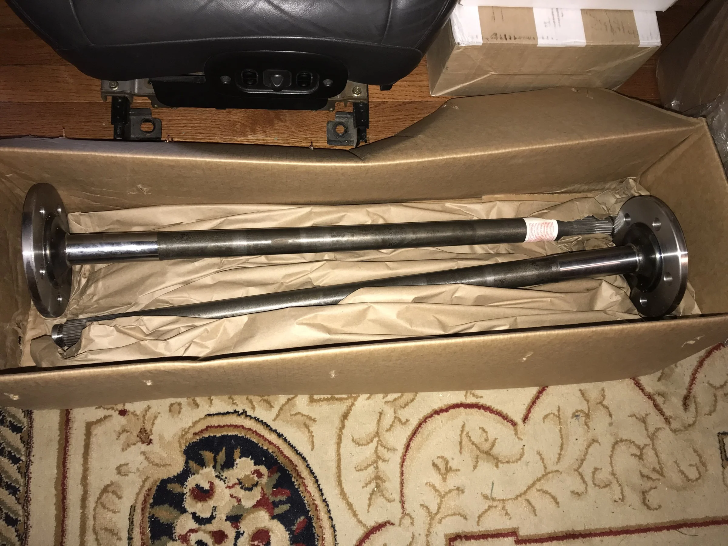

A few more items arrived this week while I was away. The parts pile is growing but I still need a bunch of items to complete the brake swap.
Moser Fox length, 31 spline, SN-95 flange axles
Rear calipers
Drilled and slotted rear cobra rotors
I still need E-brake cables and probably some miscellaneous hardware to complete the rear half. Oh yea, and moan braces and dust shields. Damned elusive moan braces.
Construction crews still haven’t begun the garage so I’m just in a parts collecting mode at this point. I do have a sweet rectangular patch of dirt with a driveway leading up to it though. Lol
Reactions: Mustang5L5, General karthief and RaggedGT

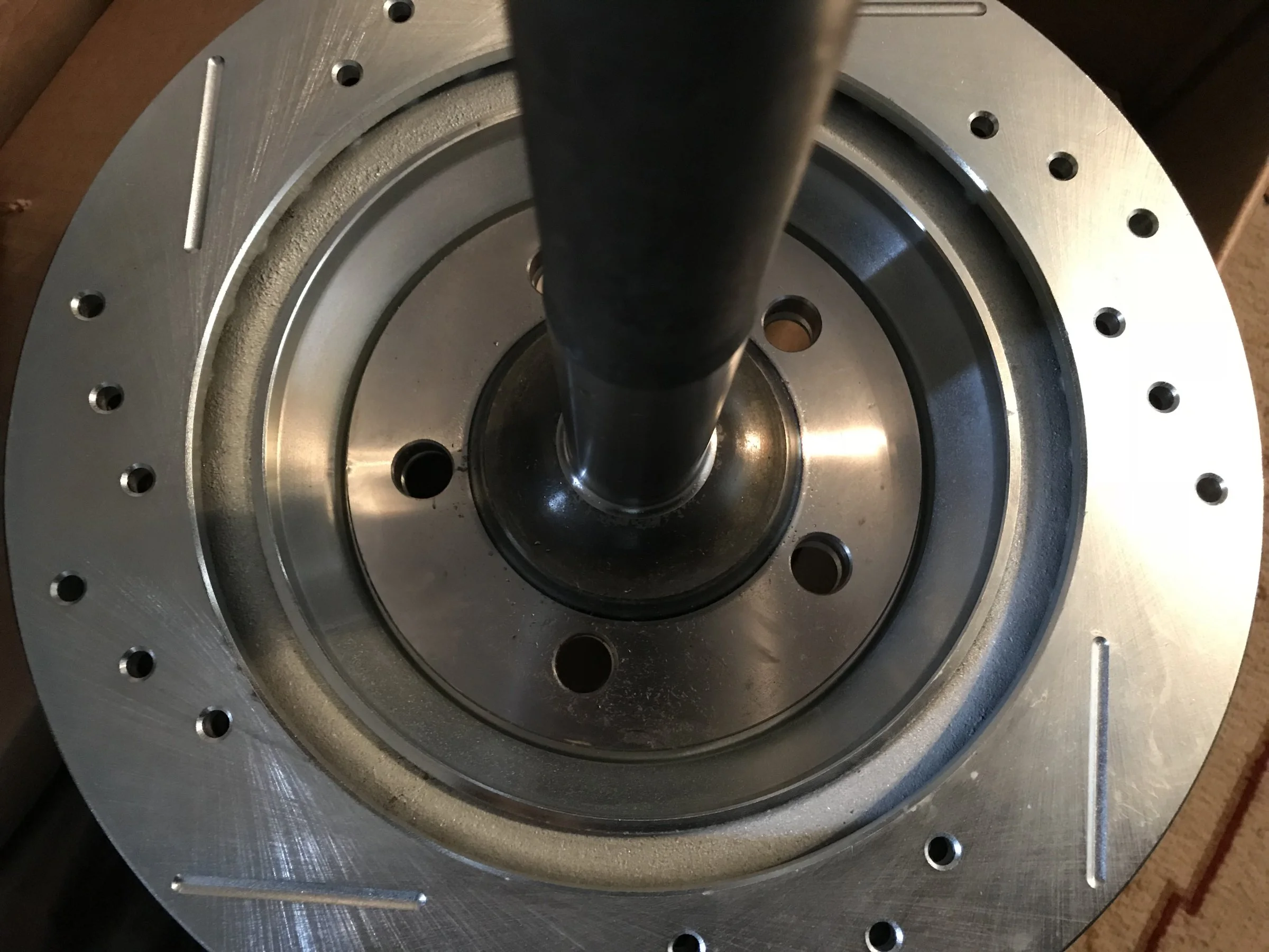

curious why SN95 axles?

karthief said:
You could post non-progress garage pics.
Page 2 has the pics of the excavation and gravel. That’s all the garage progress that’s happened on that end.
Uh oh. I thought I needed the SN-95 flange to properly fit the rotors?? You got me nervous now. I’m about to check the fitment right now.

#54
  • Nov 12, 2017
  • #54
Your fine. They are fox lenght, and the flange will work with the rotors

Nov 12, 2017
#55
  • Nov 12, 2017
  • #55
Ok. Crisis averted. Lol. Through my research, I had read that Fox flanges were a hair too big for the inside of the ‘99+ rear rotors, so I just automatically ordered the axles with the SN-95 flange thinking that’s what I needed for these rotors to fit properly. There’s several threads stating that folks needed the inside of the rotors machined out to accommodate Fox flanges.
These axles are Fox length, just a slightly smaller flange in order to accommodate the later year rotors. Fit is perfect. Forgot I need lugs as well.
