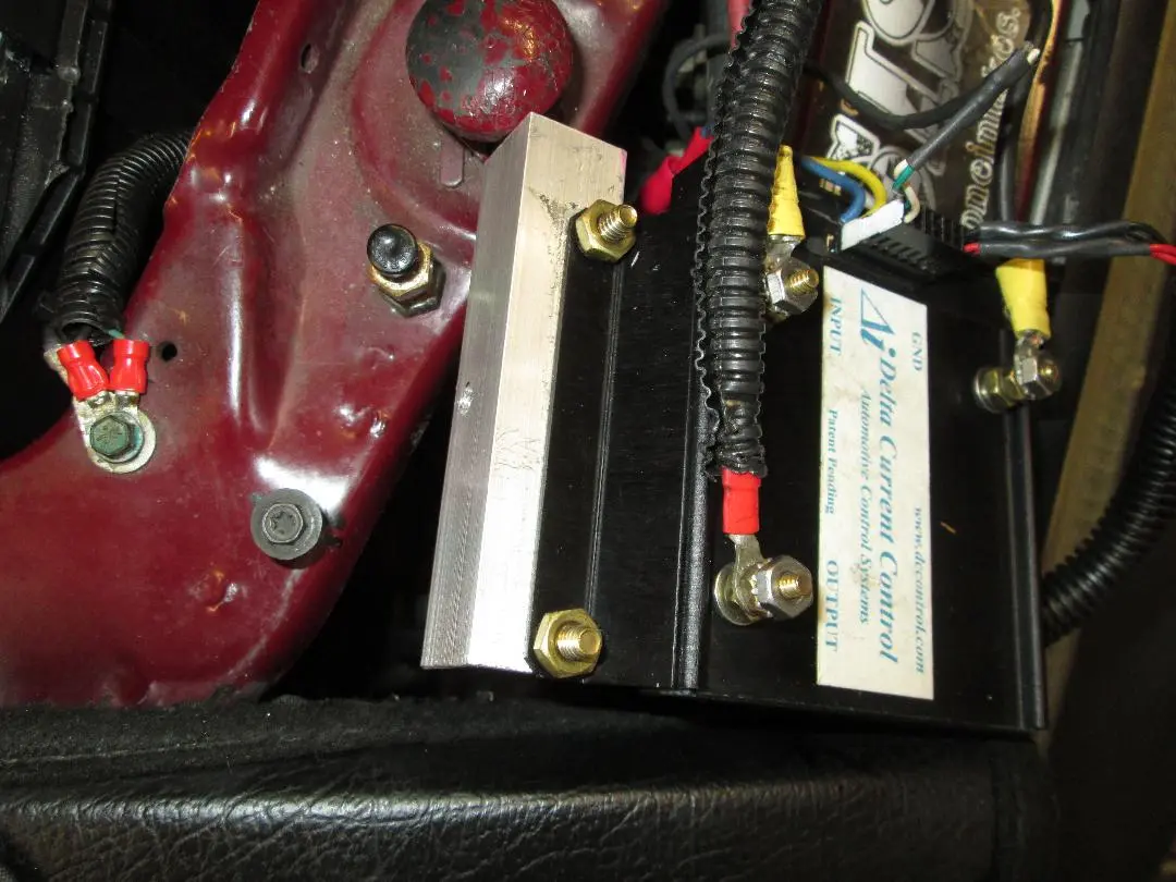

Mine gets no air flow but is heat sinked to the core support behind the headlamp assy. Picture shows the 1 screw mounting, unmounted so you can see it.
