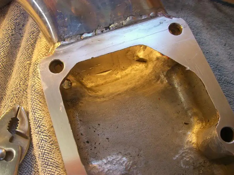

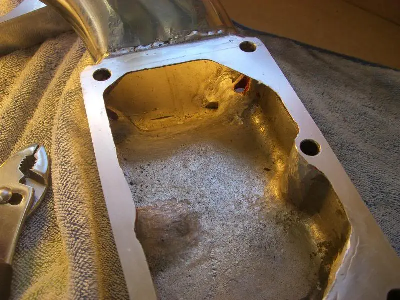

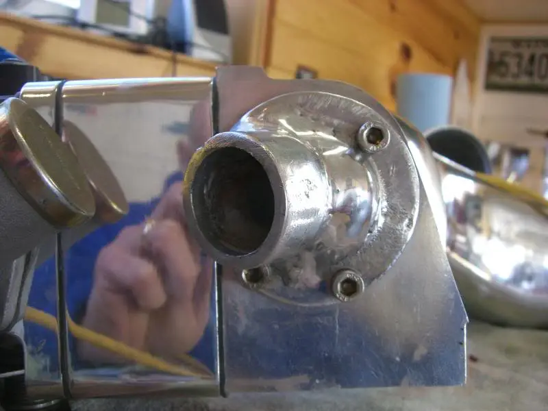

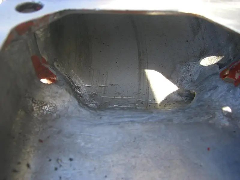

Since my manifolds are off I thought I would take some pics of the inside of the inside of intake where the 3" pipe was welded. When I did this project the first time I never got pics of these transitions.
Here is the inside of the discharge side going into the GT-40 lower manifold.

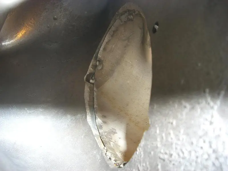

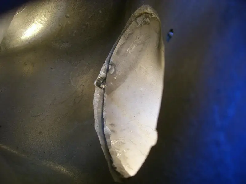

Here is the bypass flange that I cut and rewelded backwards to fit in that very tight spot.
Here is the piece of angle I cut out of the original KB bypass flange.

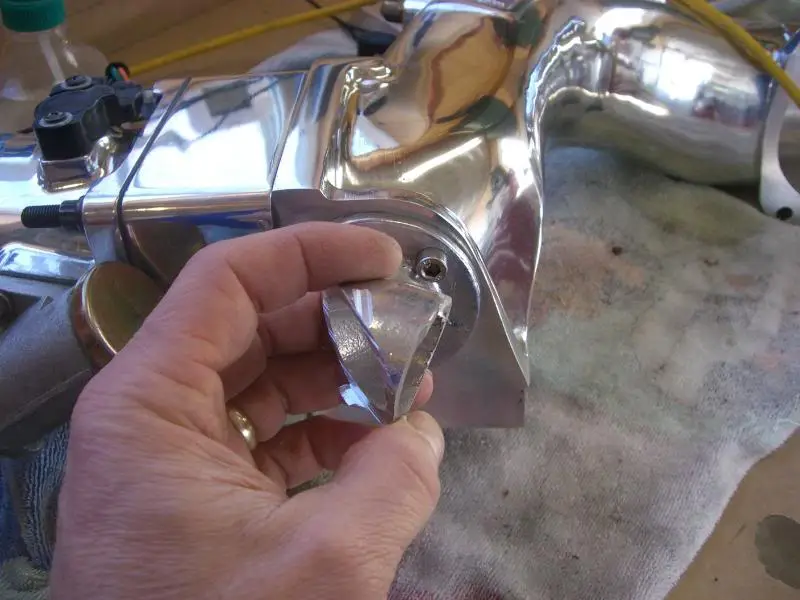

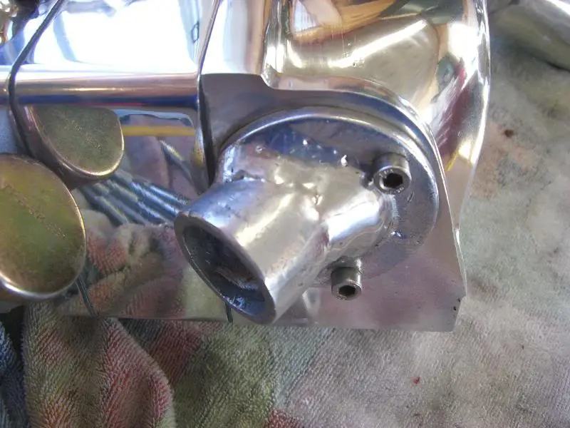

Inside of the drivers side manifold to pipe transition. After the welding I did alot of blending and grinding to make the transition smooth.
