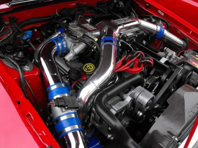

DIY air to air intercooler on Kenne Bell for 92 LX

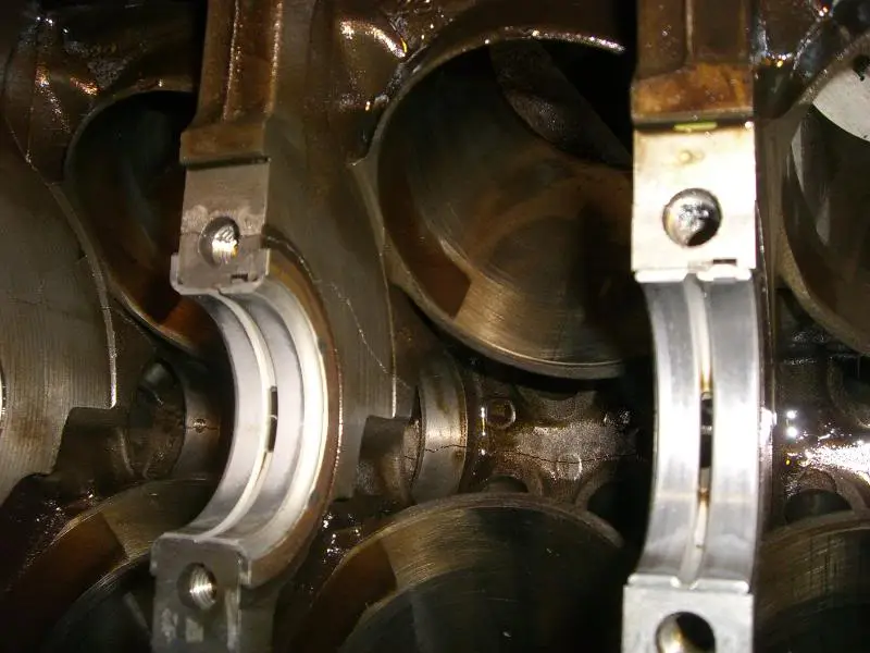

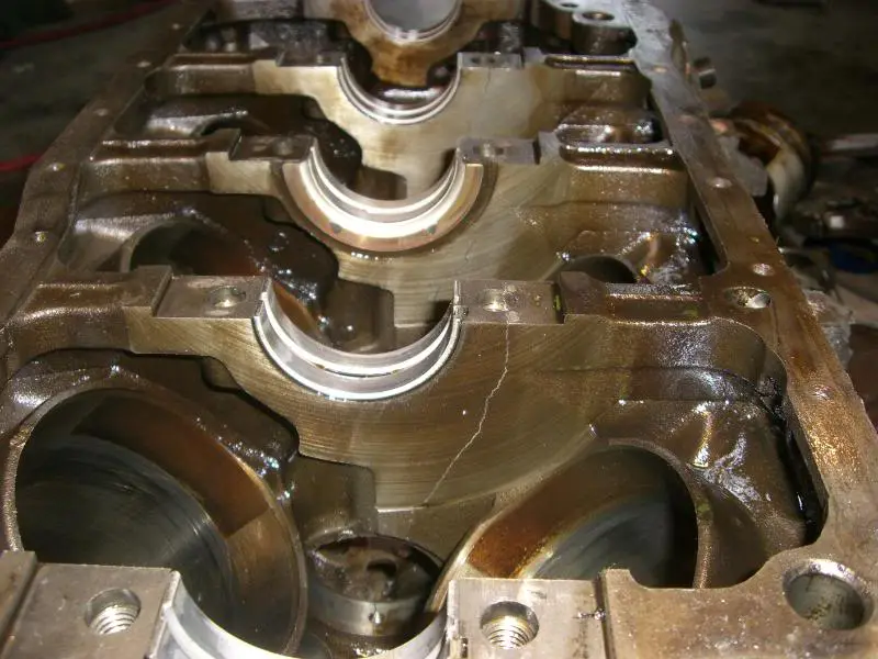

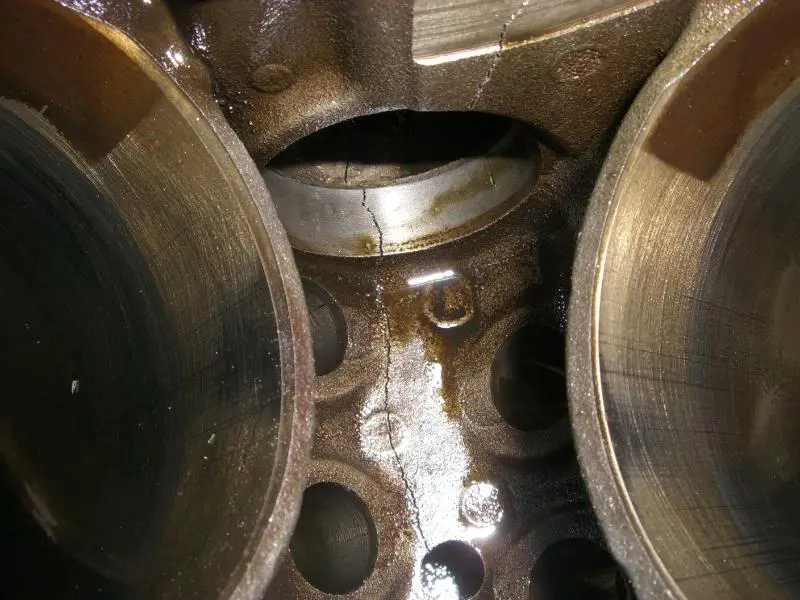

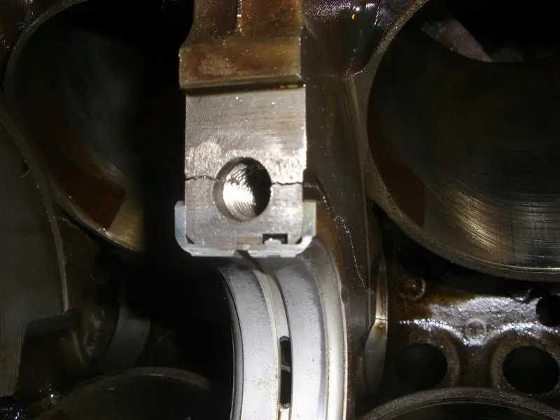

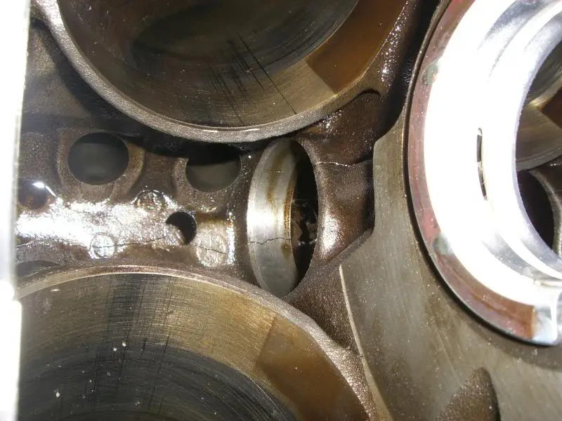

Cracked up......Well in the end the added power from the additional 3 psi pushed the block past its limits. Last fall the dyno at 14 psi put out 431 hp and 524 tq and with 17 psi this spring who know, but it was too much to bear for the stock block. My brother and I pulled the motor today and upon disassembly of the block, the crank main caps came off showing severe scoring on the bearing surface right down to copper color. After pulling the crank and cam you could see she was split right down the middle from the top of the lifter valley down to the main webs from end to end. I had a hard time to get the cam out as the middle of the block had distorted and crushed the center cam bearings. Funny that I drove it like this for 3 days :eek:, the groaning sound must have been the crushed cam bearing. Well I'm glad I'm going Dart block with forged internals. I feel justified and well almost as if I've earned it now:salute:.

JJ its important for the A2A build to have feedback as far as the tunning aspect goes. If you could post on the corral and here how the car drives with the A2A and how hard it was to tune. Maybe a comparison from what it felt like stock to A2A from a drive ability stand point as well.
The tune for my A2A was easy for TJ at Baker Engineering. The car is a blast to drive I bought the Kennedy Bell and converted to the A2A so I do not no what the the car would have drove like with just the standard Kenne Bell.
