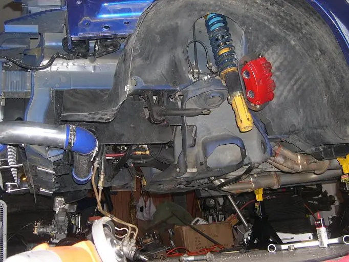

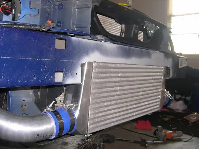

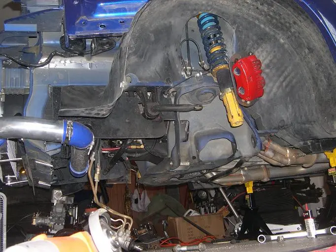

I started this project last weekend, but didn't really get to doing anything until yesterday and today, so heres what I got so far!
Up on jack stands ready to go
What it looked like before.
Bumper cover removed/piping removed.
Bumper off and cut.
Mocking up the IC to bumper for mounting holes.
IC and bumper remounted.
Mocked plumbing from blower to IC.
Mocked pluming IC to engine bay.
Going into the engine bay/BPV pipe.
Relocated rear coolant expansion tank mount for more room routing the SC->IC pipes.
Engine bay now.
Everything is done as far as plumbing is concerned; now, all thats left to be done is take everything apart (actually I already did that lol), tighten the blower screws, debur and wash the pipes, then reassemble.
I got everything on ebay, siliconeintakes.com (amazing job, got my couplers overnight), and local hardware store.
http://stores.ebay.com/Just-Intercoolers Nice pipe+clamp+coupler kits for little coin.
I test fitted the bumper on earlier, fits like a glove (a snug glove ). I had to remove the fog lights because the GT bumper is so damn narrow and short. For instance, the inside bottom of the bumper is flush with the bottom of the IC, but because of our "tippy nosed" design there is about 1.5" of core below the fascia. Also I trimmed the foam crash bumper into a concave shape so it won't overlap the IC, but act as a shroud and force air into it. I'm probably going to add two pieces of aluminum stock to the bottom of the IC also, and just rivet them onto the core support so it'll be all stout and w/not.
If anybody wants more detailed info, or particular pics just let me know and I'll post em up. :SNSign:

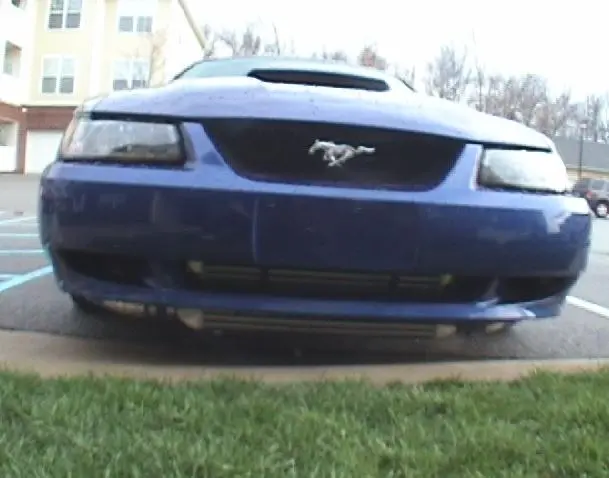

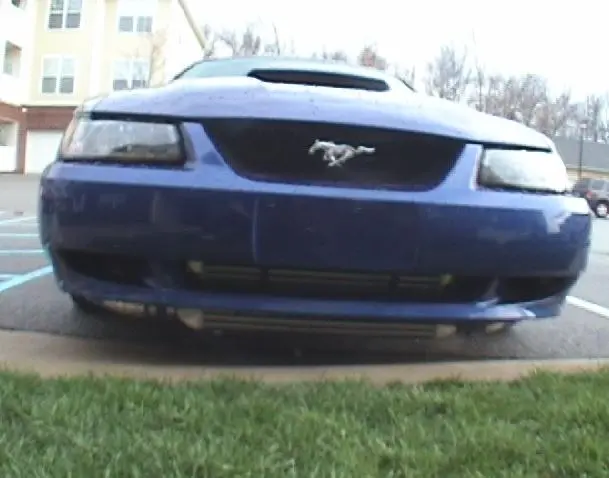

Heres a crappy pic form my video camera. As you can see it sits low I'm probably going to be attaching it to either the core support and get rid of the crash bumper all together, or cut the crash bumper more and mount it to that. I still haven't put the foam back in there, or anything else, but it's running great aside from some minor tuning issues that need to be worked out.

damn, i thought mine was low. you need a chin spoiler or move that baby up!
I think I'm just gonna move it up. It's mounted in the bottom face of the top square section of the bumper currently.

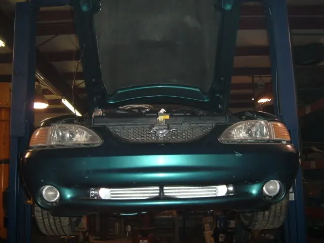

wow you need to move that thing up.. i removed the entire center section of my crash bumper and mounted the "ends" from the mounts out back in. Works like a charm and is tucked up nice. My intercooler is a 32x12x3".
here's a few pics for ya..

You dont have to move the AC lines. I had to move mine for my Turbo piping to actually fit.. with your setup, you should just be able to mount the top of it to the headlight / bumper reinforcement panel, then make 2 brackets to support the lower portion of the IC to the radiator core support. Then maybe do a shortening of a pipe or 2 and its raised up. the only lines i dont have on my car is the "tube" power steering cooler b/c its pointless IMO and i'm going to be running a small Tube and fin setup anyways...

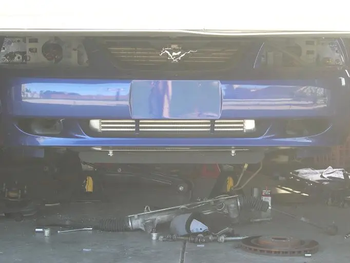

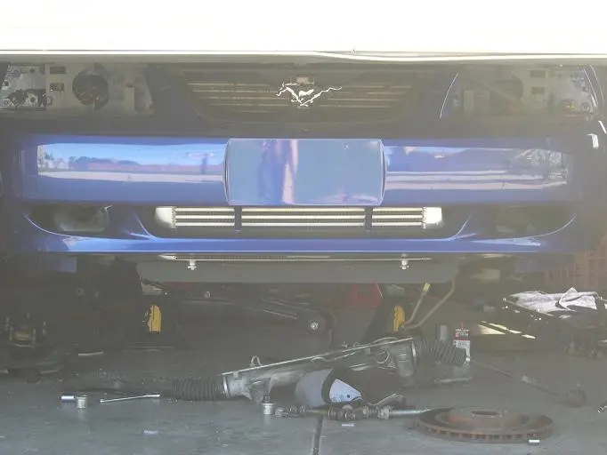

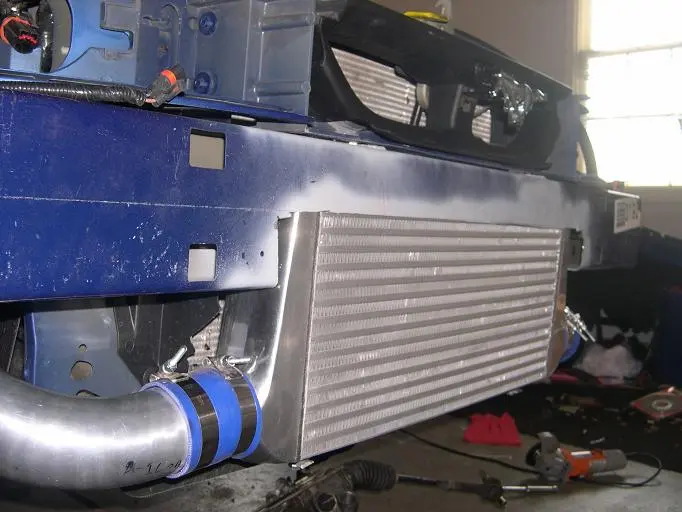

Little update! Since the car has been down for ~cough~ other ~cough~ modifications...I decided to remount the intercooler today. I had to notch the bumper a bit more, and I decided to cut it into an "L" shape - then at the top I welded on some thick steel stock to bolt the IC to.
PICS:
Intercooler remounted!
with the bumper on, now its not the lowest part of the car!
And a little teaser...prepping the front end for rebuild (back end is getting a jorb, too )
