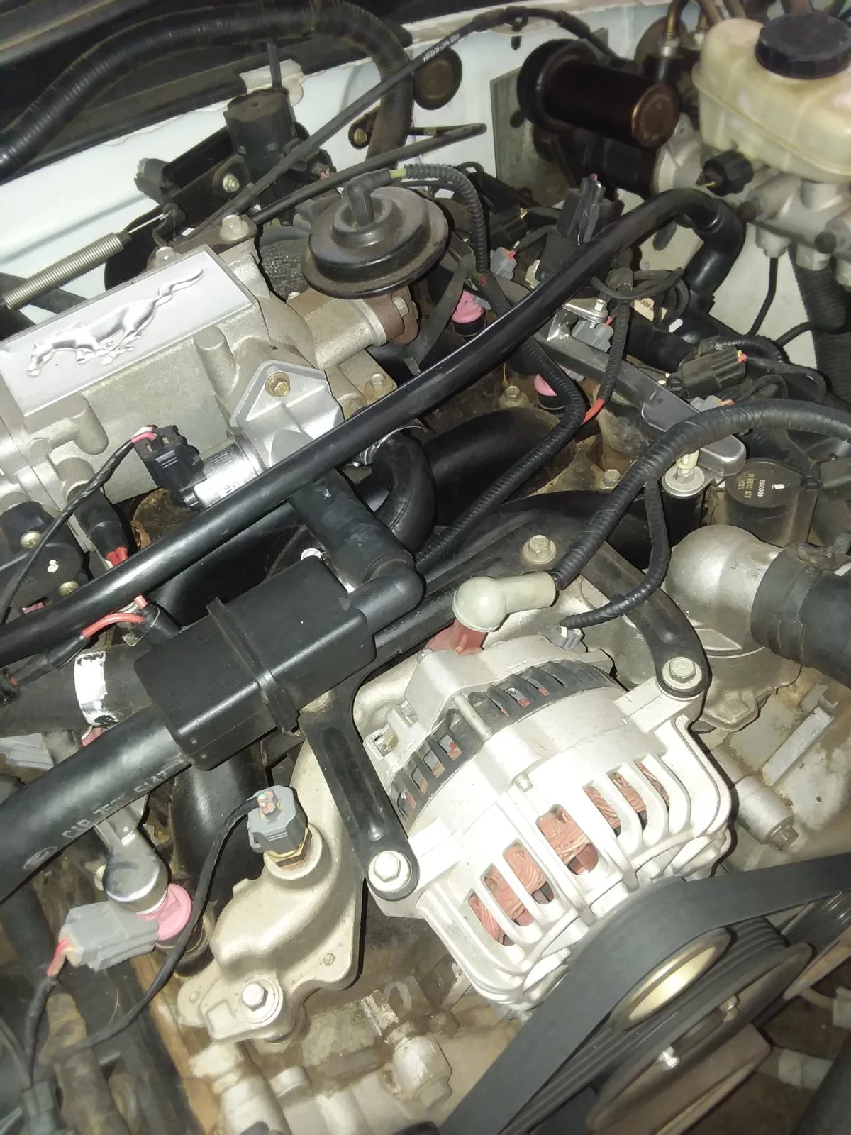

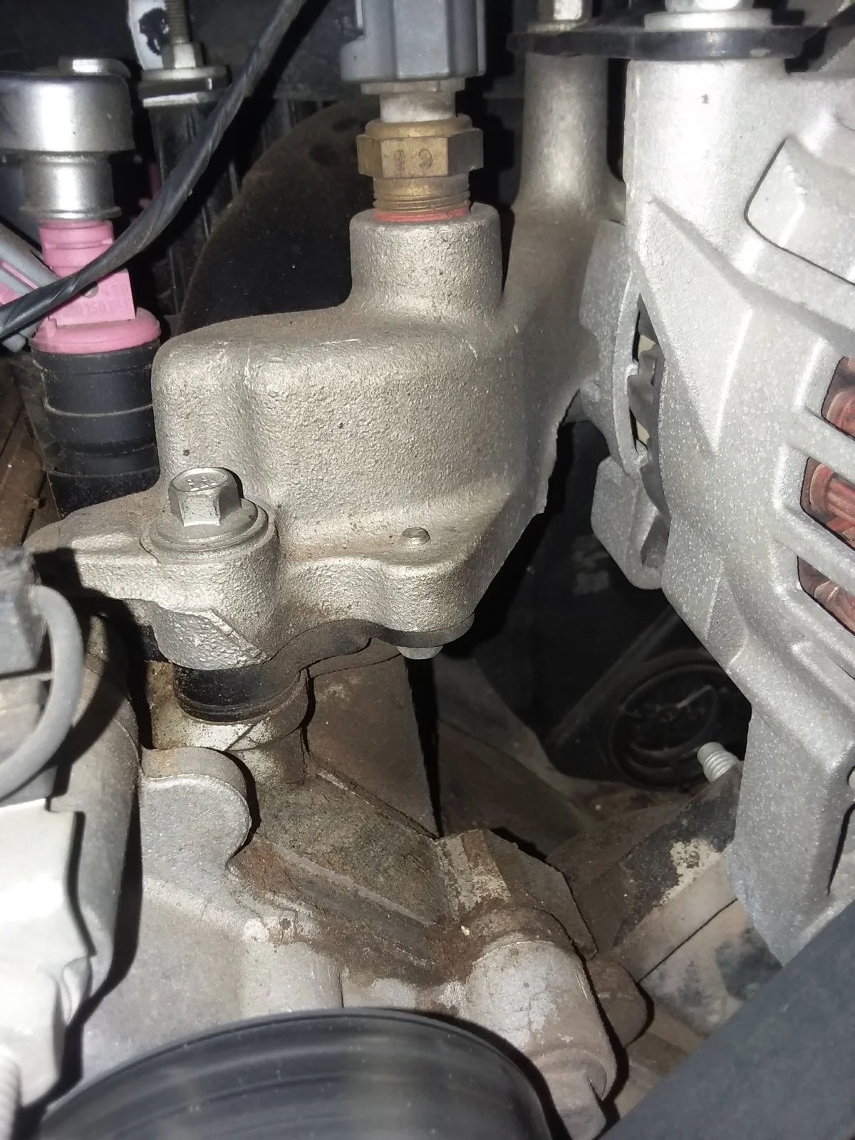

Do I have the upgraded intake manifold?
I come from fox bodies, so I'm new to the 4.6. I'm wondering if my 04 has the upgraded manifold? Under load on the freeway it gets a little bit of shaking like its motor mounts, but it seems solid at idle, any ideas what it could be? Heres some photos of my manifold. Thanks

I don't believe they used plastic ones in 04 still (should have been changed by 99-00), but either way, that has the aluminum crossover, which was the main change between the older and newer ones (the old ones are fully plastic).

Looks like the stock 04 manifold. The 04 manifold is the best PI manifold. No reason to upgrade unless you start making major modifications.
