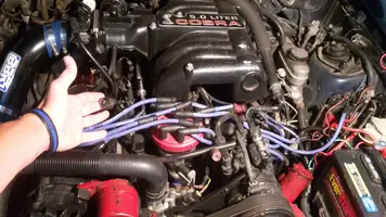

Hello everyone, im new to this site and looking forward to some great info. I have a 89 Mustang Gt, 5spd. Just got the car a couple weeks ago and it feels way way under powered for what it has in it. The guy told me he never had it tuned since he built it, but the MAF/injectors/throttle body were bought together to match. My question is where should i go from here, im lost on how to get the power out of it. It had a 273 gear, i just put in a 373 which made a difference but not great. Heres what i got, thanks.
All forged roller. 5.0 bored 30 over.
comp cam (unknown which)
push rods
1.7 roller rockers
scat rods
cobra upper/lower intake
trickflow aluminum heads
BBK 75mm throttle body
BBK MAF
30lbs injectors
cold air intake
under drive pullers
MSD 6al
headers, flowmaster exhaust
Ford Racing 373 gear
short throw shifter
Canton 7qt oil pan
what do you guys think. it will barely break the tires going into 2nd. ive owned a 12.8 sec mustang with not even 3/4 of the mods. Also has a bad hanging idle, and it will rev up, i tried the restricting the IAC but it didnt work.

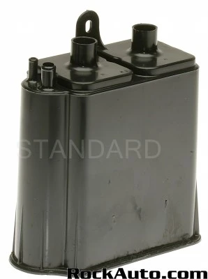

The carbon canister is normally mounted on the passenger side frame rail near the smog pump pulley.
Carbon Canister:

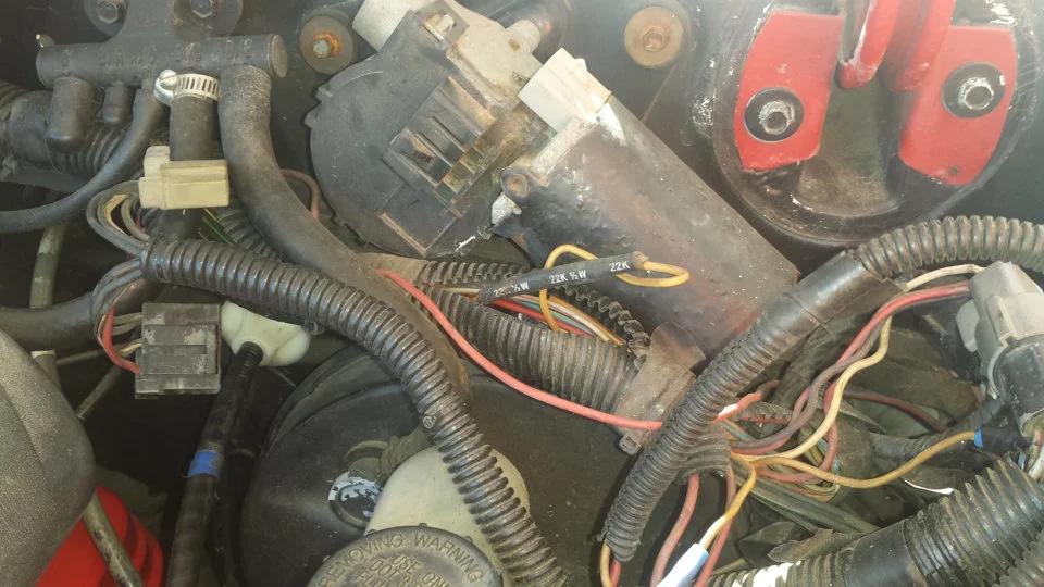

Resistor location: A big thanks to liljoe07 for this information:
Check over by the brake booster. Its not in the harness on the TFI, its on the main part of the harness over by the plugs that connect to the dash harness. About 6" or so from that, going back toward the EEC.
If I remember right, the resistor is covered in a shrink tubing that is sealed to the wires. So, you wont be able see any markings. The shrink tubing is labeled though. It's a 22kohm 1/2 watt resistor.
Here is the location.

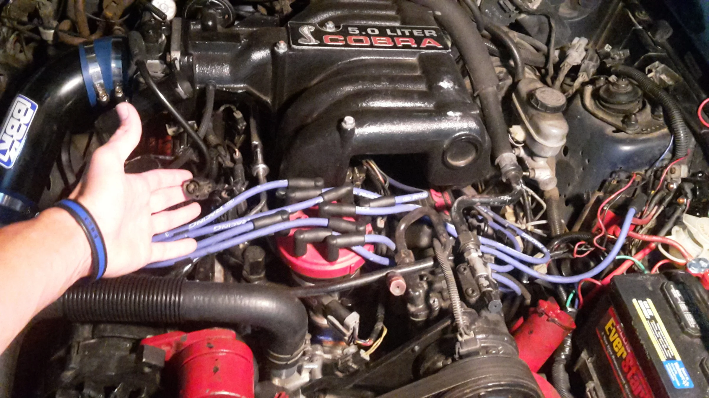

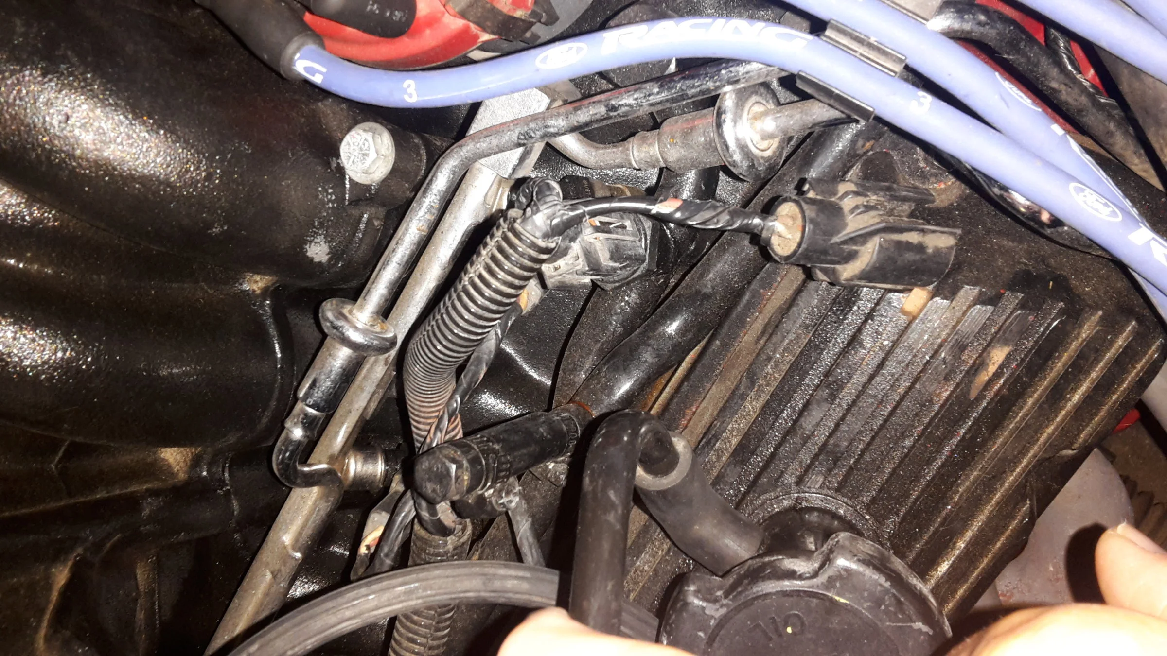

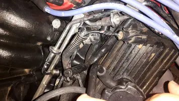

Thank you very much for the reply, one thing I definitely noticed, was the wire near the fuel injector is not plugged in to anything, I took a photo to confirm it. I'll run the car tomorrow and do the test again

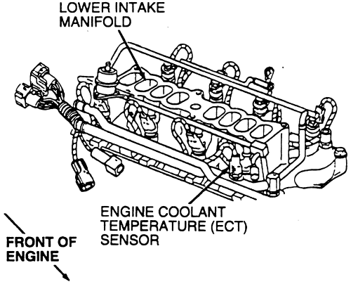

That is the connector for the ECT. Big no no if it is not connected. Look at the hard coolant line in the lower intake to the left of the distributor. That is where the ECT sensor should be installed and the connector goes on that. That explains your code 21.
@mikestang63 , am I missing something, I dont see where it needs to plug in, is it possibly where that hose block off is, is it justin missing the sensor completley? thanks
The mystery connector is why you got a code 85...Evap solenoid missing..one of the other pictures shows it dangling for the harness...
You can clearly see the ECT sensor in the heater tube on the same photo...
