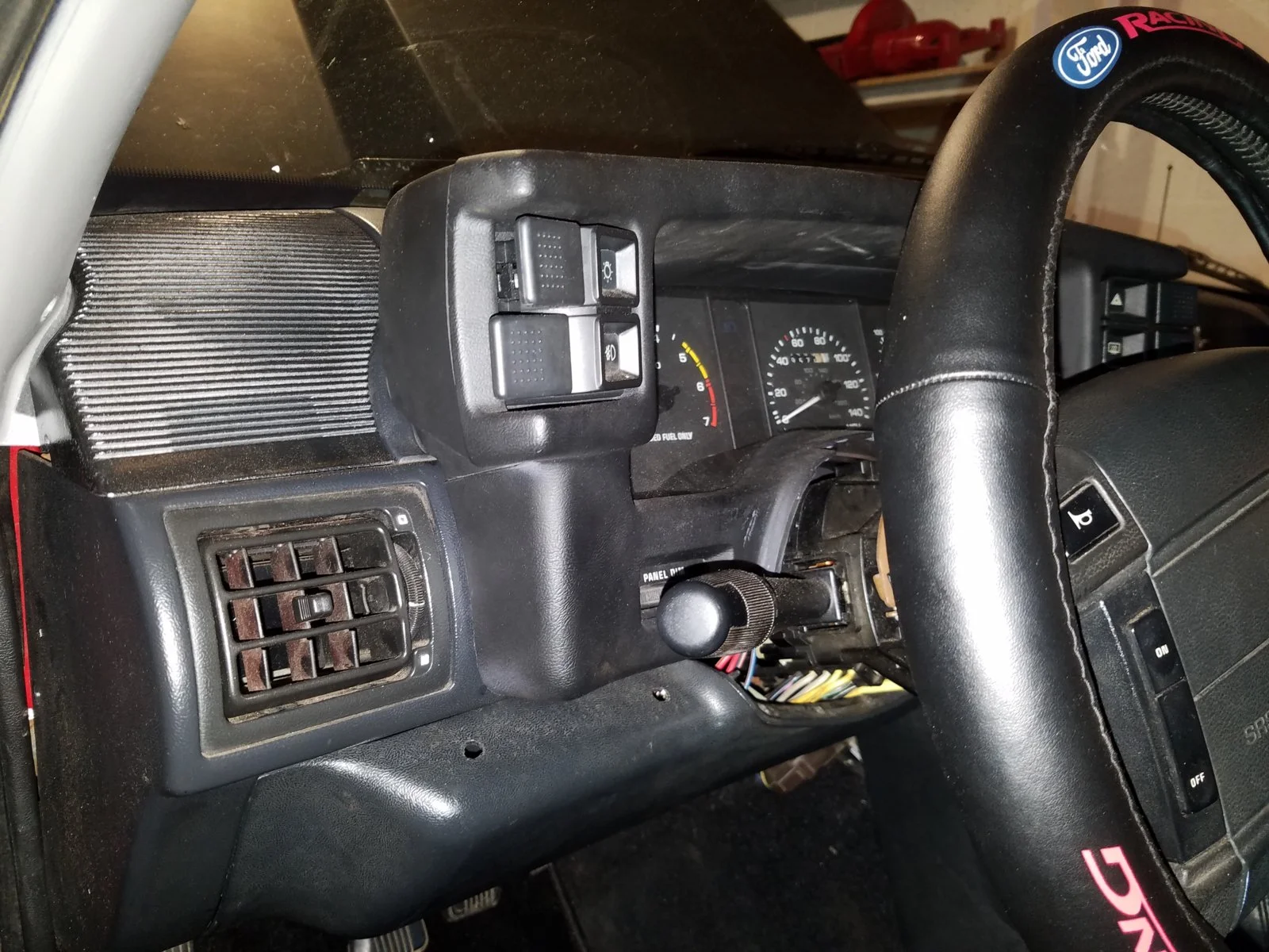

Fox Does this look normal? Also what are these 2 connections?

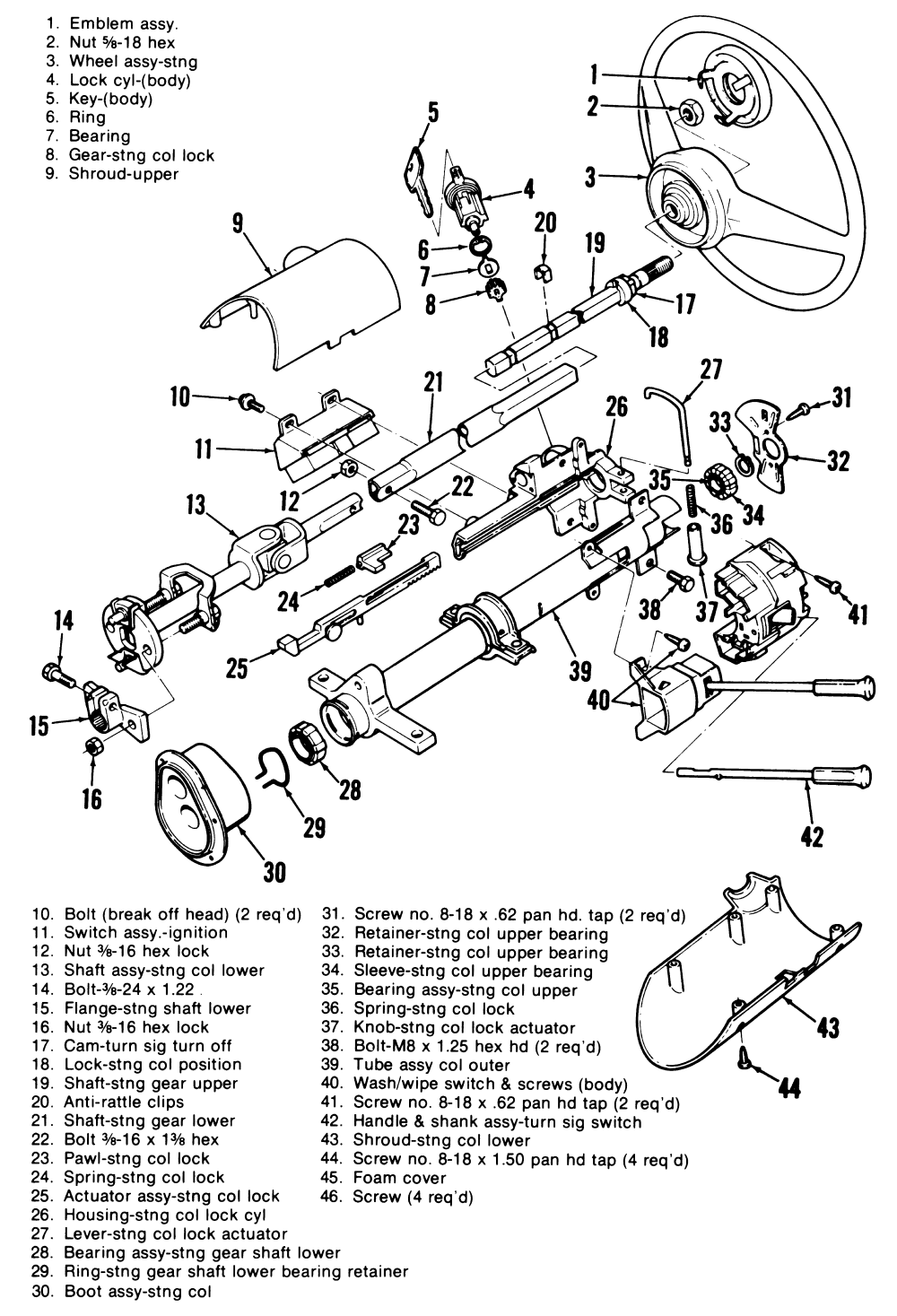

The harness hanging in the second picture is the shift lock actuator and here's a pic of the steering column trim out of a 93. You have the 90-93 steering wheel, and cluster surround so I would think the column trim would fit.

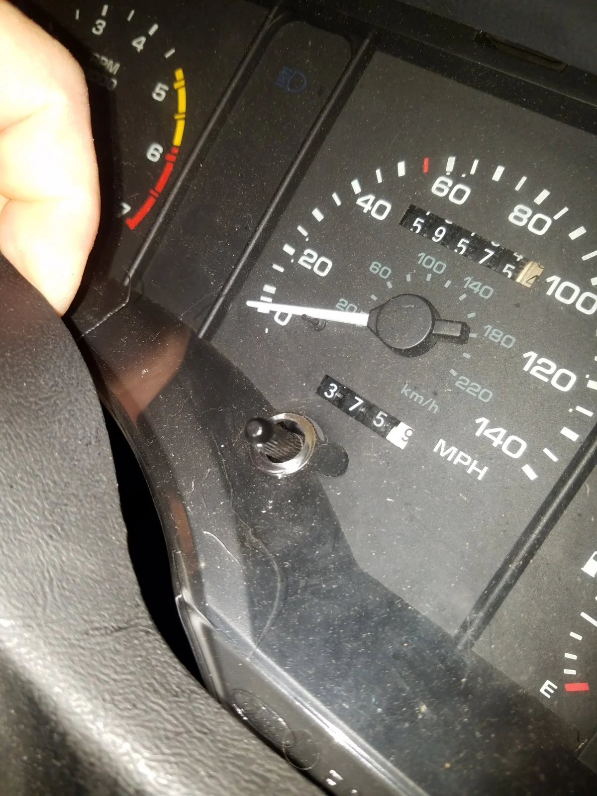

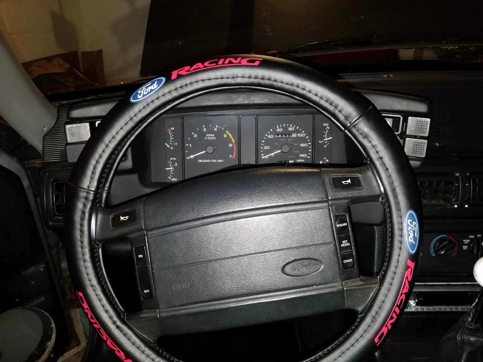

If your gauge cluster is flat across the bottom it is the wrong one. The 87-89 are flat on the bottom. The 90-93 are rounded due to the airbag steering wheel. I bet yours is flat and that's what is causing this issue. Other than the bottom the clusters look the same. The top picture is an 87-89 cluster. The bottom is a 90-93.
Just checked
I am a little lost here...

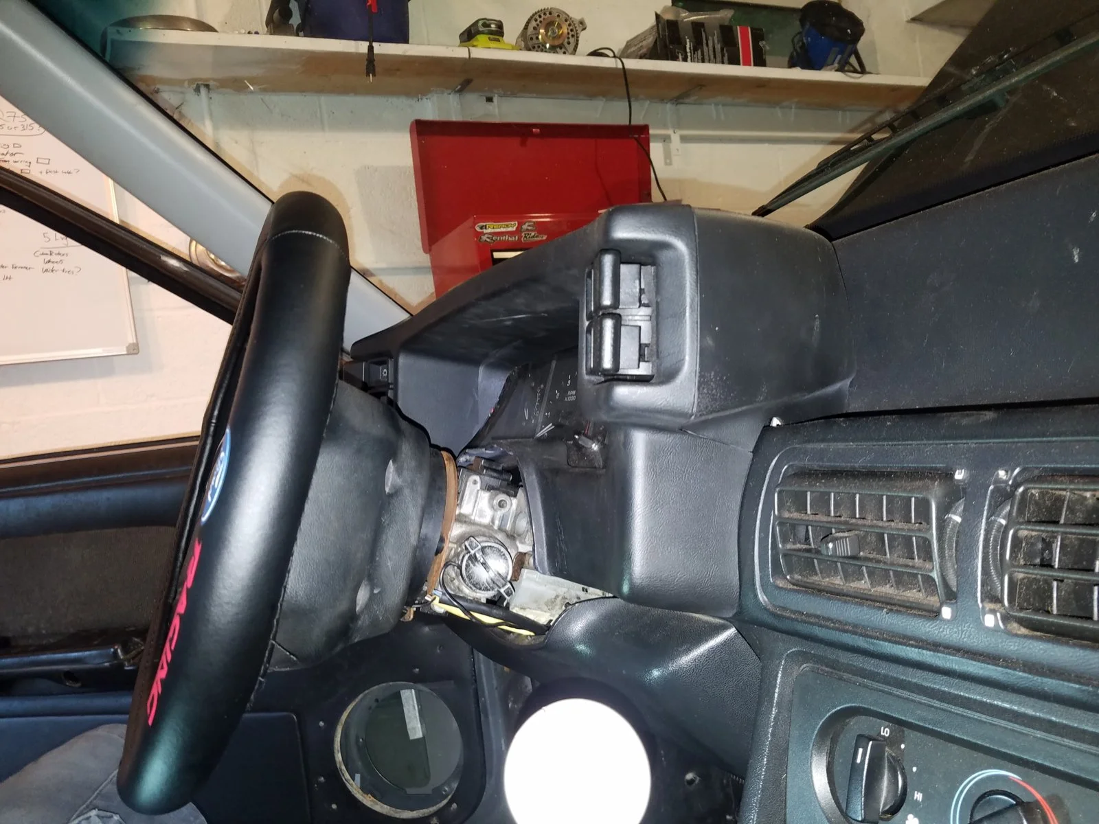

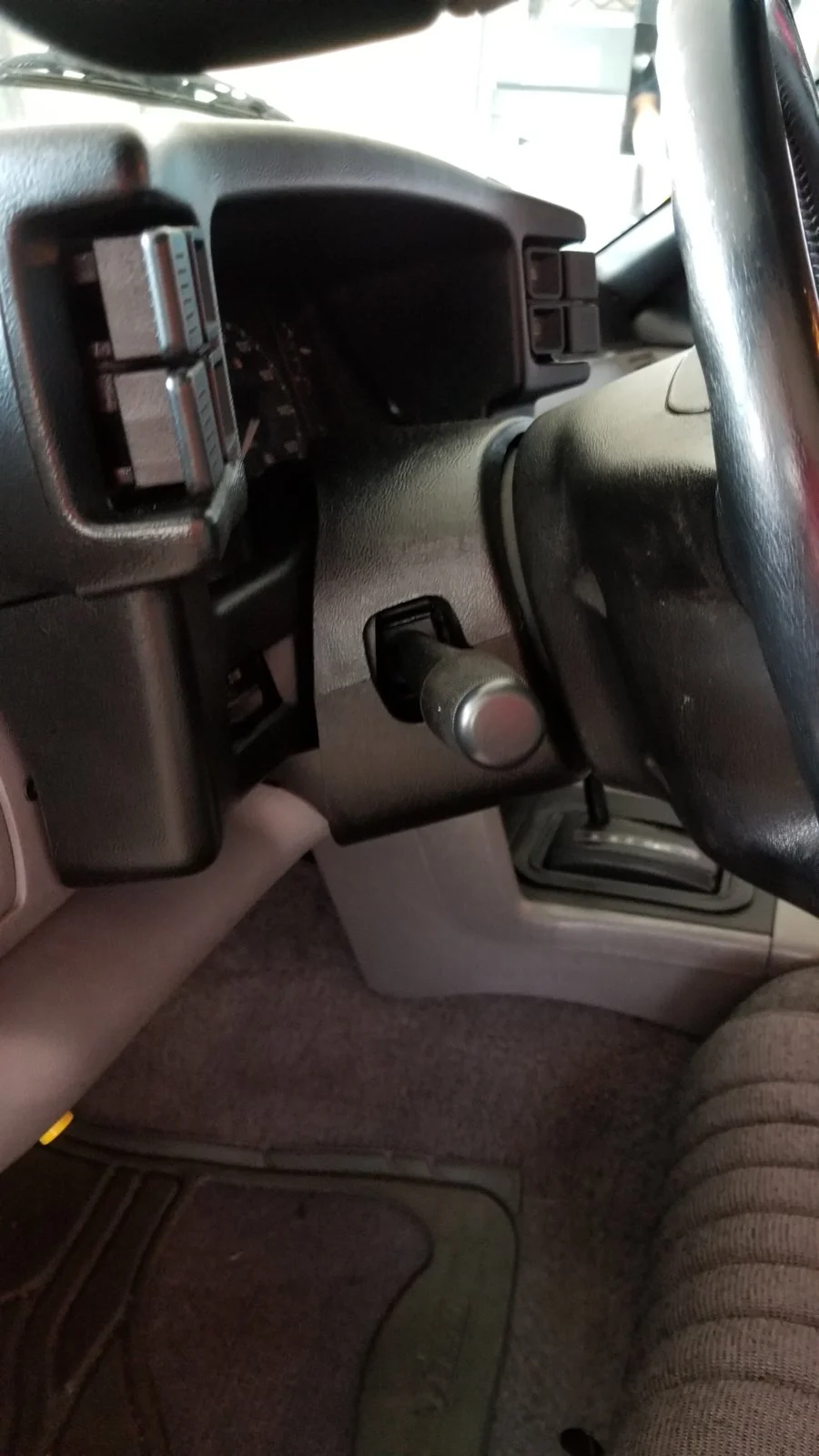

It looks like you have before pictures and everything is together? If it was together before, it should go back together now if you haven’t changed anything.
The pics where it's on, I forced it together and it's tight against the ignition. If I drive with it on and I turn the wheel it shuts off the engine. But I realize now compared to other pics I see, my turn signal switch is closer to the cluster than others.
