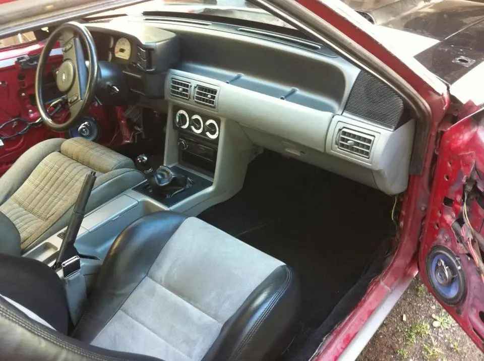

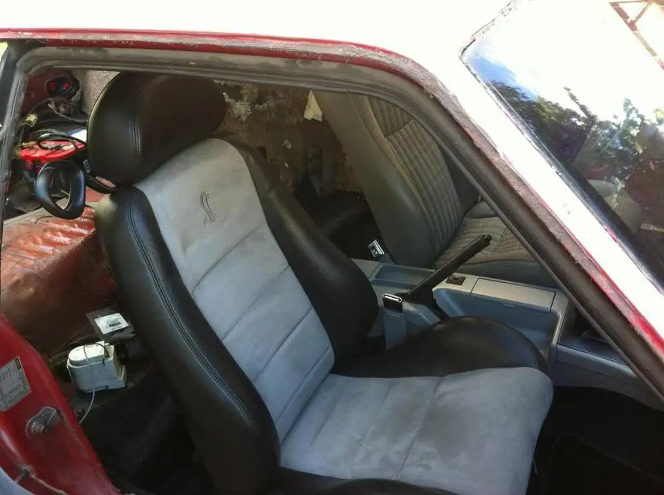

jcgafford - I will be sure to post pics when car is done. With a real camera and not a cell phone
Got the passenger seat in.
