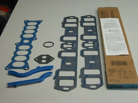

The intake set....Fel-Pro MS93334...this is equal to the 1250 gasket and has the Blue silicone intake seal...plus dizzy o-ring....Discard the old stock upper gasket for MS 95953..its the Cobra U/L gasket...
I used the FMS M6003-A50...complete gasket set made by Fel-Pro...Its nice having EVERY gasket in the motor....I still have a ton of Fox gaskets left over,I runa SN95...The kit works for both...
The MS93334 KIT...
