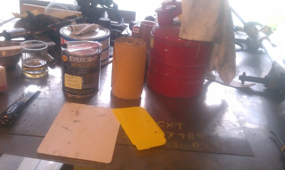

@FoxMustangLvr What gauge metal did you use in your bay? What type of Evercoat did you use? I've heard good things about their Rage product. I'm trying to get all of my supplies ordered
I forget if I bought a 4x4 sheet of 20 or 22 gauge mild steel. There was plenty left over (more than half) but I wanted to have extra to practice welding thin steel which is what I would recommend to you.
Pic below of the Evercoat Metal2metal that I used. See also the first few pages of my build thread for all of my engine bay smoothing if you'd like
https://www.stangnet.com/mustang-fo...obra-irs-swap-_-kenne-bell-twin-screw.878656/
Thanks man! Those pics are definitely helpful. Now that you've made your own panels, do you wish that you had gone with different ones? Do you still like the straight down style? I'm trying to decide between making my own or just going with Scott Rod panels, and also if I want straight down or contoured panels. It looks like the contoured panels give you a little more room in the front of the engine bay, but they have very hard lines that seem to stand out in the bay. I'm leaning towards straight down style panels, but I want to make sure I won't regret it later. Any feedback would be awesome
