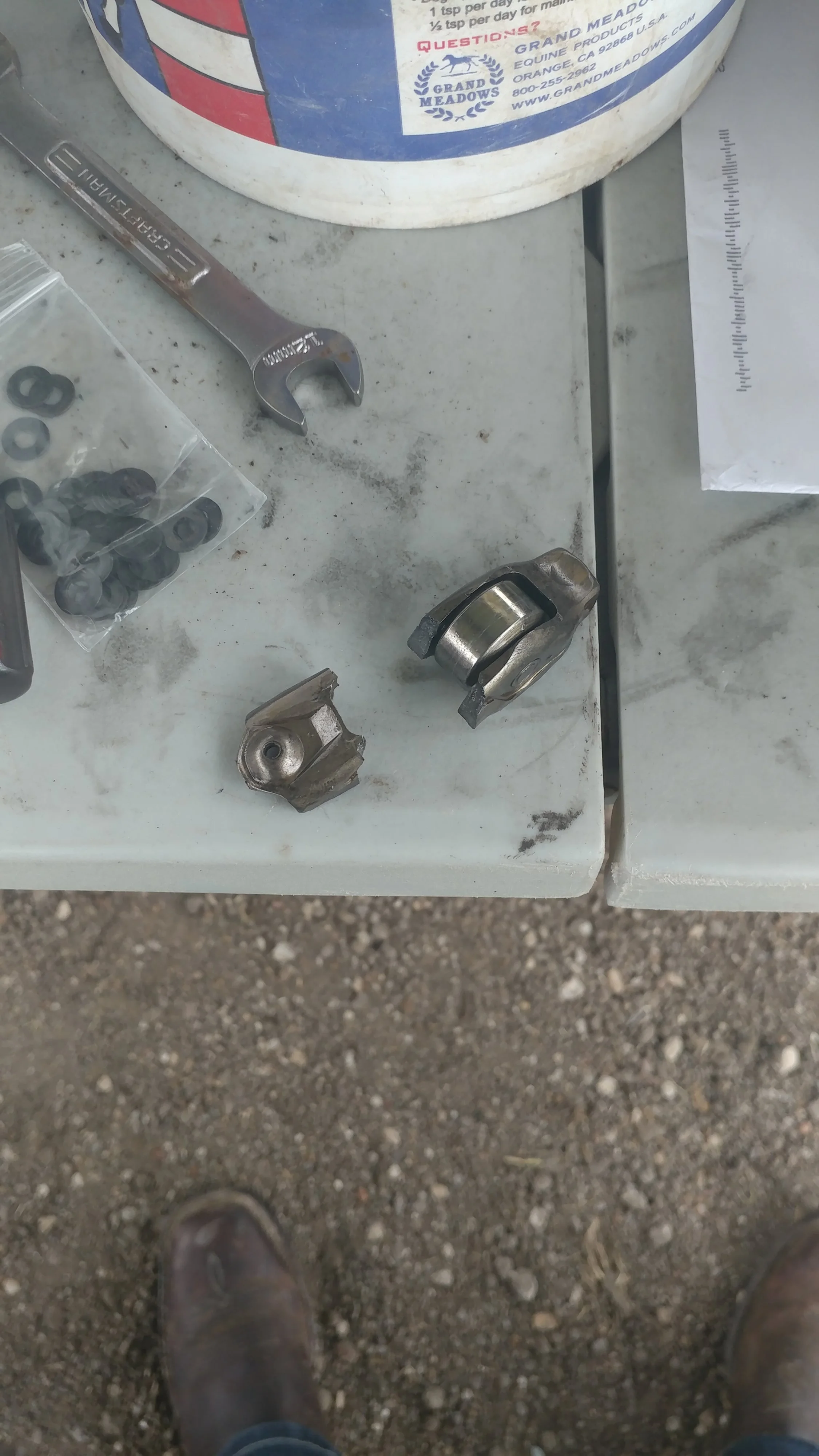

Found out why the car was making noise. Ordered a new set of rocker arms from American Muscle.

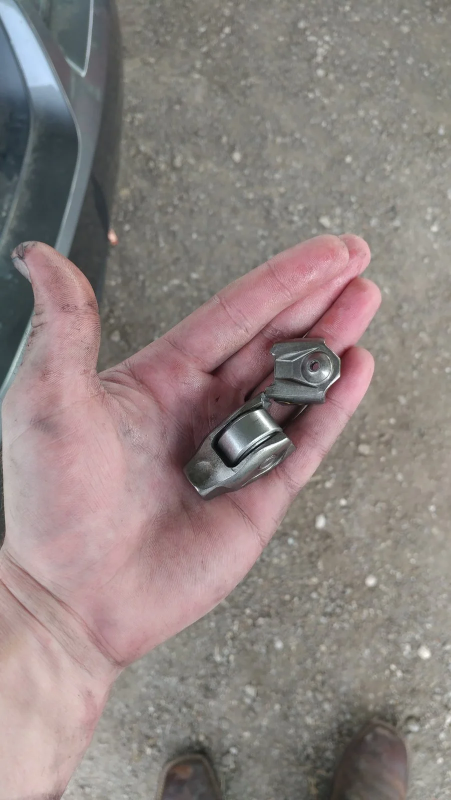

Well the brand new rocker arm snapped on the new valve spring again... Its too strong.

I’m back, and wow! I’ve never seen so many broken rockers before!! Do they make upgraded rockers so you stop breaking them? They are easy to replace. As far as unplugging the maf to being idle down I dunno why it’s doing that I would love to hook my my scan tool and see what the maf sensor readings are at and other sensors.

I bought brand new Melling rocker arms and thought it would be fine as the others are Melling and have not snapped. I ordered this kit from American Muscle. I ordered it before but could not for the life of me figure out how to put them on. I returned them but my friend who is an engine nut said to buy em again and he would help me install them. I didnt find any videos of how to install them on YouTube. I guess I will make a video of how to do it if he can figure it out.

This is turning into a war of attrition. Those rocker you bought are the 05 06 Ford GT Supercar rockers. That's what all the 4v guys seem to use when they cam up the engines. They should be stronger than the standard replacement or the Mellings. Hopefully, you don't have a stuck valve breaking those rockers.
