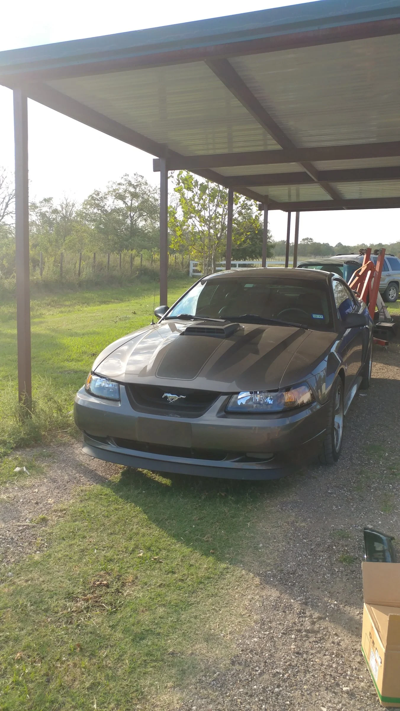

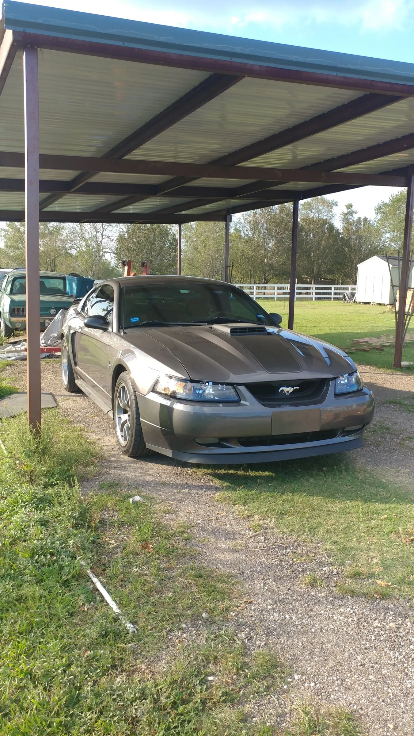

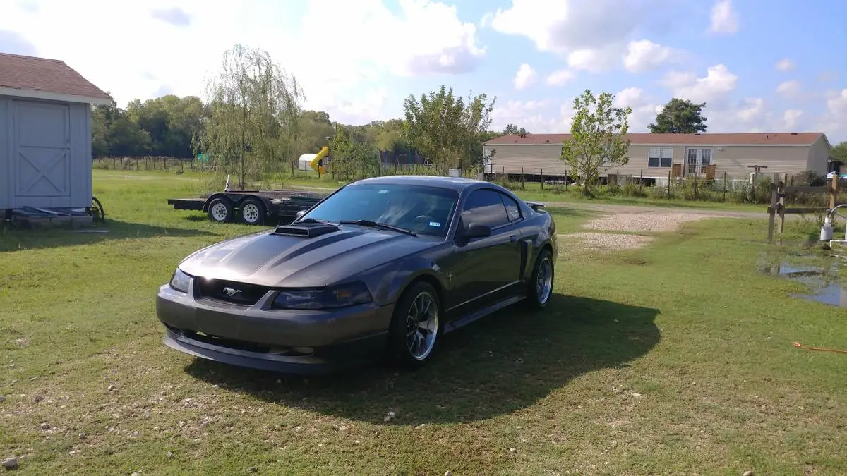

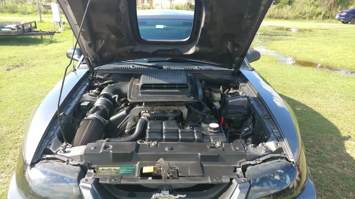

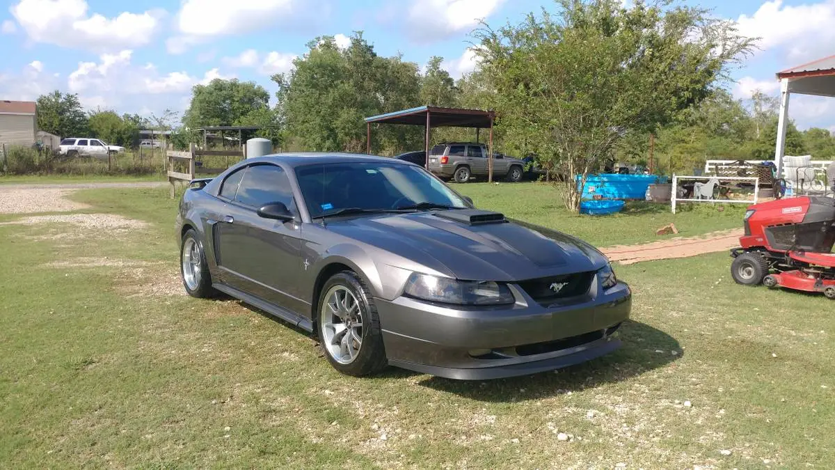

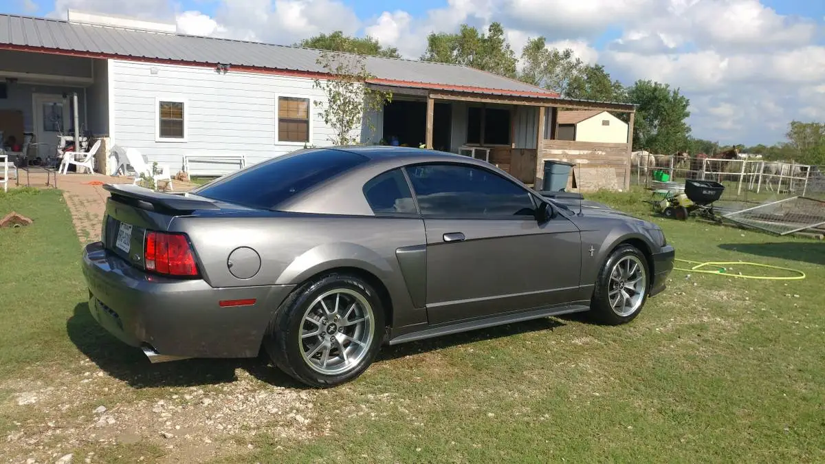

Here are some pics of the car as it sits right now.

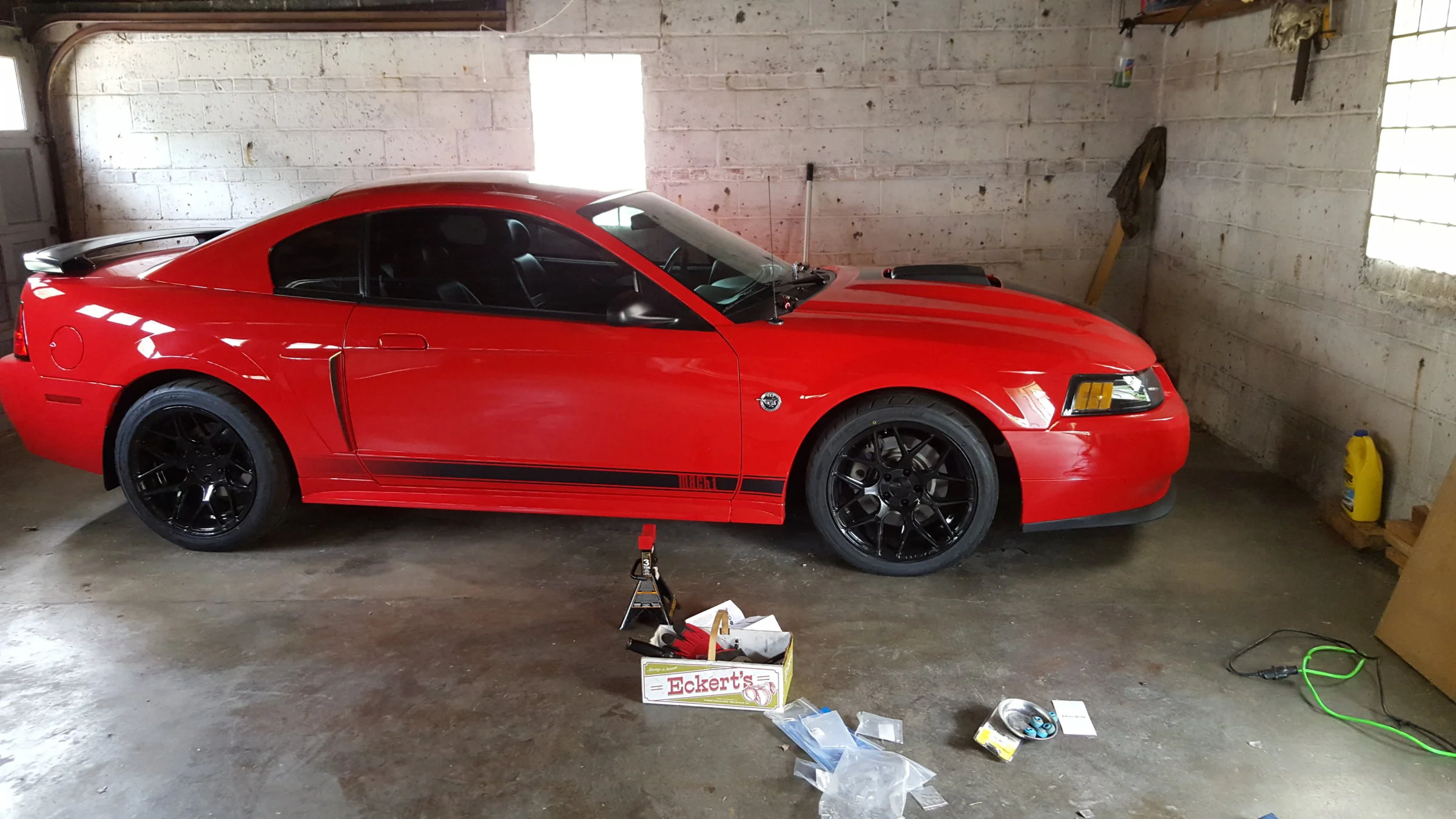

This was mine. I miss it as it was CLEAN.

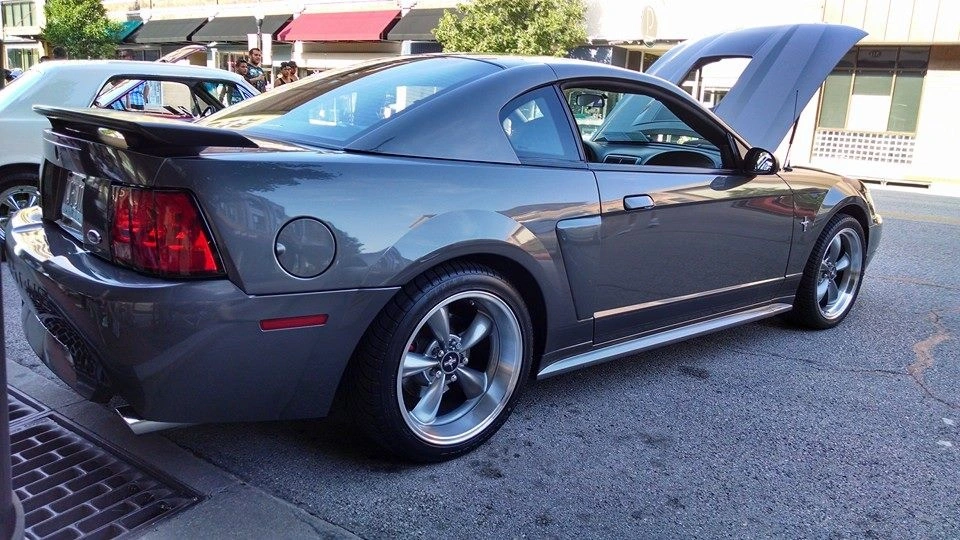

Color me green. I'm jealous of your engine. Wouldn't go with a walbro pump though. They're really made for return style fuel system. Search around and there after plenty of good pumps for a returnless system. Mach 1s are the greatest. Even without terminator power, they're lighter and for some reason do better than people want to believe. Heres mine. 20160503_141323.webp

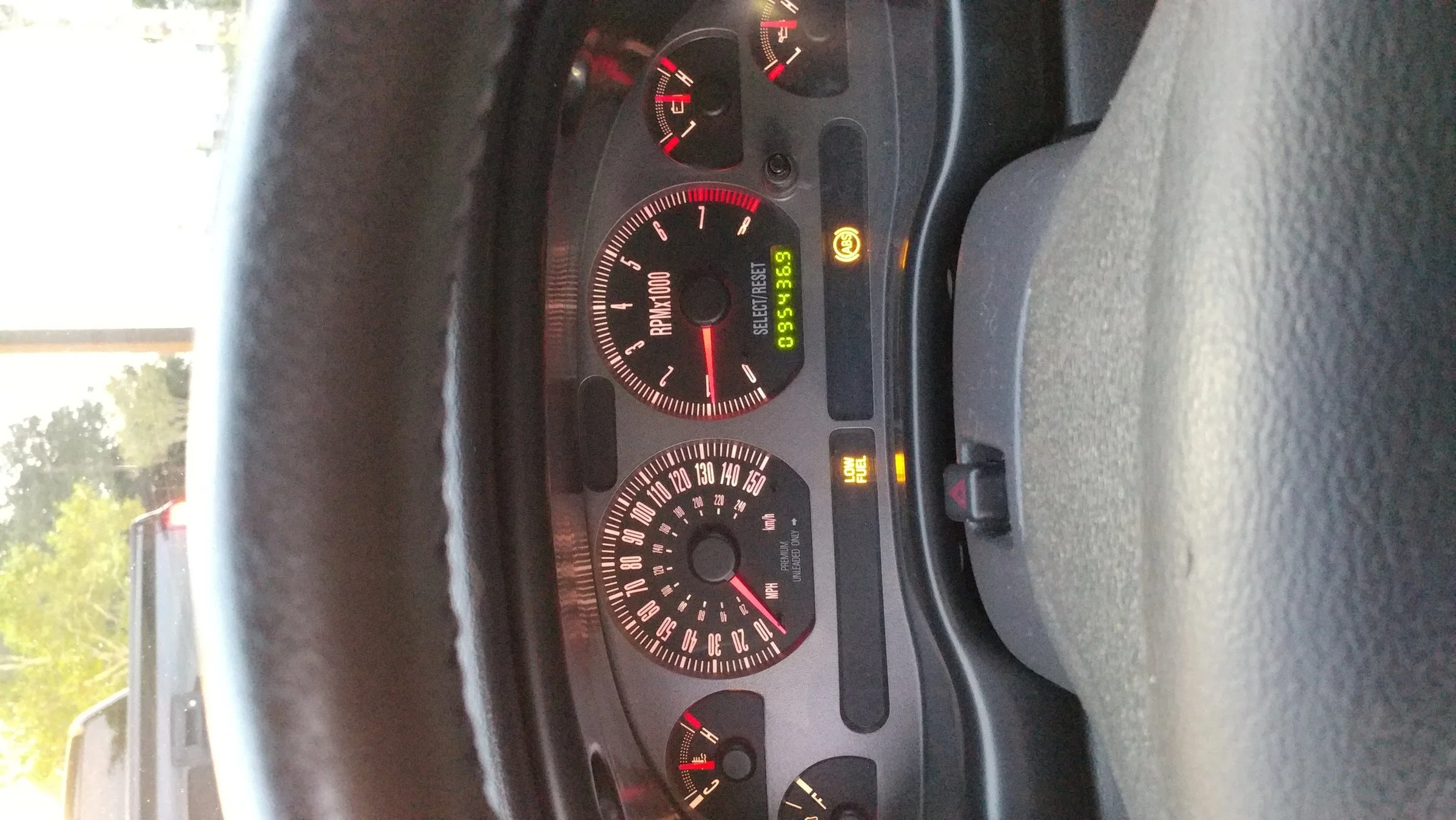

Could be as simple as a wheel sensor, as complicated/expensive as the Control Module and several other things, get the DTC's. If you only have ABS it will easier to get the codes than if you have Traction Control too. I believe wmburns has the low down on a way to do it.
Oddly the light went away and did not come back on. I will keep an eye on it and if it comes back I will scan the car for codes.

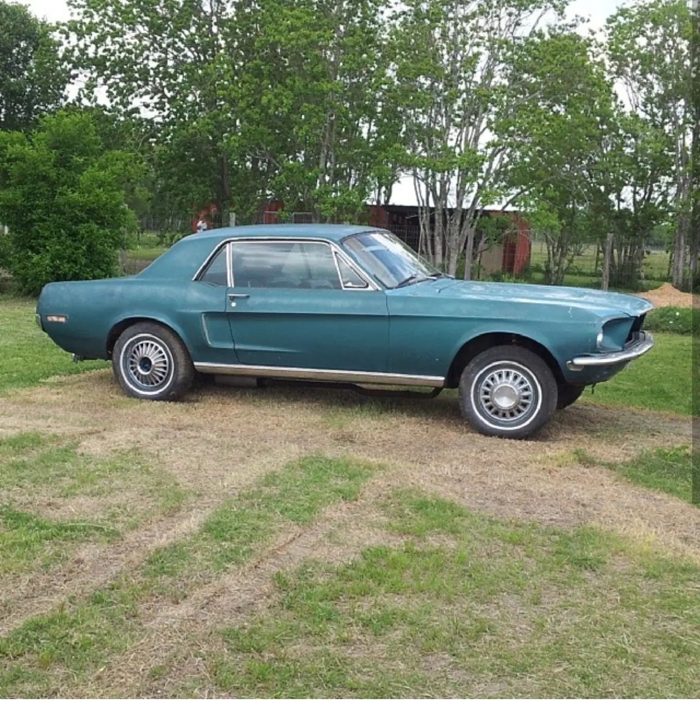

Is that a 67 or 68 mustang i see there in the background?
Its a 1968 Model year. Supposed to have the 289 V8 with auto transmission. Its my moms car and I want to fix it up. I was going to make a thread for it but I don't have the money saved up to do stuff to it right now. Come tax return I will have some cash saved to send the engine and trans off to be rebuilt.

ABS cars sometimes get picky about slightly different tire sizes. Some are more picky than others. If it comes on then back off I wouldn't worry too much about it pending the abs works as it should. There should be a code stored for it regardless.
