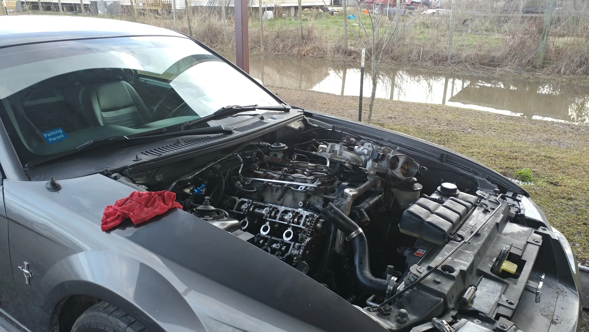

Hi all well yesterday on the drive home from work my Mach started making a noise. It sounds like a loud ticking noise. I stopped driving it and called AAA to tow it home. When I got it home my dad listened to it and it sounded like a sticky valve to him. It drives fine and there is no loss of power. Oil pressure is normal and the oil is good. It is fairly loud though not like the typical tick that I heard about these cars having. I don't know much about fixing engines so I'm not sure what I will have to do to fix it... I have a buddy that rebuilds motors and he was going to offer to look at it. Im afraid my motor is trashed and I will have to rebuild it completely.
I dont know if I should take it to a shop or wait for when my buddy has free time to take it apart and fix it if possible. I thankfully have another car that my parents are letting me drive. So I guess I should be smart and wait for my friend... I just hate having my Mustang down.
If your buddy has a good track record with these engines then you should wait. If he screws it up and you have to take it to someone else it could be costly. Hopefully he is a good troubleshooter and can find the problem and explain it to you and your Dad thereby leaving a second opinion possible if needed.
Here's a video of it running with the noise. We wont start tearing into the motor until January or so because my buddy has to finish rebuilding his engine and trans in his Mustang.

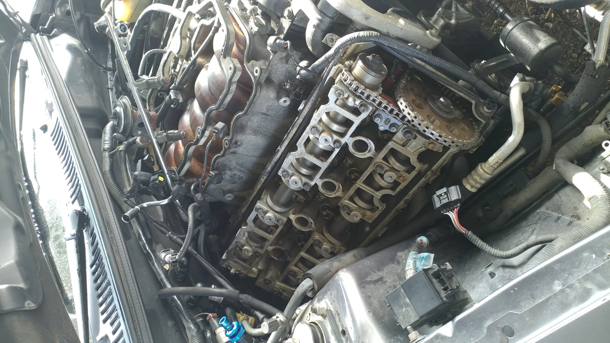

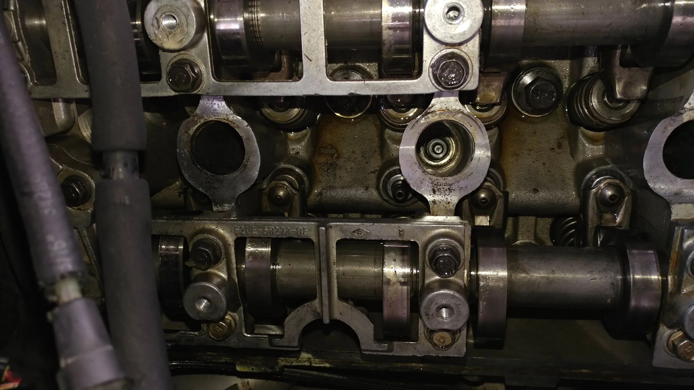

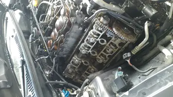

Worked on my car and replaced most of the lash adjusters on the passenger side but there is one that is giving me trouble. The one that is giving me trouble is where the noise was coming from. The rocker wont go on the lash adjuster and I think I have a bad spring or valve.
Determined the valve spring is bad and will need to be replaced. I believe whoever did the cam swap on this car did not upgrade the factory springs. Looks like I will be replacing all of the springs on the car. I gotta get a small camera first to check the piston to make sure its not damaged...
