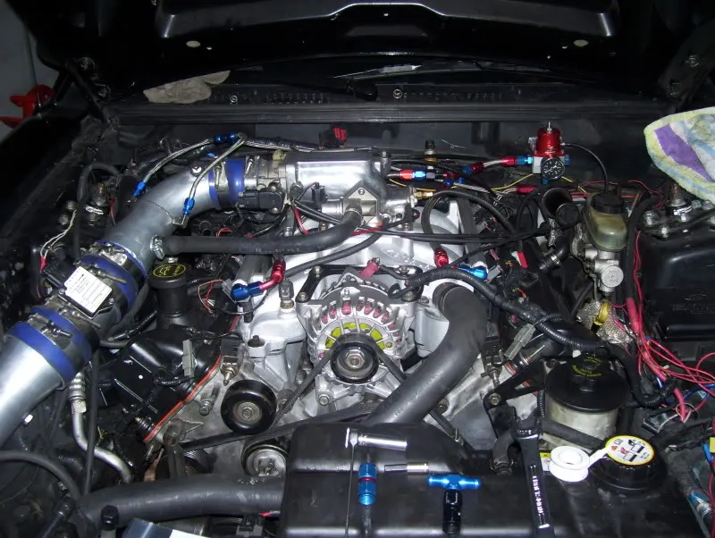

I gained 12rw/40+tq. I have a C4 transmission, so when I go wot the rpms jump to atleast 4000. I did have to clearence the stock hood to clear it. I used the MMR adapter plate.
Here is video with the 305ci big bore in the car now.
YouTube - Spooling twin turbos
