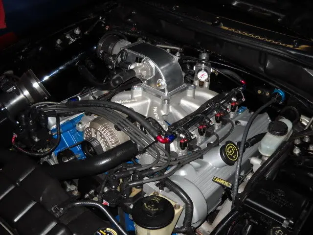

just got my 6061.com plenuim today!
Update on the install , was a very tiring one but at the end it was worth it , car feel much lighter than stock , drive ability is awesome and better than stock , my Vortech pipe needs some trimming its blowing off at 5k rpm :rlaugh:
so dyno has to wait.
More pictures with details next morning :D
More pictures for reference , note the the fuel rail setup :)
you wouldn't believe how deep the gap is , its enough to fit a bag in there.
Rail Picture. awesome quality , don't mind the oil my hands are dirty ^^
Fuel Pressure sensor is mounted in the front and the feed is on the other side , the stock fuel line will not reach the front of the rail , i believe you need a 97-98 feed line its a direct fit and is longer making it OEM and clean! if your doing it reveres for the sake of simplicity.
