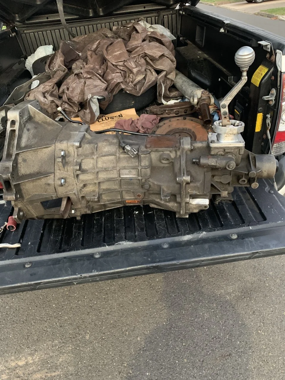

In the posts I quoted I was wanting a T56 to replace the Tremec 3550. Well I found one! Everytime I downshift into second the 3550 gives me a hard time. Shifting into the .63(?) overdrive gear from fourth drops the rpms a little more than I'd like. I am hoping the new to me transmission will remedy both of these situations.
