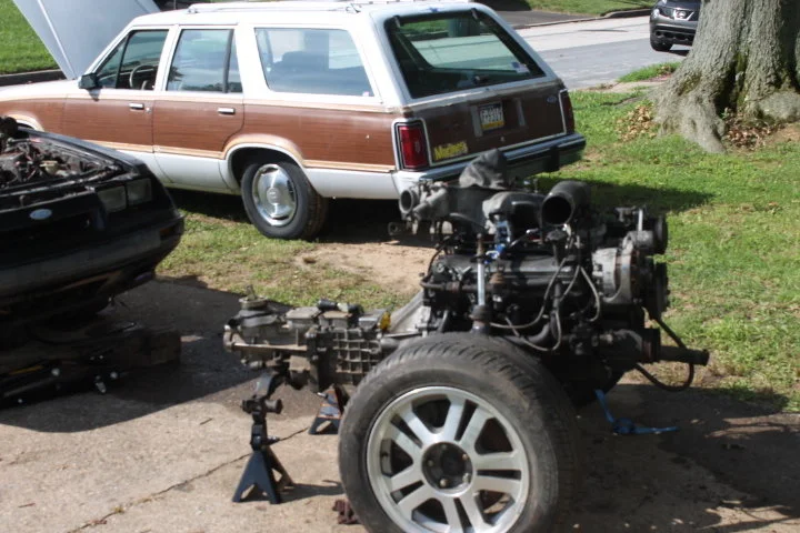

Alright. I am just trying to plan ahead. Who amongst us has successfully completed this swap? Chime in with any problems you ran into or parts you had to buy, etc. I ask because this is the next step for the Daddywagon. I just about completed the installation of an efi 302 from a 1986 mustang gt into a 1985 Ford LTD foxbody station wagon. I used Ford's M-12071-A50 harness. The computer is A9L. The meter is Pro Flow(?) calibrated to 24lb injectors. The car starts and runs. Now that I am so close to driving it the time has come to build and install a 351. Thoughts?

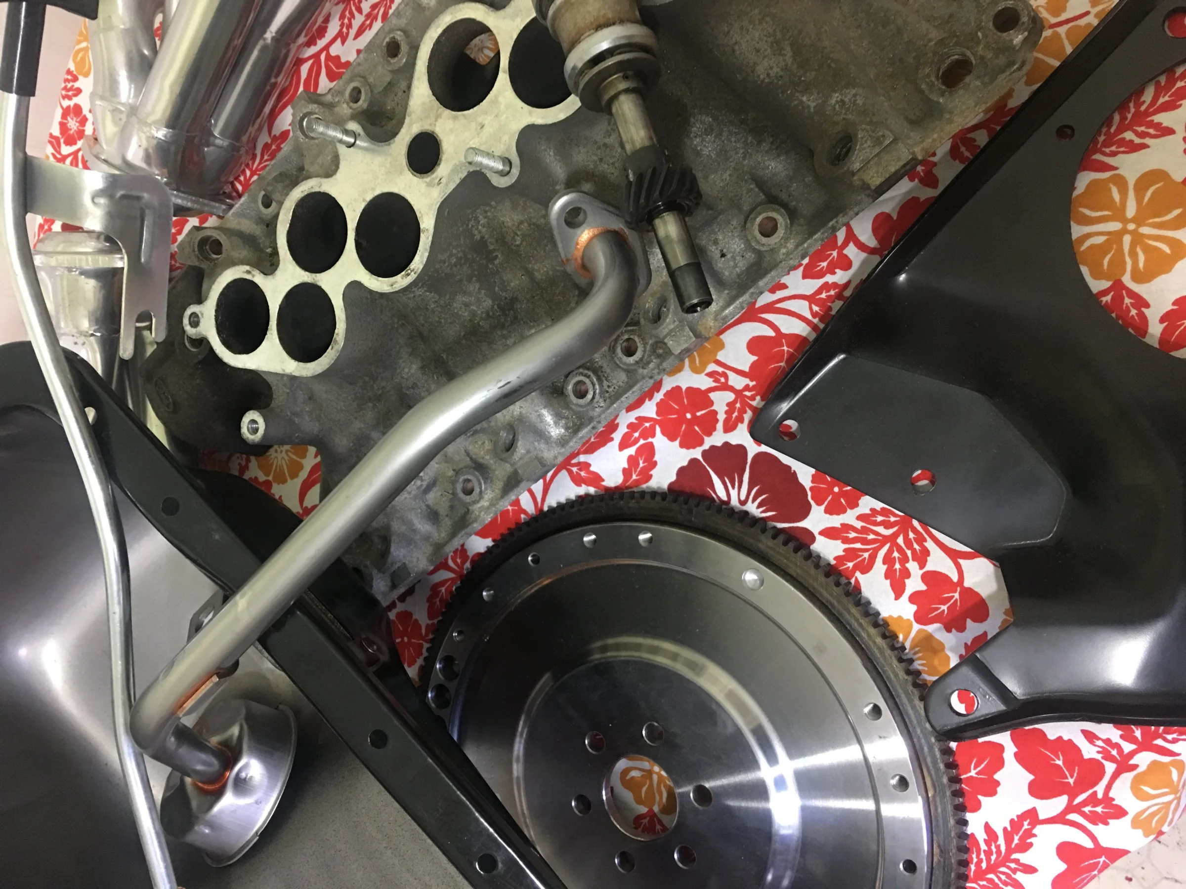

Pic of some 351 swap parts taken this past weekend.

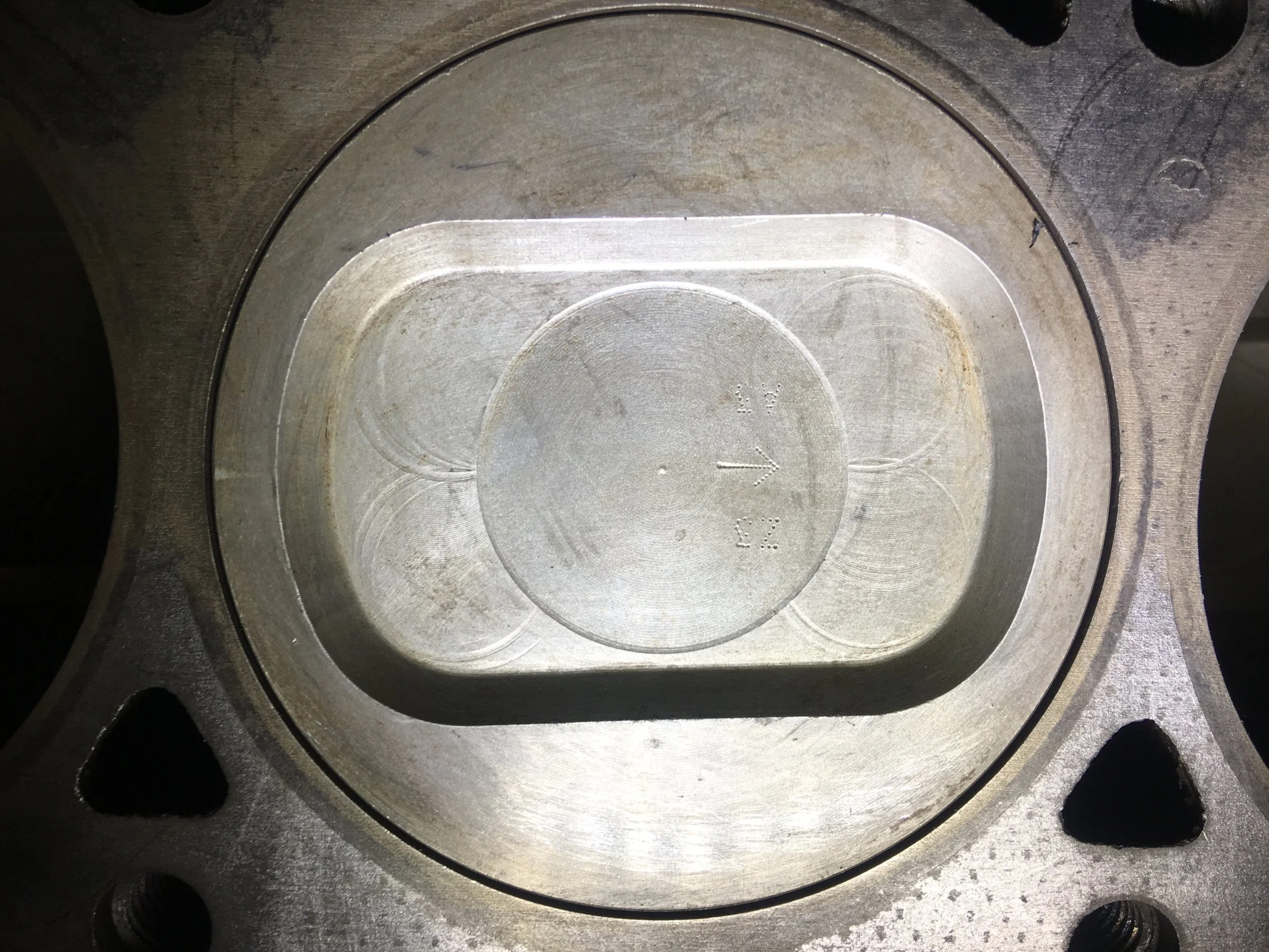

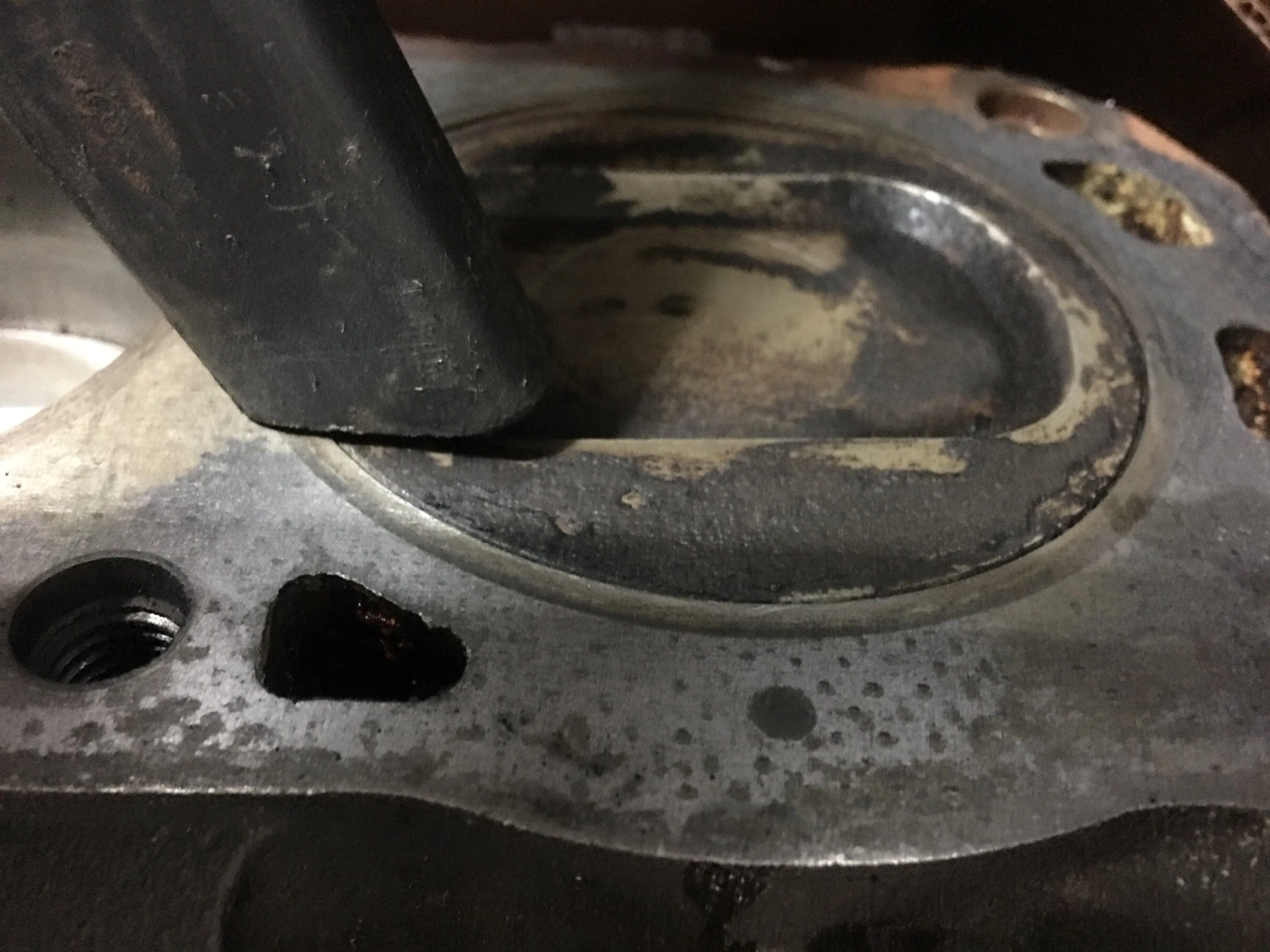

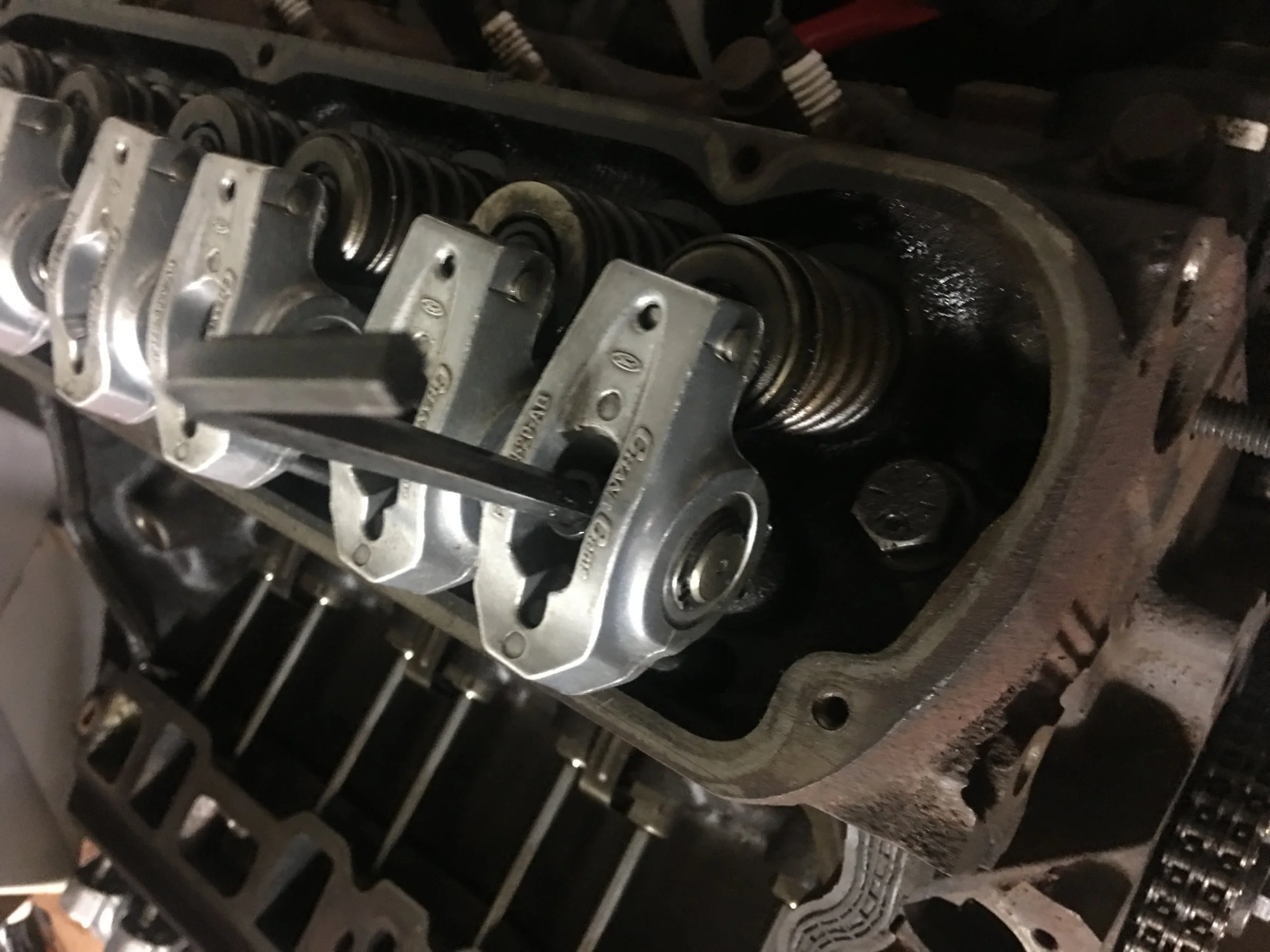

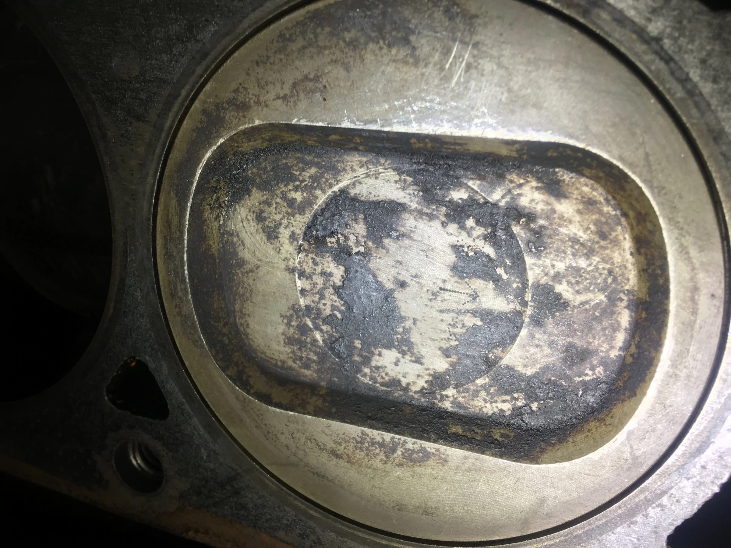

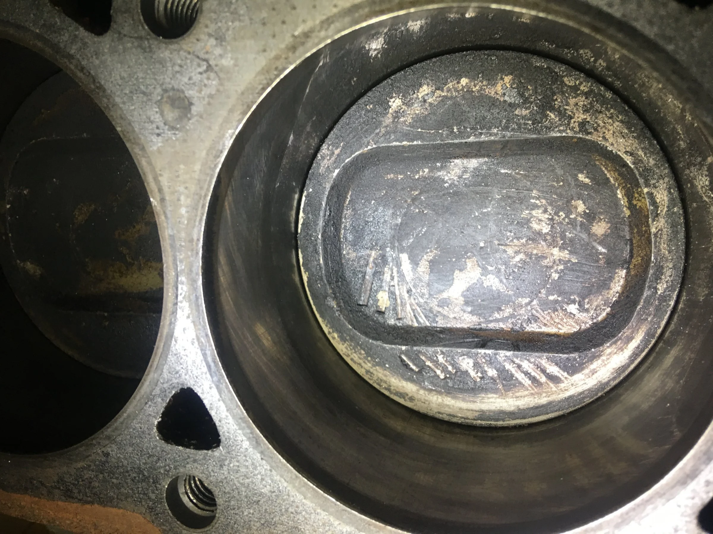

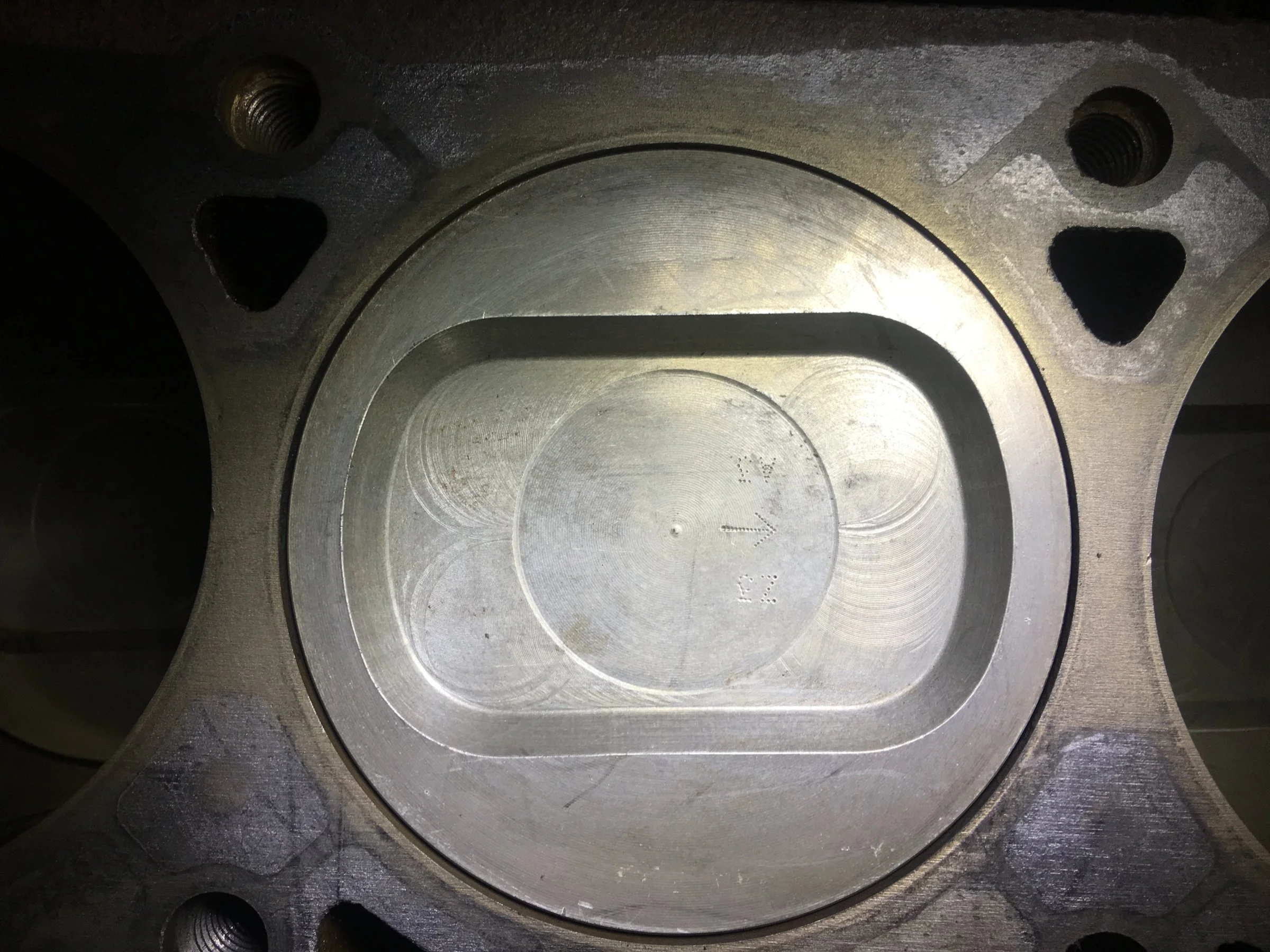

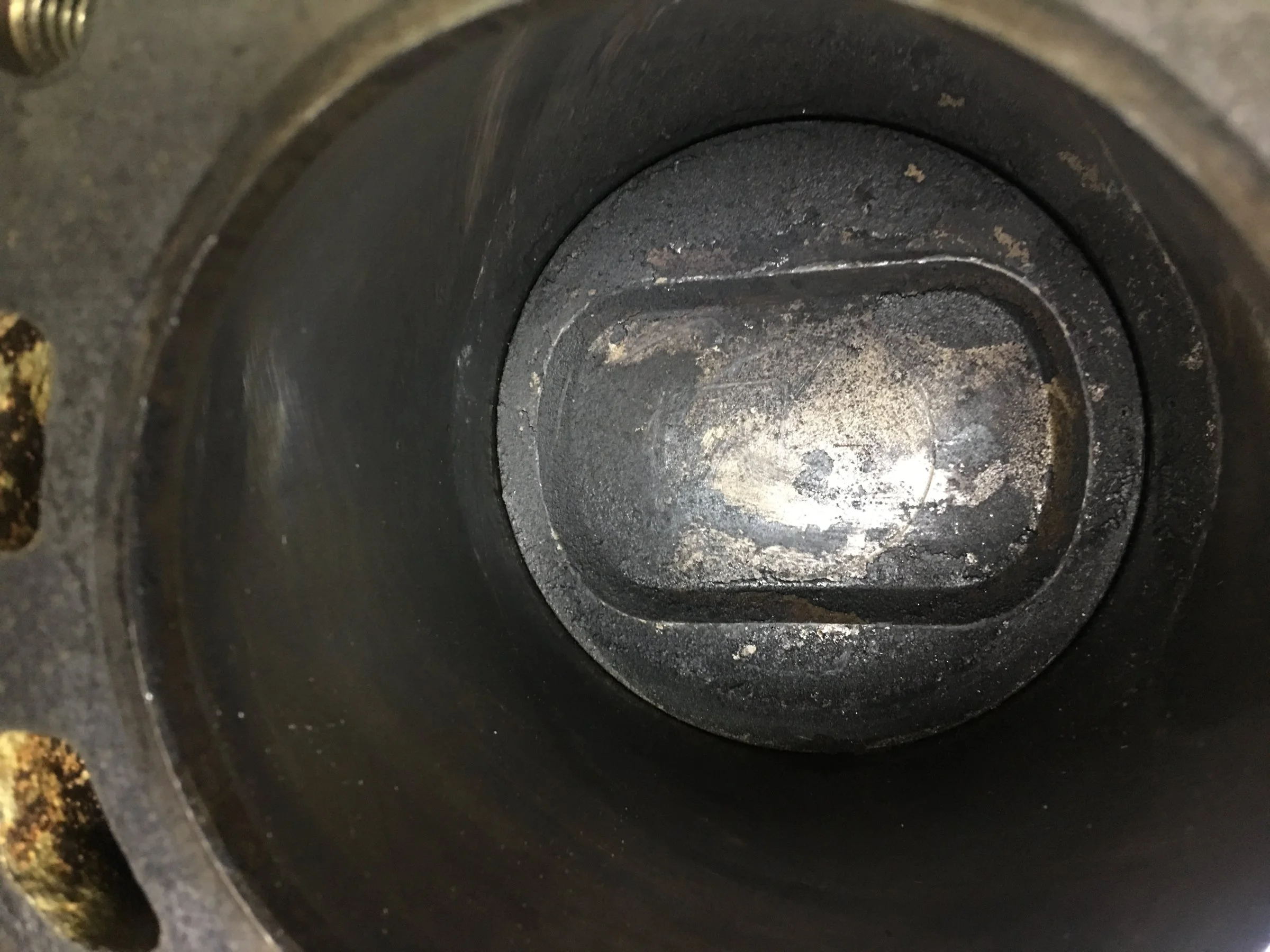

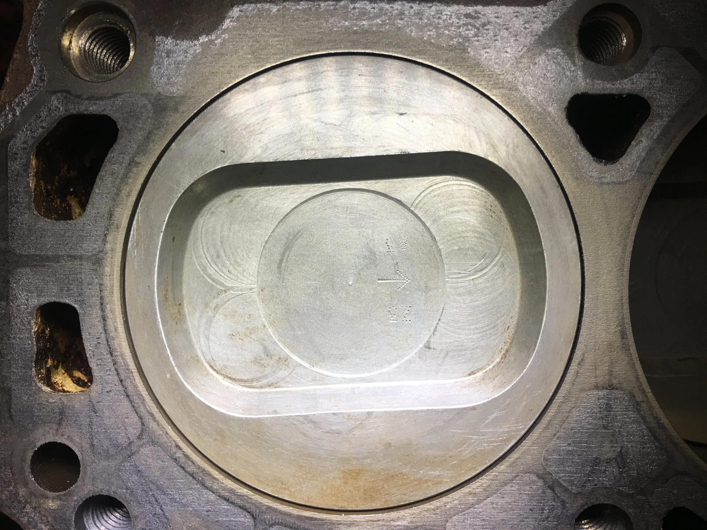

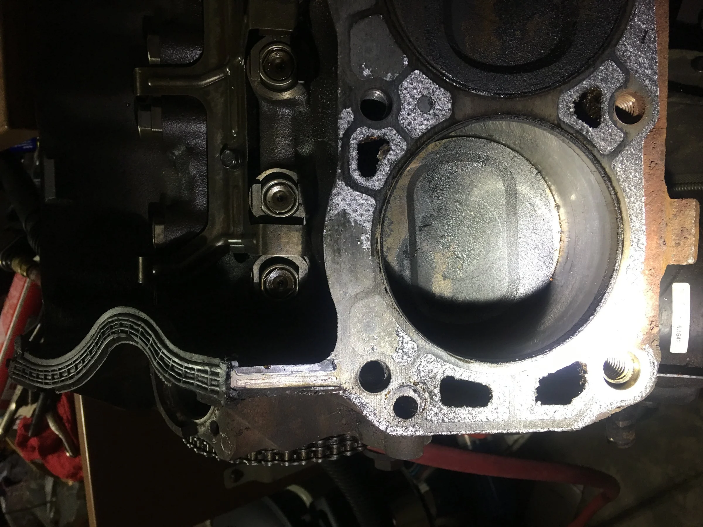

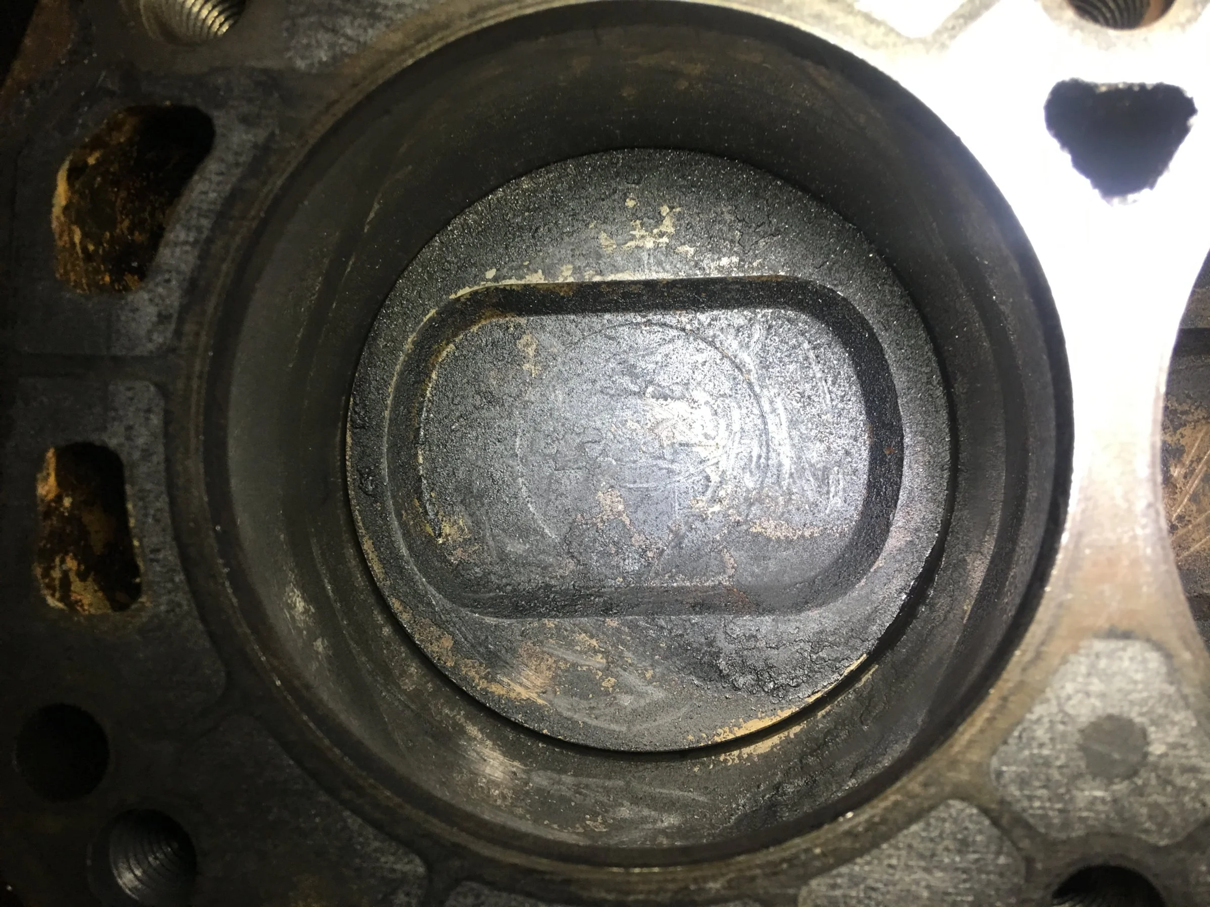

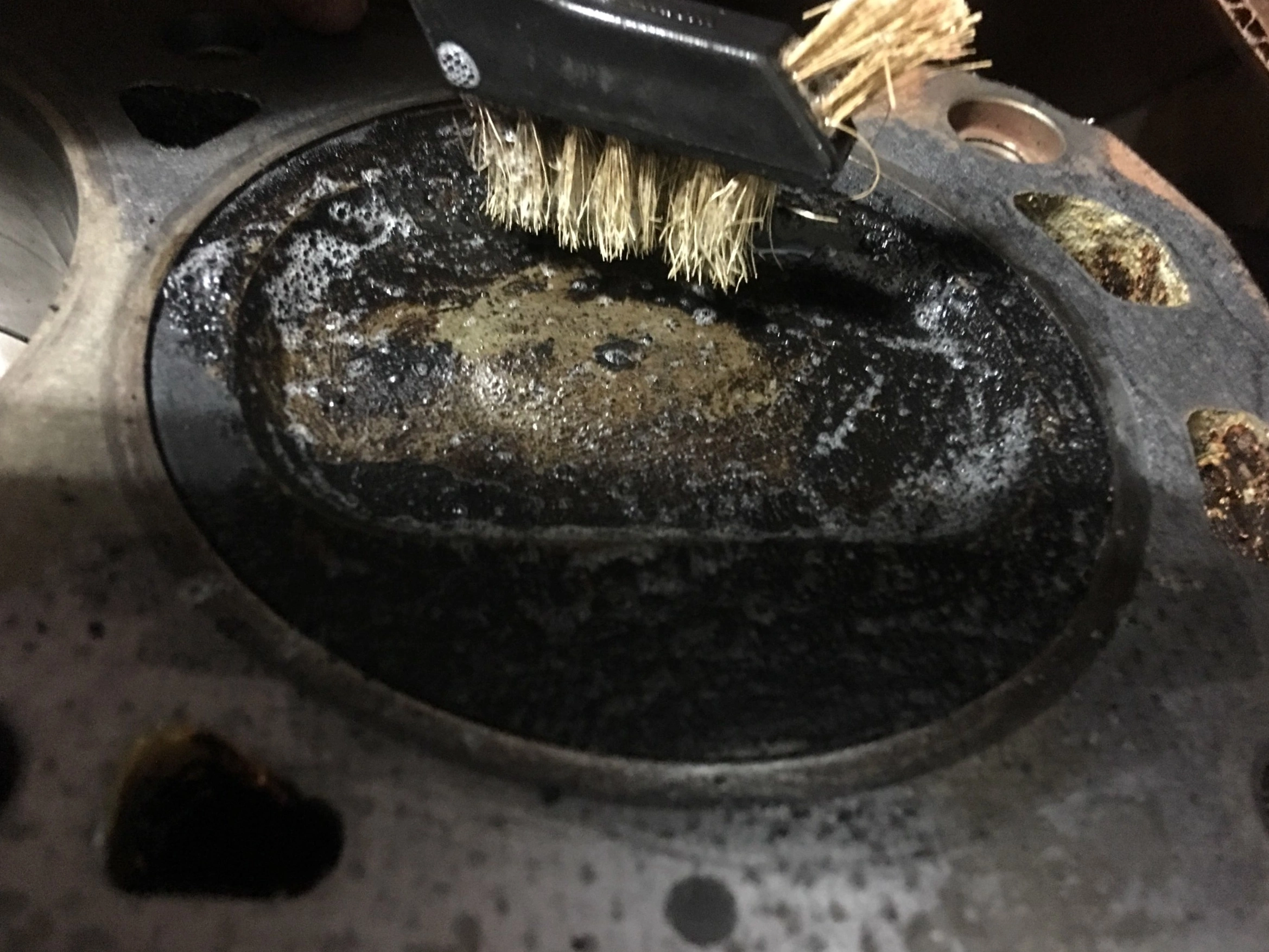

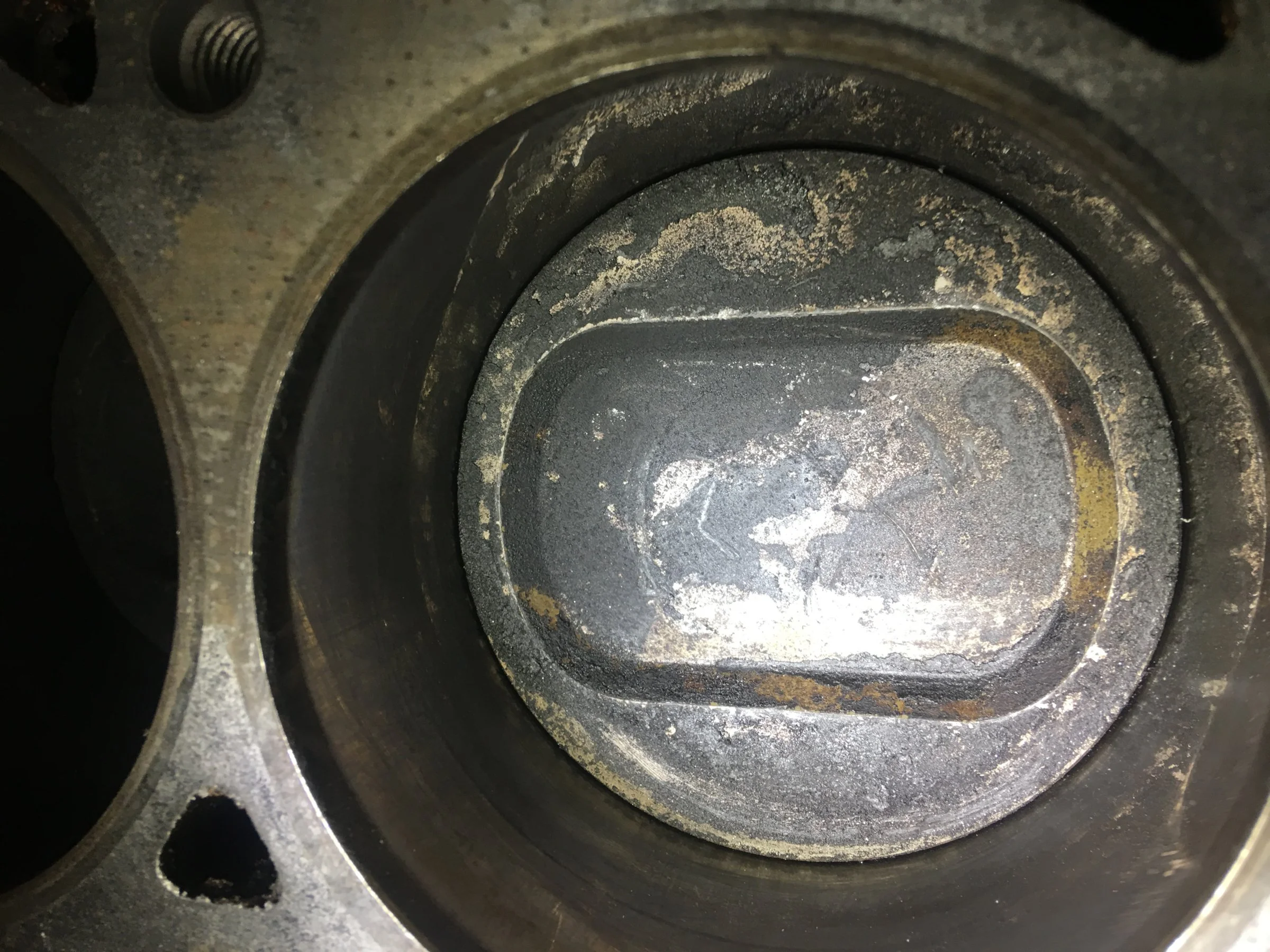

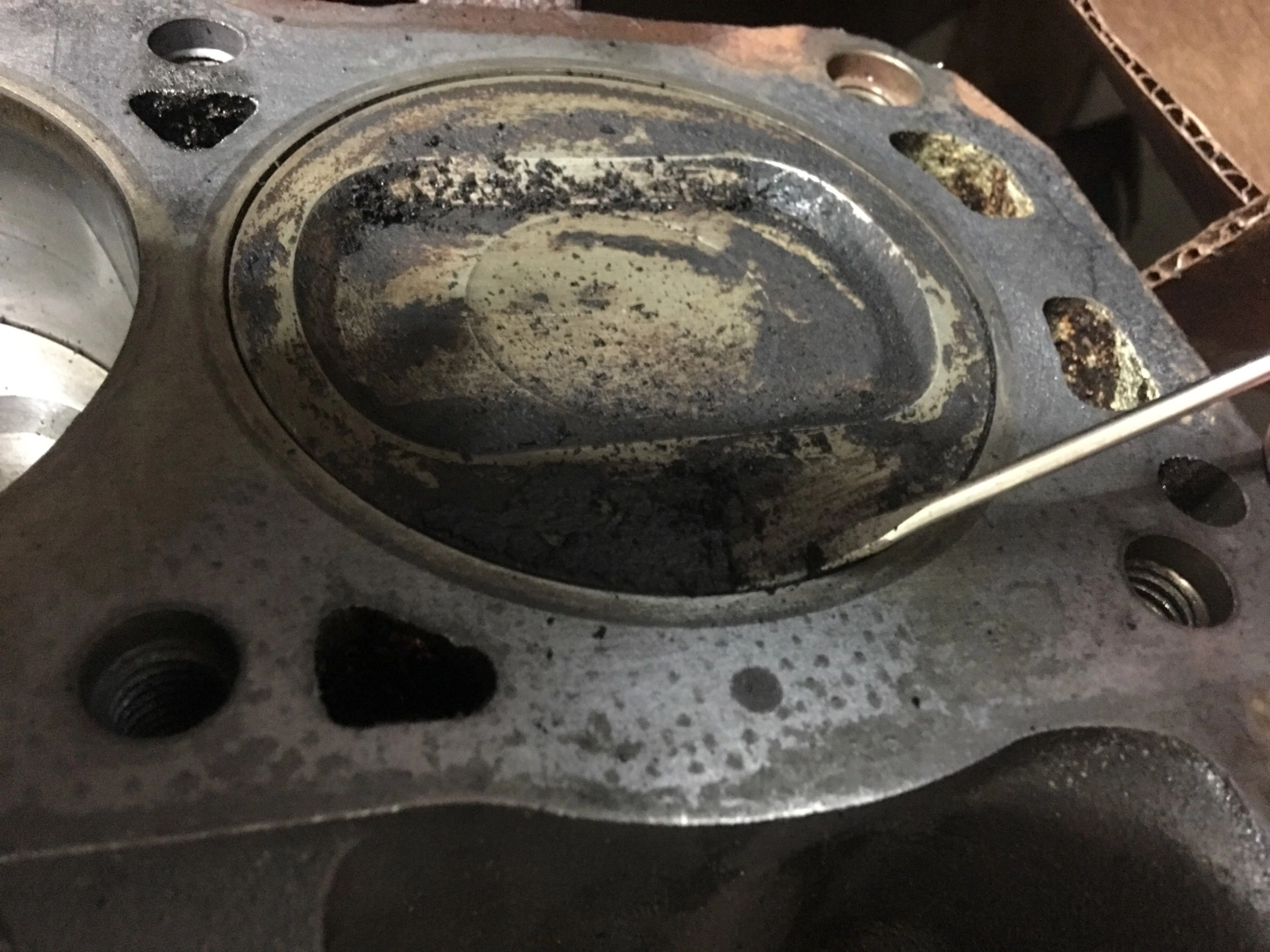

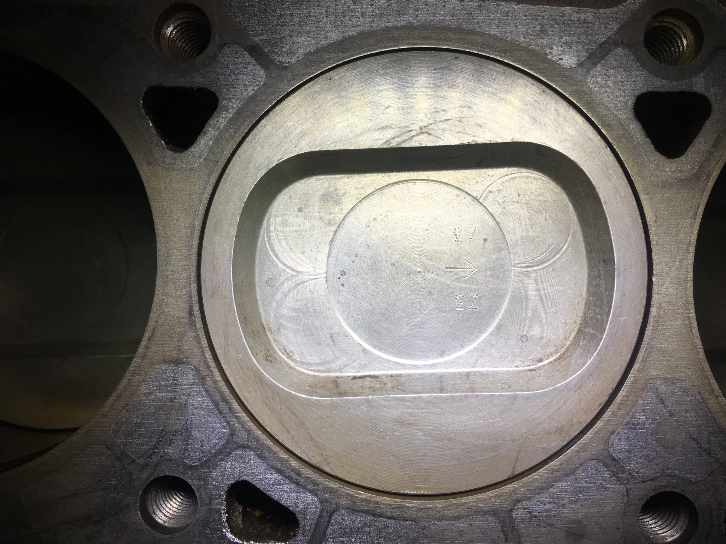

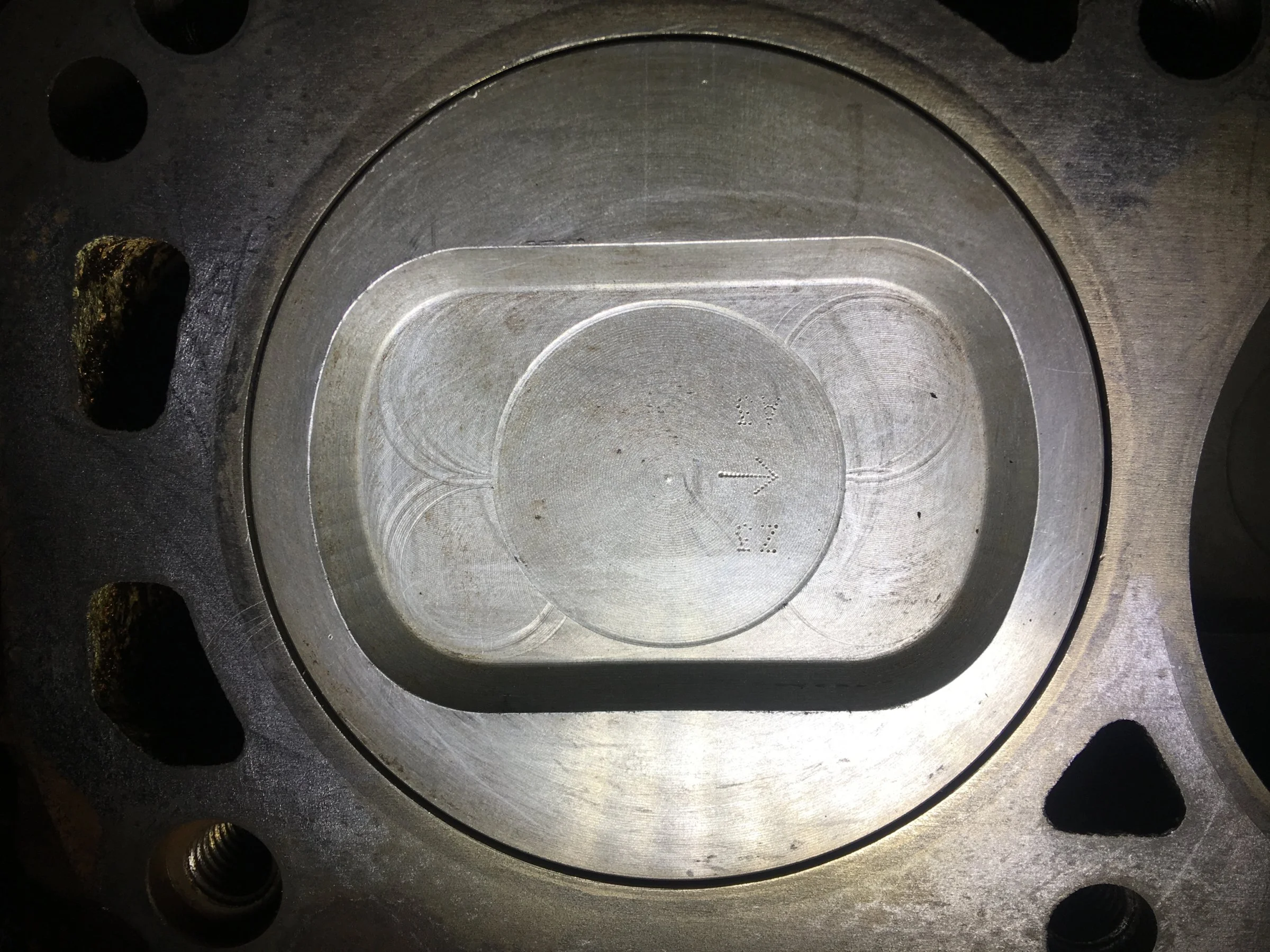

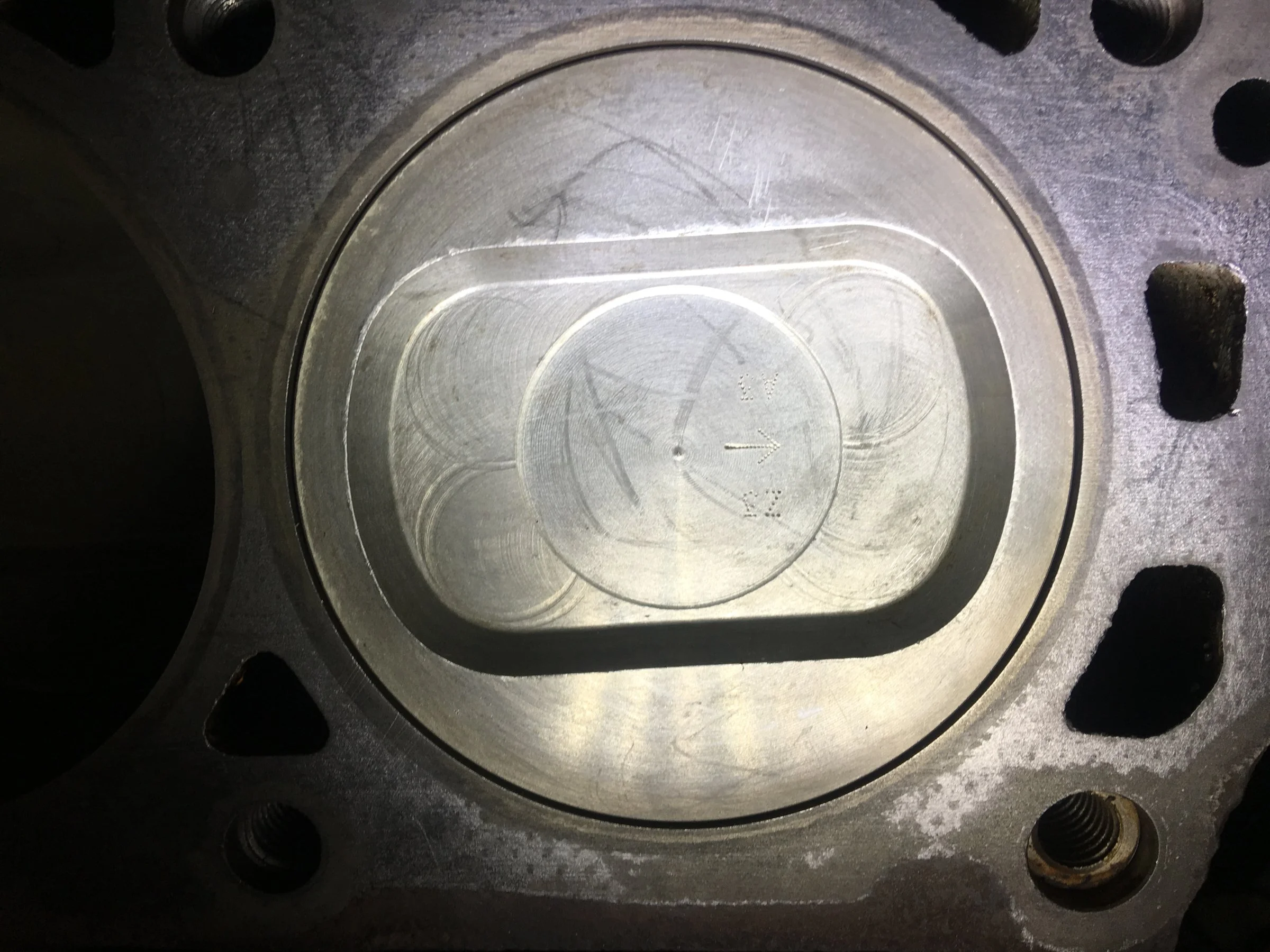

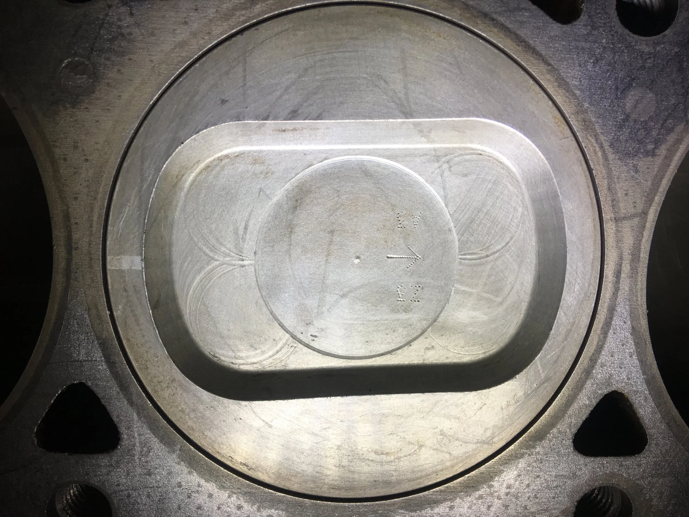

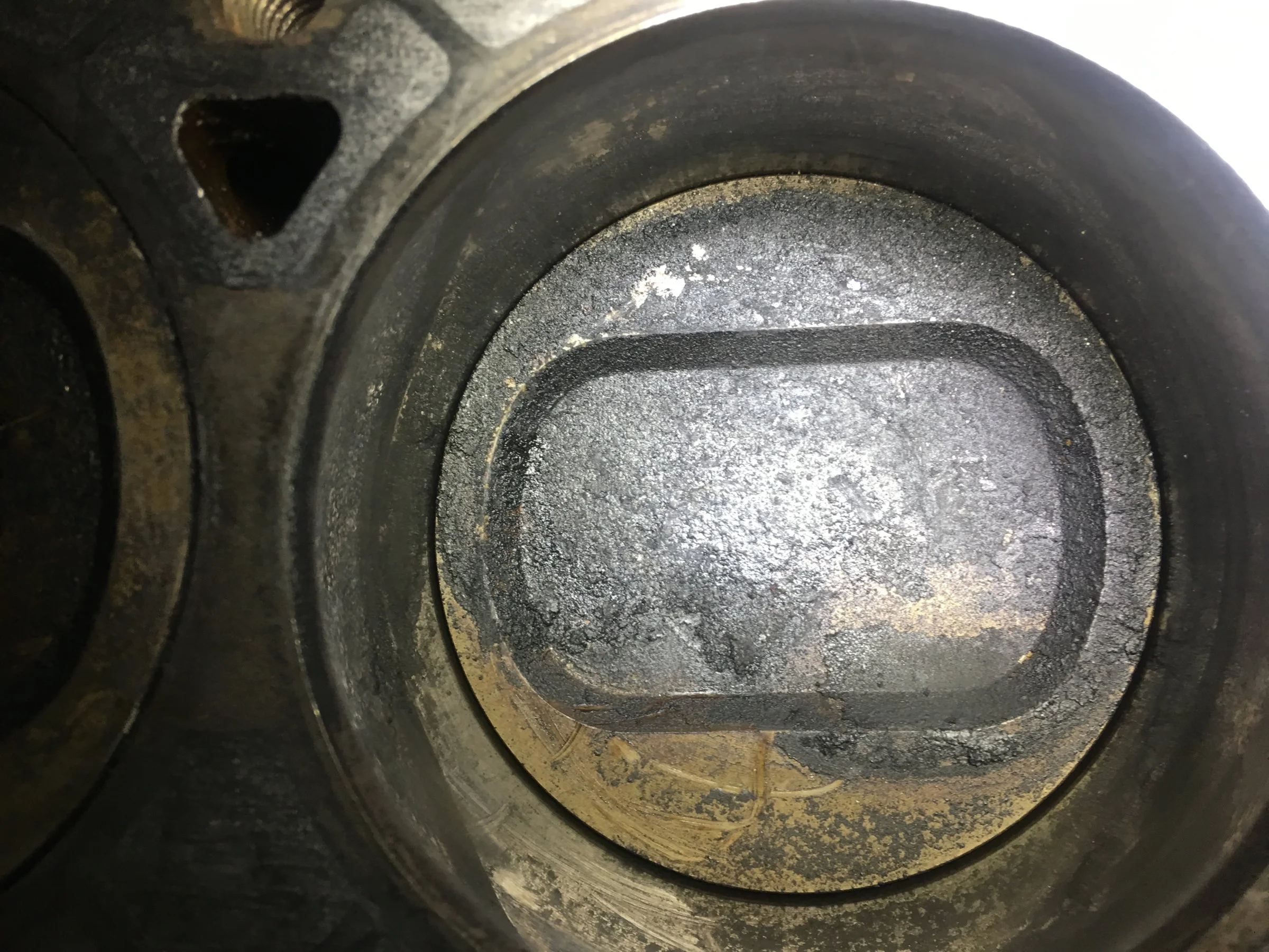

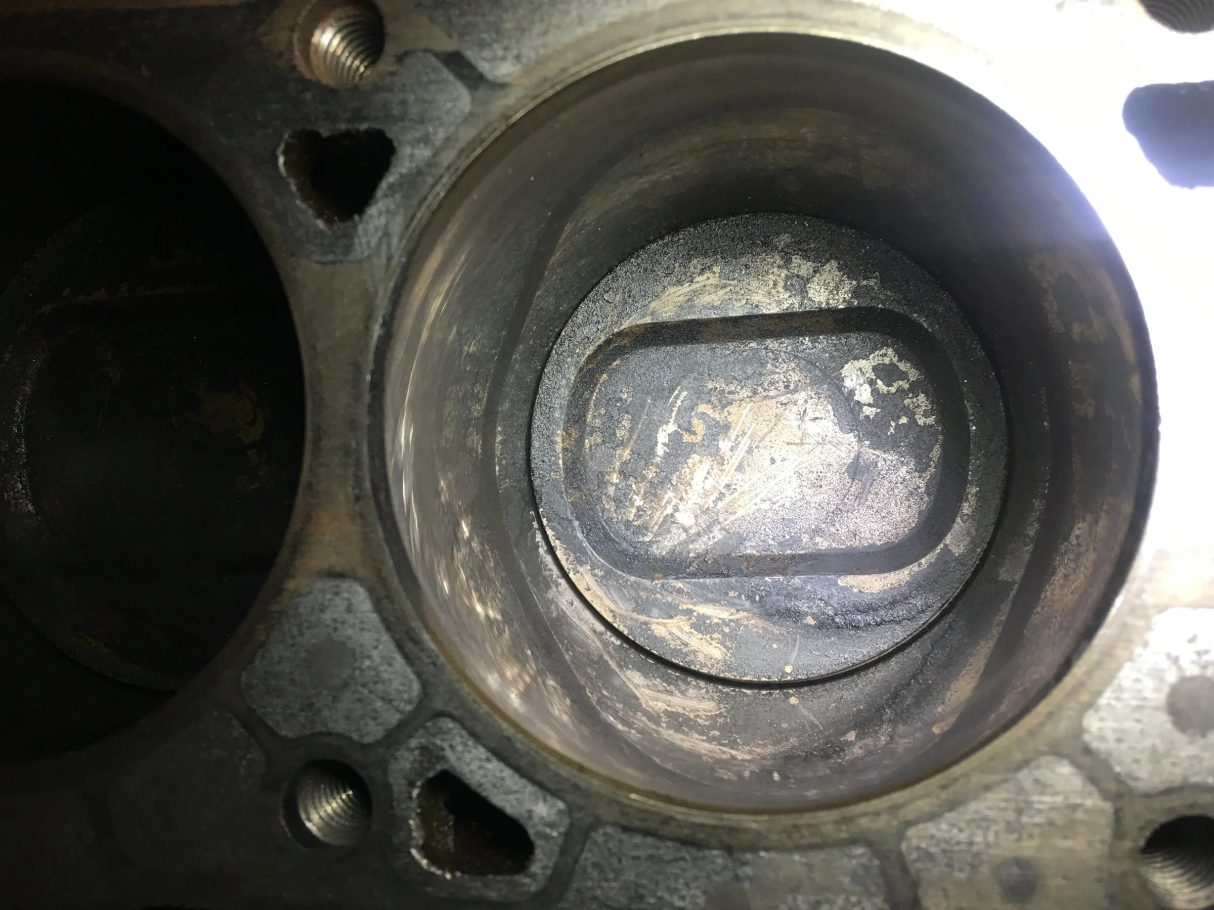

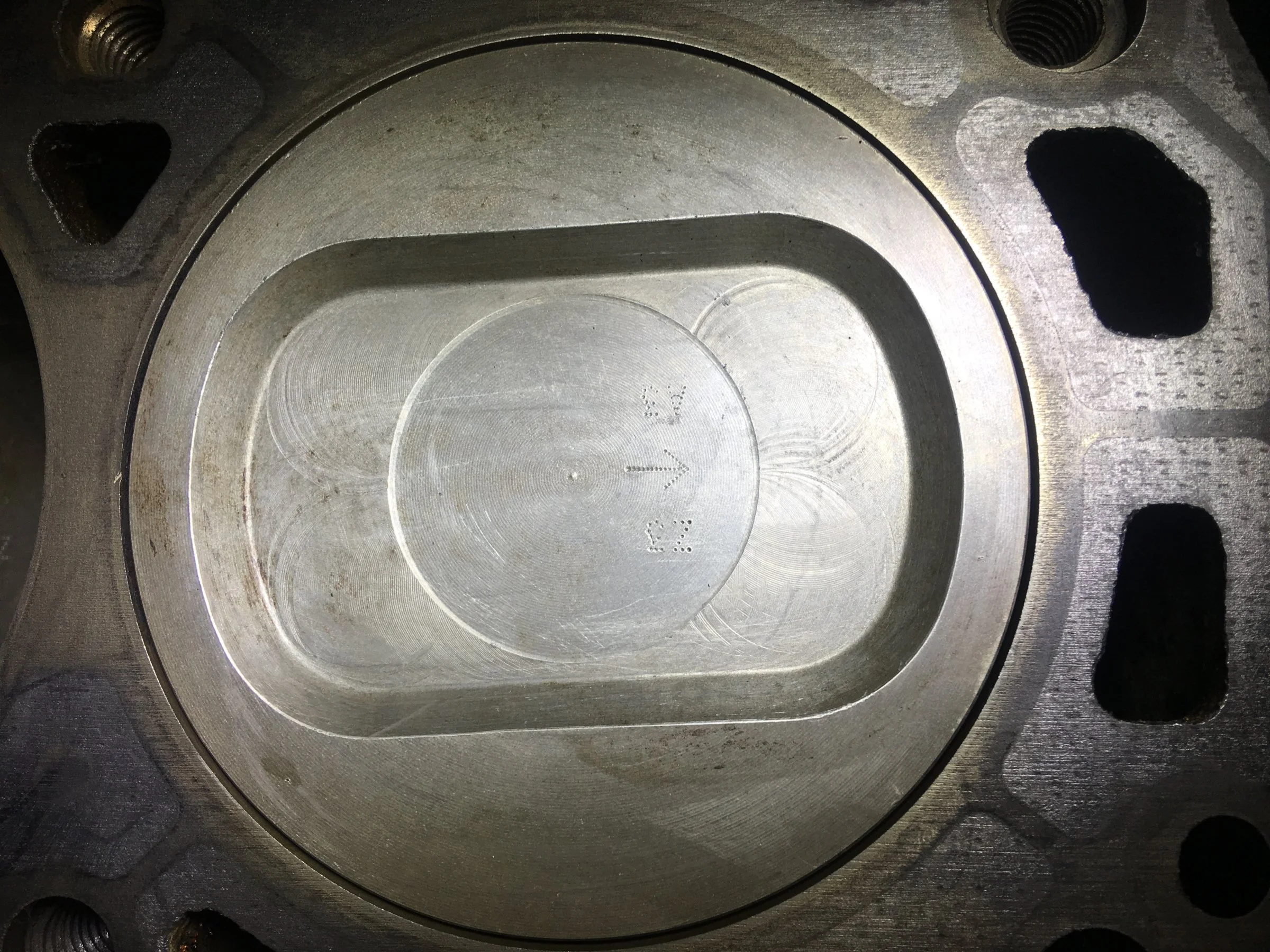

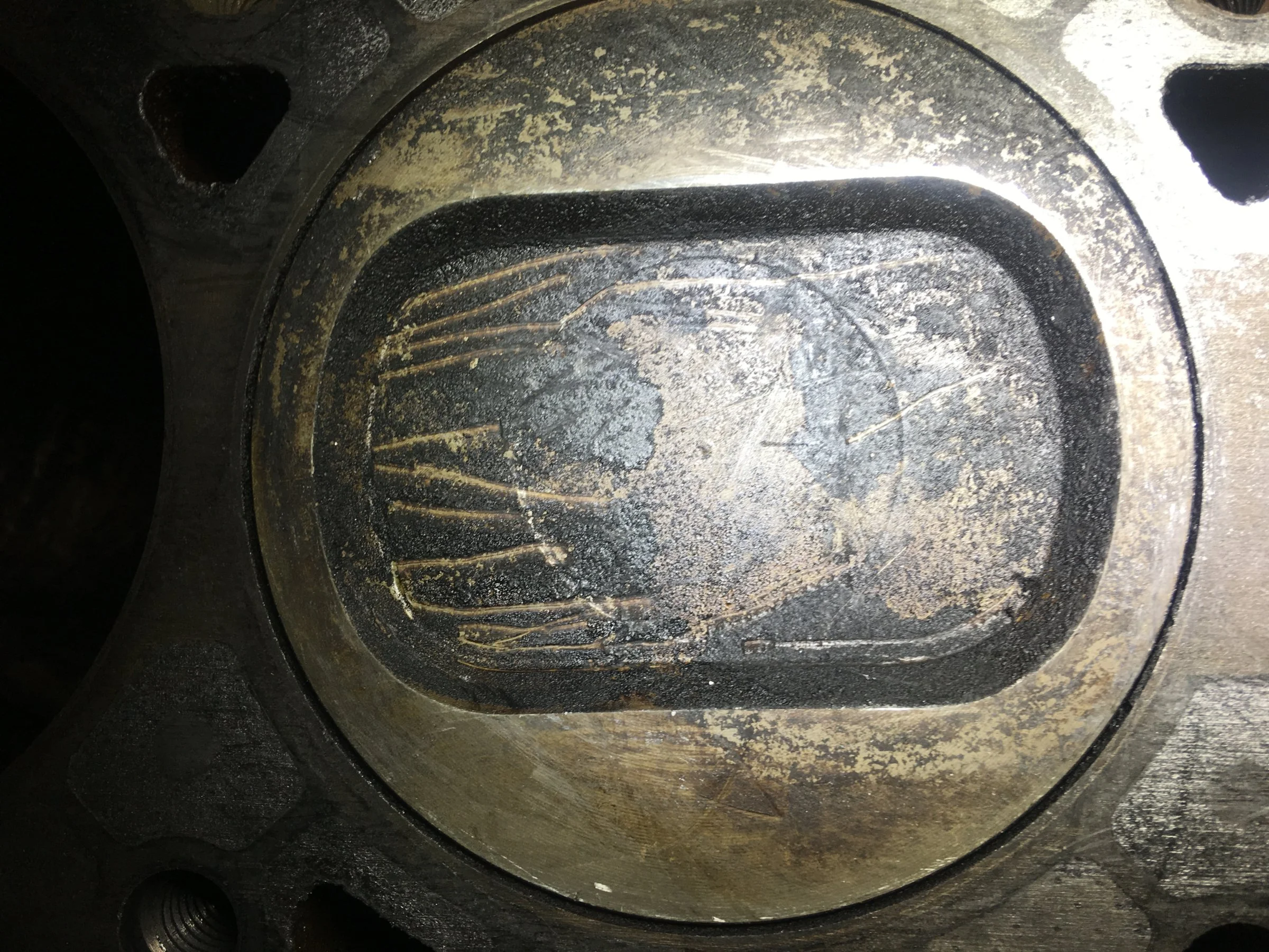

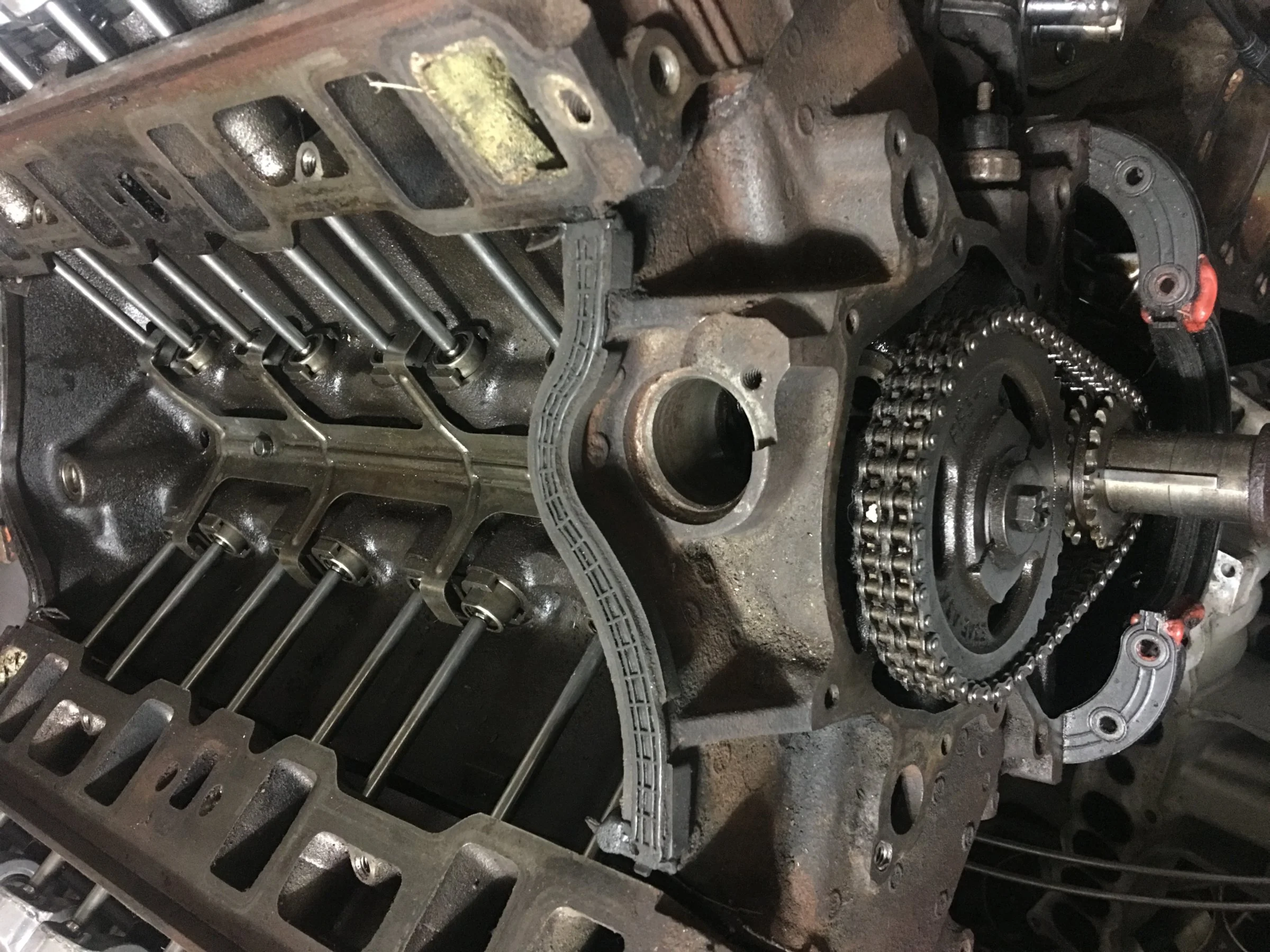

My plan is to just throw a 351w into the Daddywagon. I bought the engine a couple of years ago from a guy who built up Ford Lightnings. I can’t remember if it was his or an engine he got from someone else. I believe it was someone else’s because I recall him saying the previous owner installed the cobra rockers. Well I lifted the gt40 heads and the piston tops have quite a bit of black carbon buildup. The plugs and combustion chambers look ok! The intake valve on #1 cylinder is darker than the other 7. I ordered valve seals, but I am intent on not diassembling the engine any further. If I have to pull pistons then I will just have what I believe to be a better block machined and begin my long rod 351w build.
cylinders 1 thru 4

cylinders 5 thru 8
