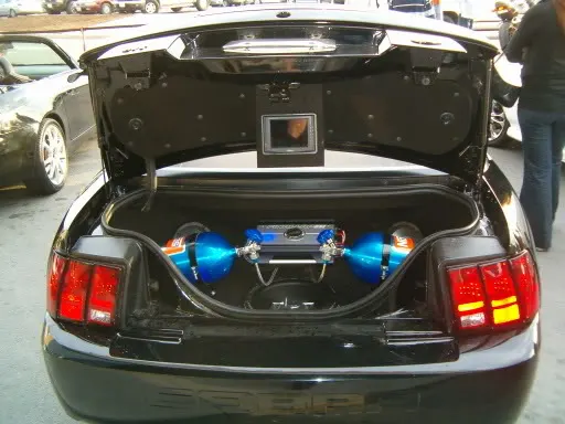

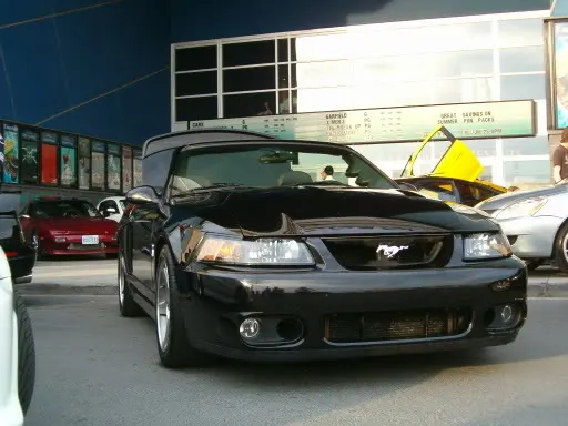

This car = 529rwhp on pump gas, I know this because he's a good friend of mine and I've oggled his dyno sheets....and he hasn't had it properly tuned yet
and with this....who knows? He hasn't gotten it dyno'd with the bottles yet...300 dry shot

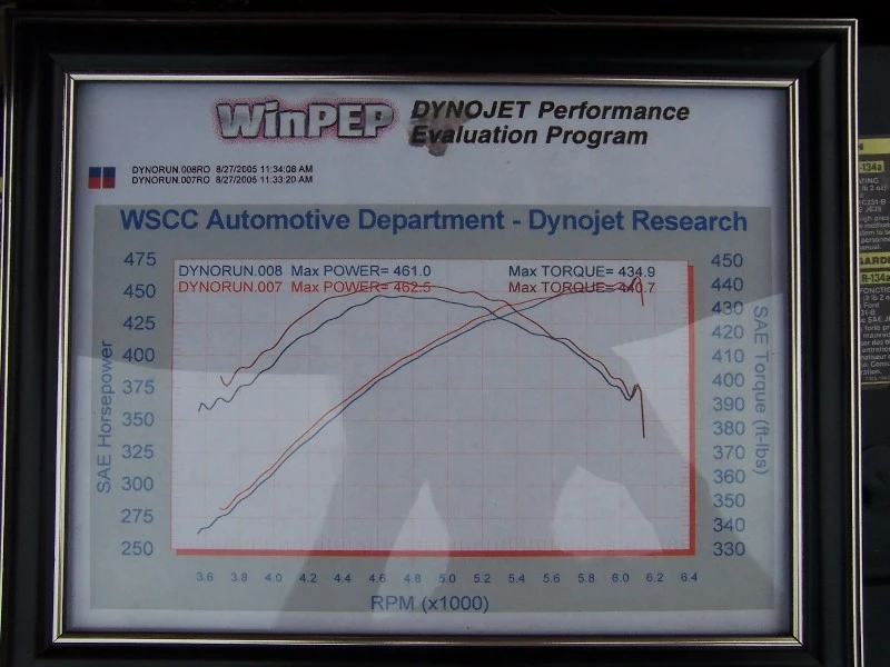

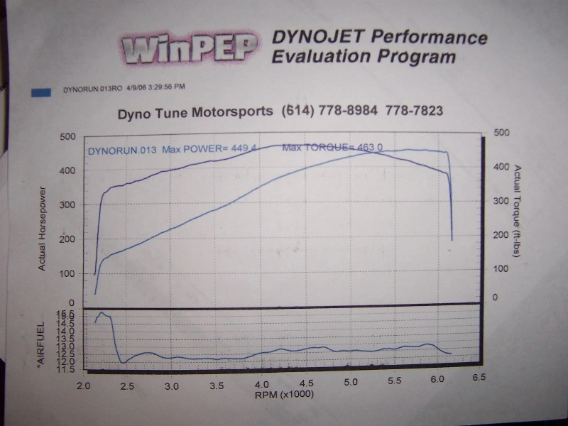

Back on the original topic, yes it will cost a lot to build a 500RWHP N/A stroker. I havn't figured up exactly how much I have in mine, but I would guess it's right around $8-9K. I bought mostly used parts, found some good deals, and did all the work myself. A friend of mine put together a 427 at the same time time I was getting my engine together. He went with a built long block from Delk Performance and ended up spending around $14k from what I hear. Here's our dyno sheets
Mine,
His,
The only differences between them is that he's running a Spyder intake and TFS stage 3 cam, and I have the Victor intake and custom cam. Both cars are very streetable. For 500RWHP, I would go with the Spyder intake and a custom cam. 550-600hp should be possible if you're willing to sacrifice driveability and/or rev it to 6500-7000.
One more thing to add, so far I have the better E.T. out of these two cars. ;) 12.20@120 vs. his 12.40@119(different days, same track)
