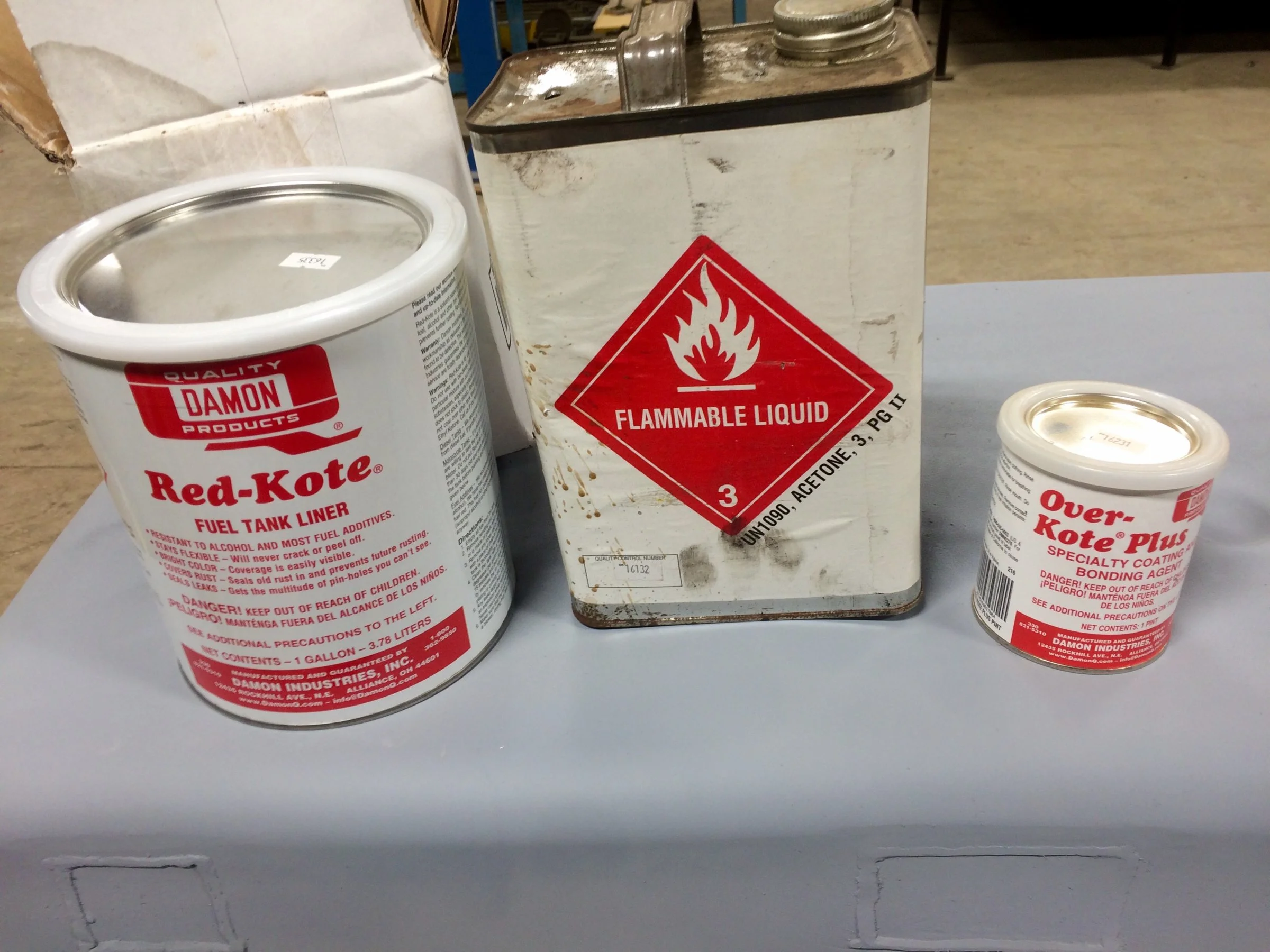

Red Kote is a fuel tank liner. Says it's even resistant to E85.
Be careful that you get the tank completely clean when you use this or the sht won't stick....I used it on the red car, and it worked great,..I used it on the monster and.............
Not so great.
This was a new tank....coated inside w/ a thin film of oil to resist corrosion,....and to guarantee that the red kote sht didn't stick.
