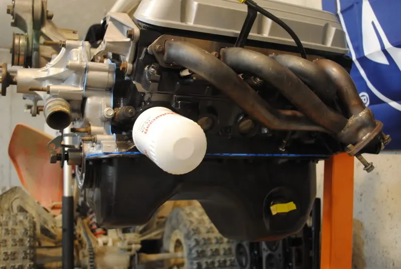

FRPP headers are p friendly. Dont quote me but I believe that BBK shorties are as well.
they are, but just barely. need 90 degree plug boots and boot protectors. and if you gotta change plugs, you gotta pull the header. they do work though, just not ideal.FRPP headers are p friendly. Dont quote me but I believe that BBK shorties are as well.
At least in my case, it's not just #7, but also #6. There's just not much room there, and I kept burning wires (or having one pop off) on those plugs until i put boot protectors on it. As far as a socket goes, maybe it would work, havent tried it, I usually just take the header off. Fwiw, the drivers side and 5 and 8 are easier to get to. In the end though if I didnt already have the bbks I would have gotten the frpps, and the only reason im running the p heads is because I crashed the valves in a set of wedge heads and putting the explorer engine in was way cheaper than a rebuildI heard the only issue with non p headers is on cylinder #7. When you need to remove the plug I've heard you can take a spark plug socket cut off about 3/4" and take out the rubber and it will work for #7 plug. Has any one heard of that or used it?
