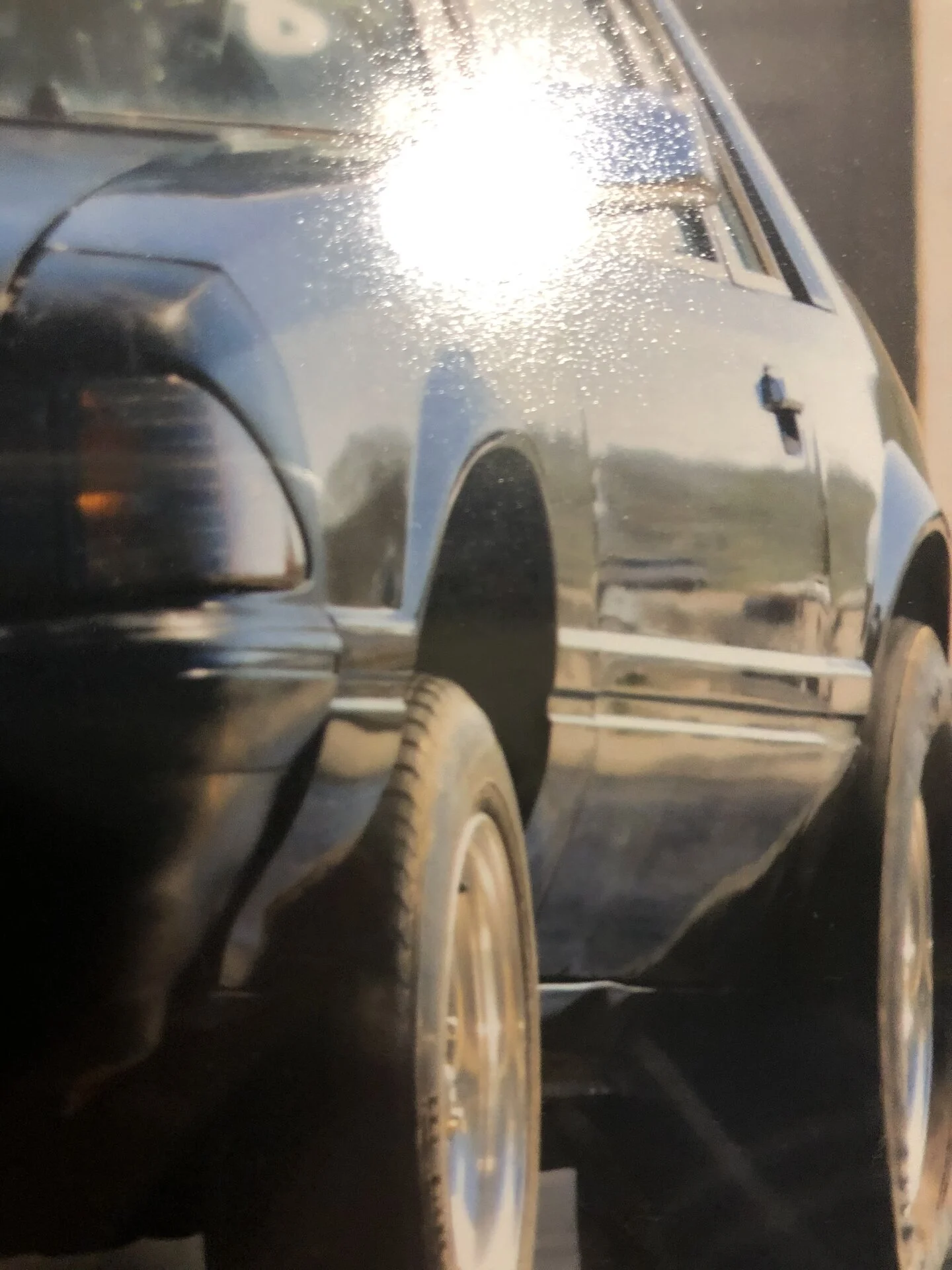

I currently have a 1984 fox body. It’s a drag car and has been completely gutted of all accessories, etc. I’m not a fan of the four eye look and the guy who had the car before me put a 1989 front bumper on it Bc he wasn’t a fan either. What bothers me is the molding/trim that’s in the fenders don’t match the bumper. I’m looking to put a set of fiberglass fenders on the car anyway. So my question is, can I put a set of 1989 fenders on the car? Any issues with them lining up right with the door gap?

The fenders are the same. I am assuming he used an LX nose and not a GT nose. You need the body moldings that attach to the fenders, doors, and quarter panels, as well as the LX rear bumper cover. IF it is a GT nose, then you need the ground effects kit, door moldings, and a GT rear bumper with quarter panel extensions (GT Rear bumper is essentially three pieces) or a 93 Cobra rear bumper cover to make it all match.

They do sell this kit at LMR - However, it is for 91-93 cars because the front fenders on those years are slightly different (larger wheel well distance) than 79-90. They sell a 6-piece kit that will fit 79-90 cars, but it will not have the moldings for the front fenders and you would have to source them separately.

I really appreciate the feed back although I believe I may have not worded my question correctly. Forgive me as I am new to forums and also fox body mustangs. After reading your post, I realized I wasn’t necessarily talking about the molding as opposed to the channel that the molding fits into possibly? I’ll attach a picture that will hopefully help. My end goal is to have a matching line running all the way down the car. I apologize for not knowing exactly what I’m talking about but the help is definitely appreciated!!
