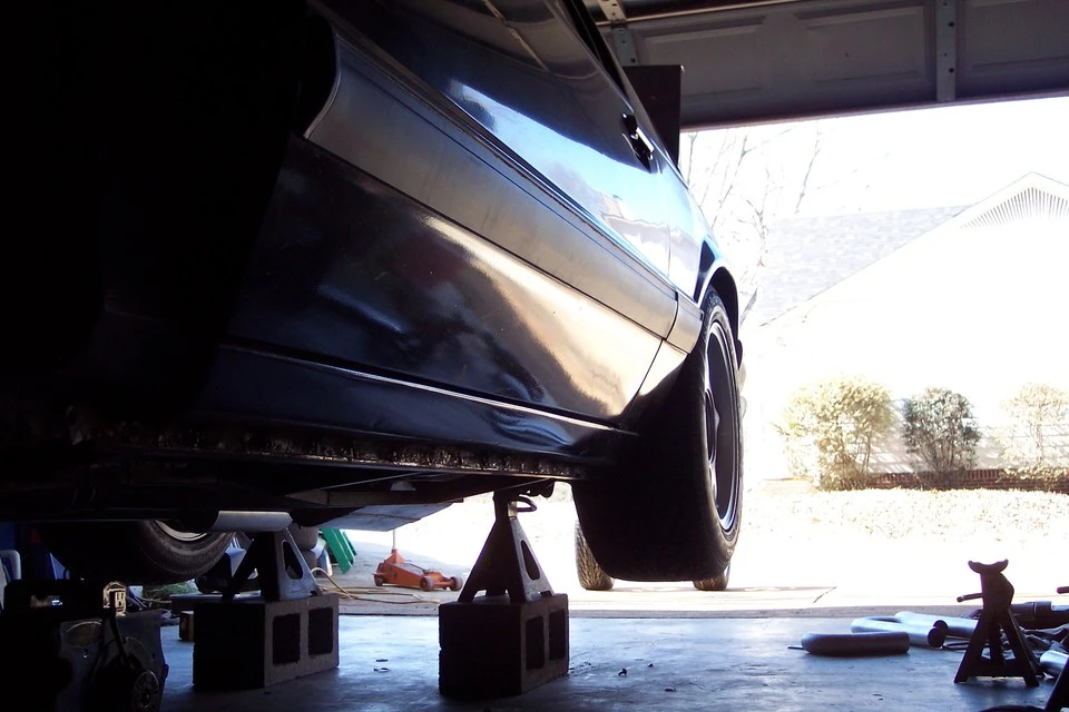

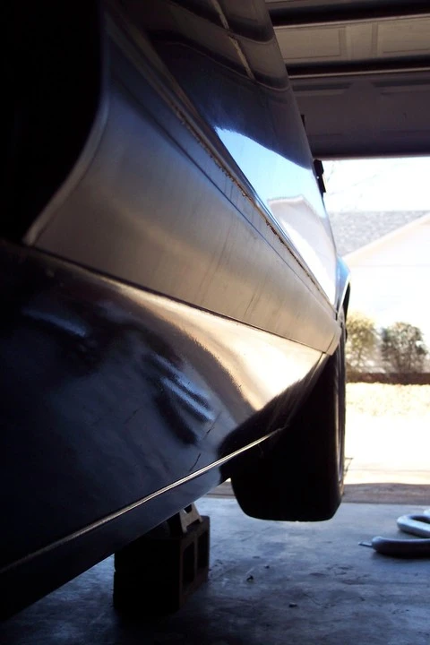

For all of you wondering why I mini tubbed it, the attached pictures will show why I did. but for the record, I knew that the wheels I bought were backspaced way under the quarter.

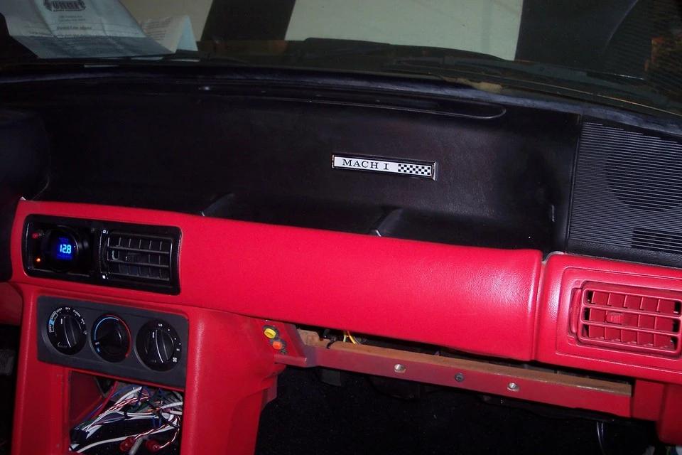

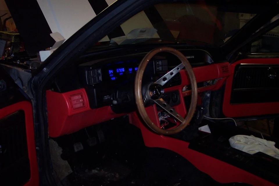

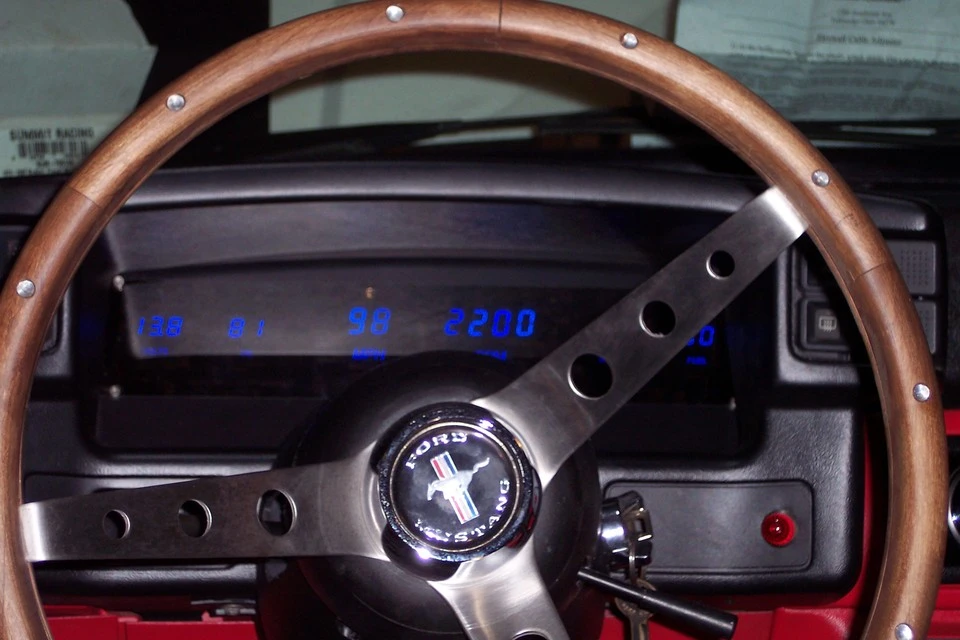

I also got to work on the interior today, put the dash pretty much back together, got the gauges working again (ck out the speedo, the car is on blocks in neutral)
Now I put every picture on its own line, so if this still isn't the way I'm supposed to post it you'll have to let me know

Yeah filling the tank might be a slow process. It would look better that way IMO. The tires look good. My buddy has them on his car. The dash looks great with the digital gauges too. please keep up with the pics. Looking forward to those taillight & what you are going to do with the licence plate.

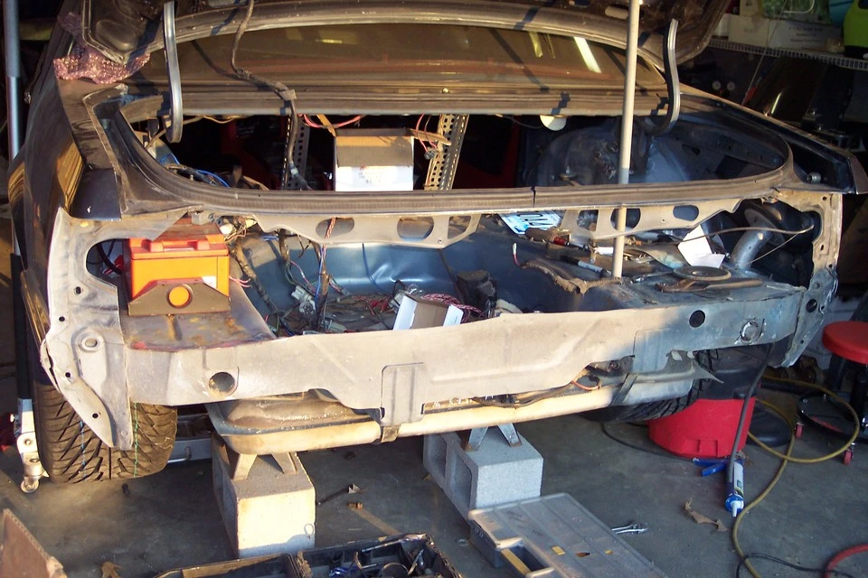

I'm installing the entire rear section, tailight panel, bumper and rear valance.

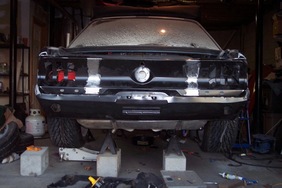

TAILIGHTS!!!

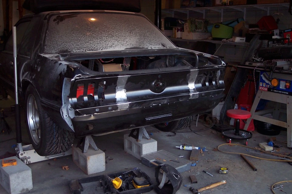

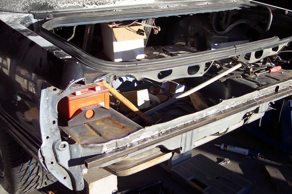

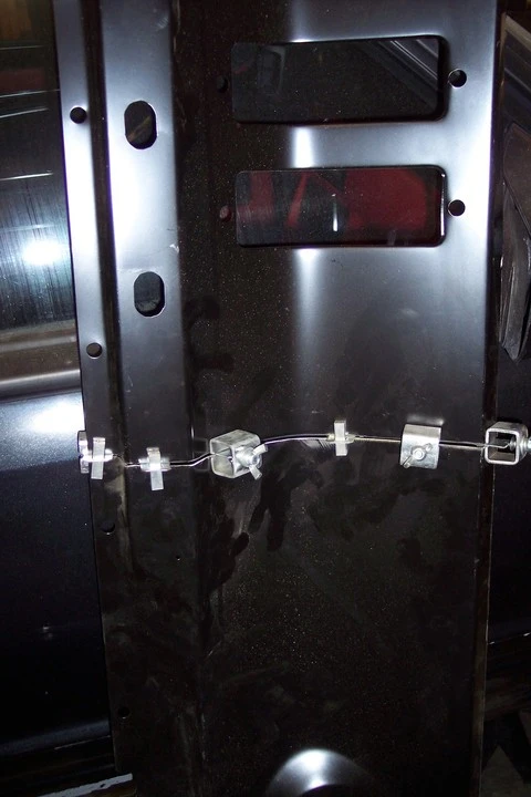

Well it's been a few days. I have been busting my butt to get somewhere on it because I gotta stop working on it for about a month while I recover from hand surgery next week. I gotta tell you, I now know why nobody has tried to put 68 tailights on a fox... It is a royal pain in the ass! AND It's certainly not for the faint hearted.

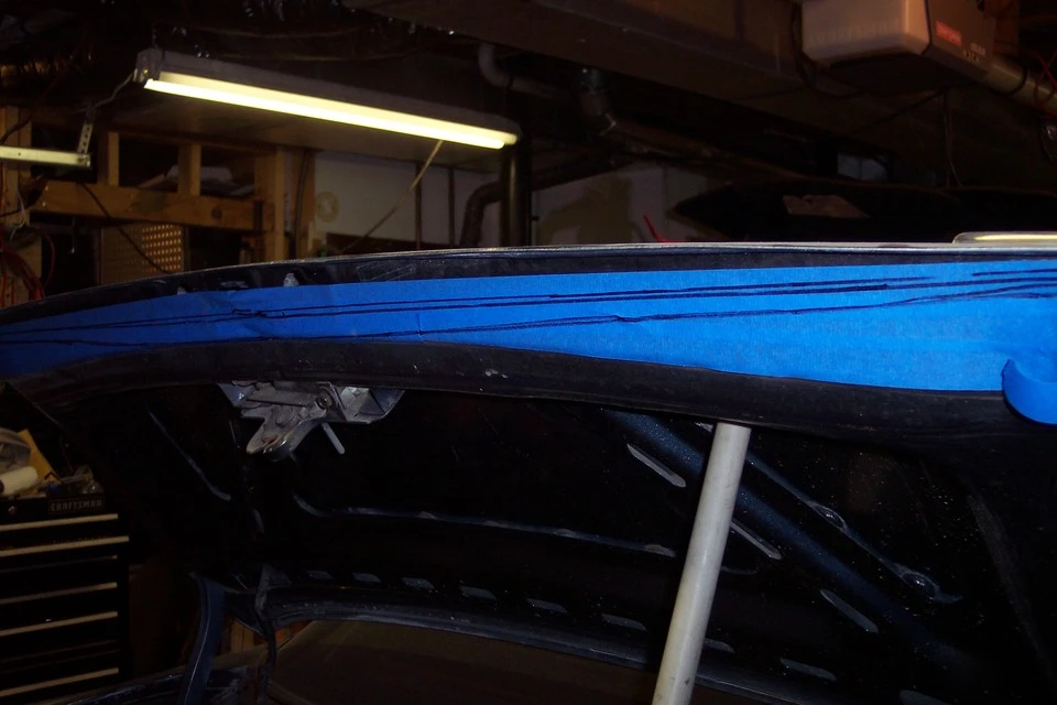

You gotta be prepared to literally butcher the tail section to make room for the panel, The mustang trunk crowns outward, the 68 panel is slightly bowed in. You have to cut the trunk in order to make it look tolerable,....well look:
I had to cut an inch off each side of the panel, you can see the little doo-dads that hold it together so that it could be welded. You see the repair on each side of the panel after its is installed. I'd say I'm about half done.

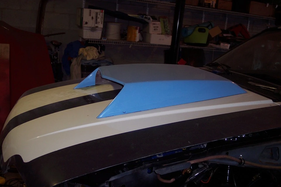

I have been working on the trunk to build the tail spoiler after I cut it up, but until I get it looking better, you don't get to see it. I have even deliberated whether or not to post the pictures of the BOSS'9 hood scoop because its coated in the bogus baby blue gelcoat and it just looks horrible. But it's been fitted and it only needs some light sanding and black paint, so maybe you can look past the miserable color.
