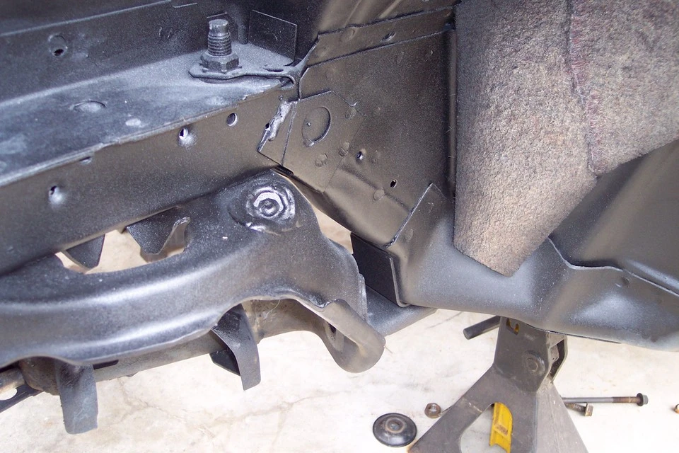

Great work, very clean, I have a question on this picture:
Is this some kind of matting? I cant really tell what part of the car this is, looks like a spring perch but some matting like that would look clean along the firewall, like it comes factory on some new cars.
that "matting" is whatever the factory put on the wheel well. I know It'll probably have to go because it was originally behind the inner wheel well panel and not intended to get wet.
