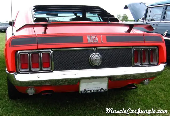

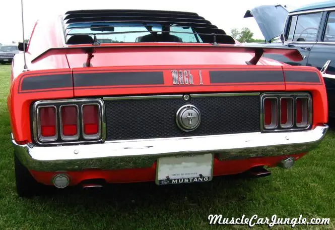

Yes. Do it like this....sort of. This is what my 70 looked like. No sides. EDIT: from looking at old pics, the 69 went down the sides and the 70 looked like this. I prefer the 70, but I'm partial, I had one.

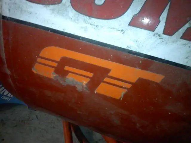

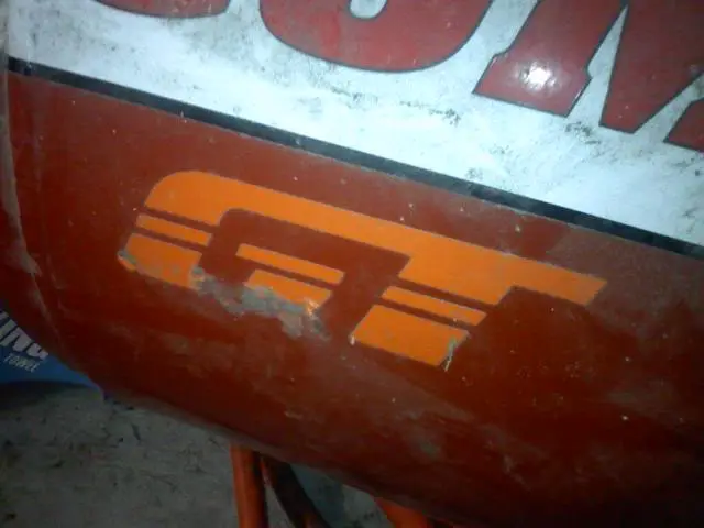

I had about eight of these peel and stick decals made for an 84 GT I built. They were done in in two different sizes and in orange and black. For $20.(obviously didn't use them all, this one resides on my compressor)
When I asked the guy if he could make them, he said, you dream it up, I'll make it.:shrug:
A buddy of mine who's into sport bikes has been using them for years as well. Suzuki wants a fortune for decals, my buddy gets the whole bike done for 20-30 bucks.
