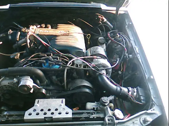

Finally done my turbo!
Well took quite a while but its finally running. still a few minor things to do still.
Basically stock motor, 306 rebuilt shortblock, nothing fancy. 1.7 roller rockers I ported the intake and heads myself. Numbers from the dyno are 412 hp and 507 tq to the wheels.
I think the most enjoyable thing to do is when an import comes up next to me and starts spooling his turbo, then I spool mine and just smile :D .

Yeah I basically fabbed it up myself bought a used kit locally when it came up I couldn't pass it up. running between 11 to 8 psi depending on heat, 60-1 turbonetics turbo, hks wastegate, spearco intercooler. I still need to do the intakes upper and lower, I really hate how the stock ones look hehe.

Ok with the new 30 lbs injectors, flex a lite black magic fan, I paid to have the intercooler piping made up new 255 lph fuel pump, the used turbo kit, new braided lines and hardware for the turbo oil lines, used 130 amp alternator for the electrical fan, battery relocation kit, baffles welded to one valve cover for the breather. and extra exhaust piping I needed I spent around 2800 dollars including all the extra hardware and hose needed.
I think I did pretty well since most turbo kits seem to run around 4000-5000 dollars alone.

Jwalsh: I can't tell from the pics, but did you use the stock headers, or something else? And aren't you worried about the coil wire being that close to the turbo? Those things do tend to get kinda hot, I believe...
I have the accell extreme heat wires, not really a problem. I do have to lengthen my MAF wires though, just finished the build and didn't want to waste time to lengthen them just yet hehe.
And I have the Motorsport ceramic coated headers, brought a tear to my eye when I had to take one off to make way for the junky turbo header.
yea it looks like those MAF wires are hacked in there..hopefully youre gonna fix this with proper connections and wire? other than that the numbers look outstanding for what youre working with, keep it up!
