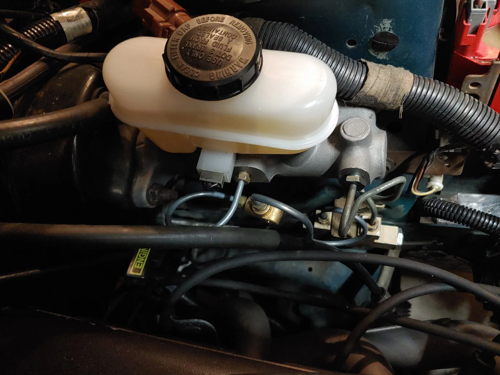

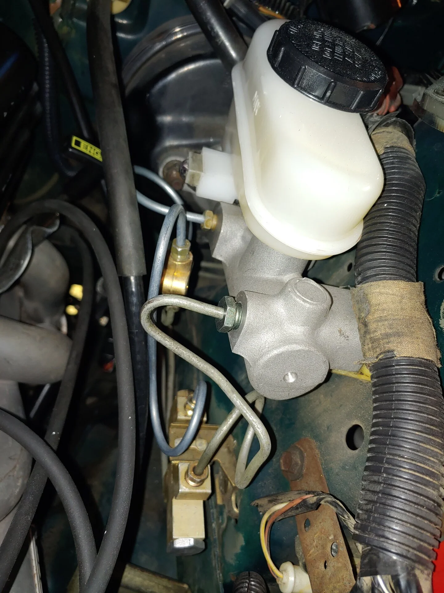

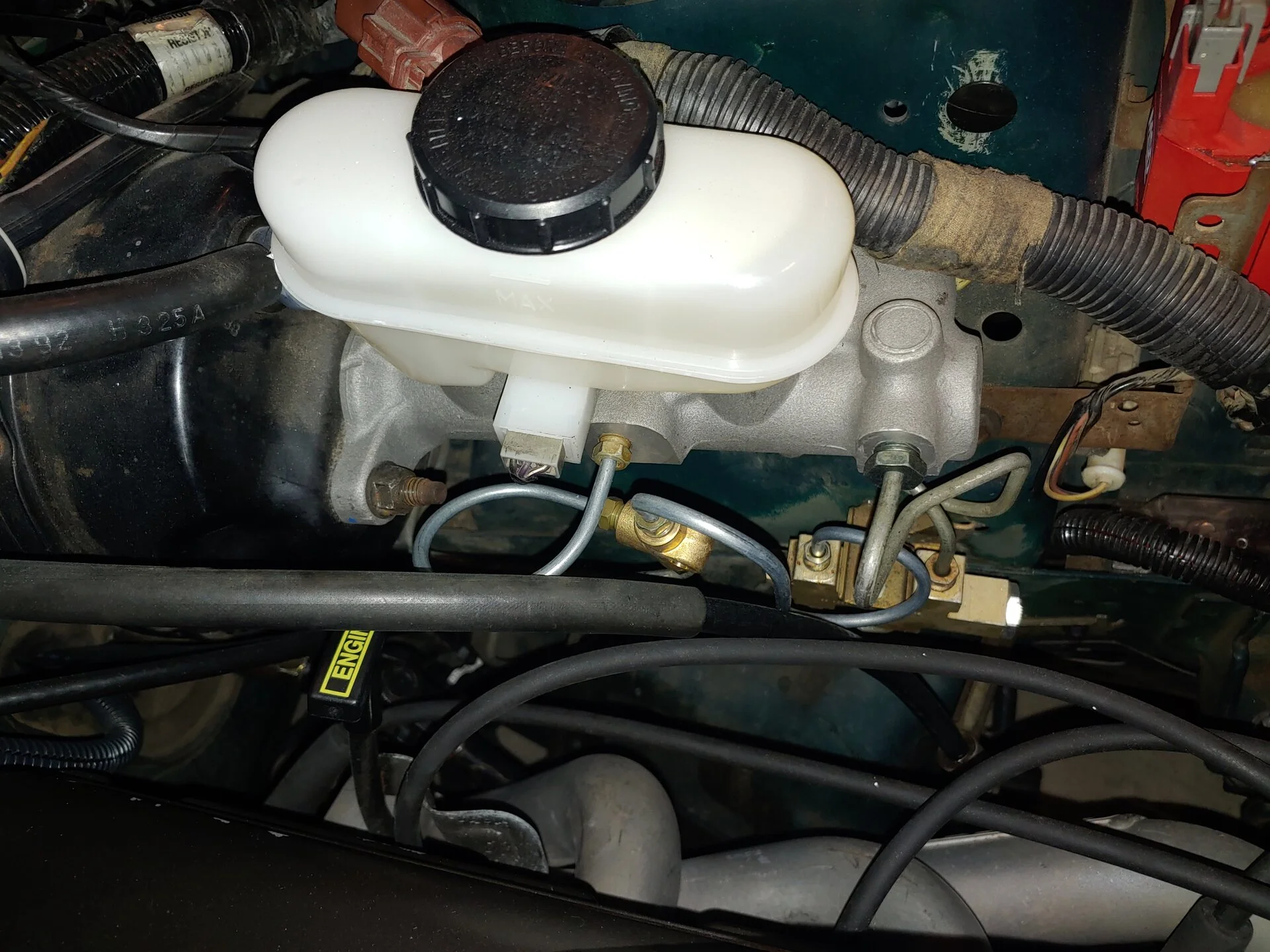

Definitely looks like you have just the stock master cylinder.
You could make-up a short line for the front, you can get different lengths
of brake lines with the ends installed from any auto parts store.
Not sure if the 94-94 m/c is better or worse , I do know that it is suggested to also change the
booster when upgrading for better pedal feel.
Seems to be hit or miss, some people report issues without a
booster change some don't. I took my chances and did not change the booster, so far I'm happy with my set-up.
included a couple of pics for your reference.

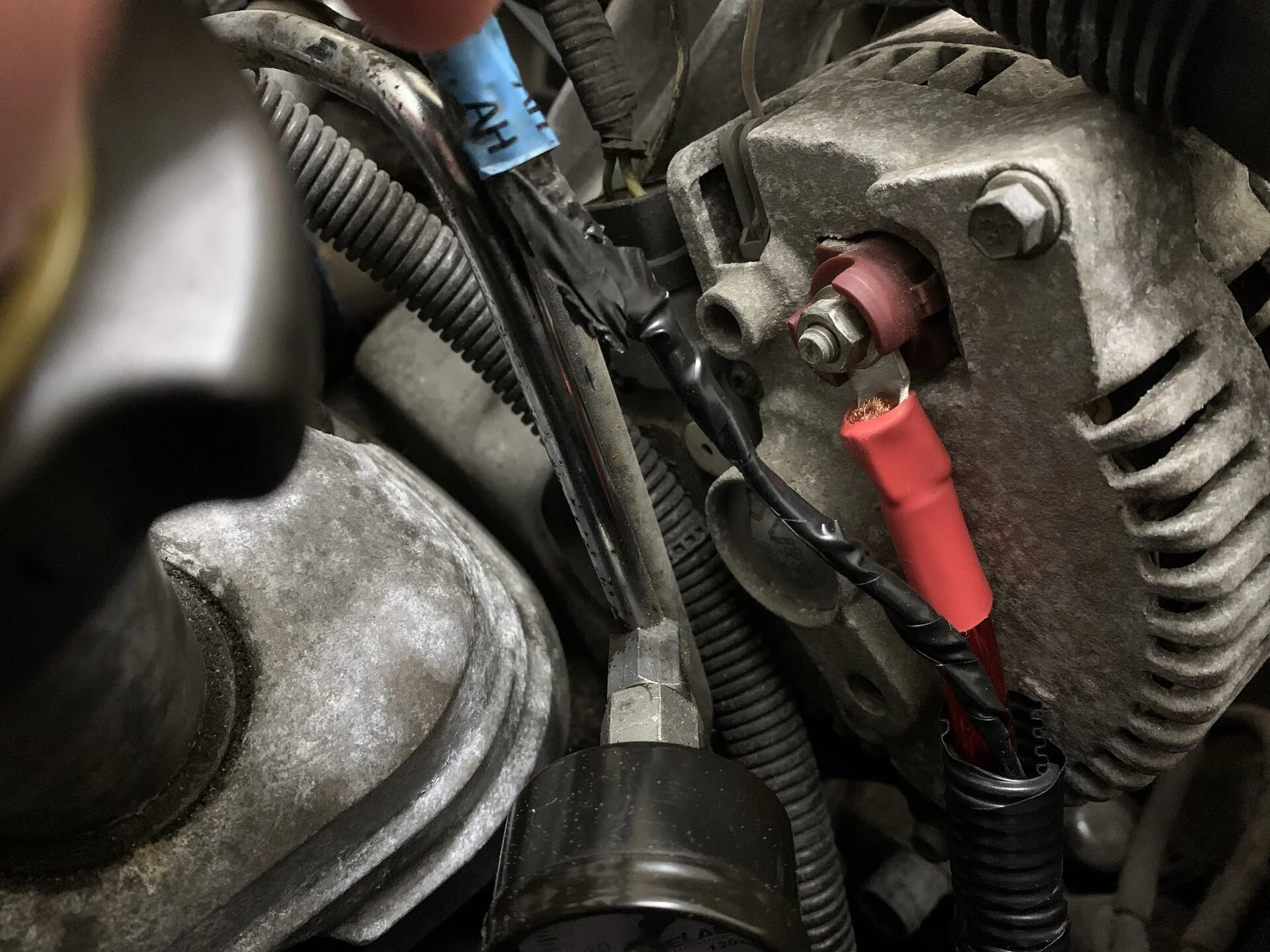

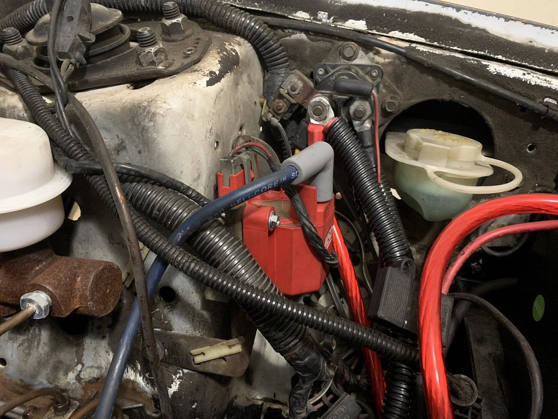

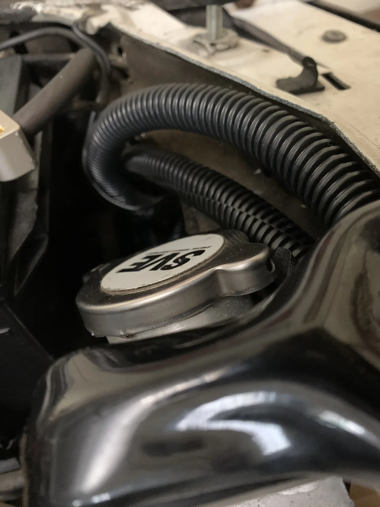

Happy to report that I finally got the alternator power cable finished. I ended up running the power cable in one loom and the rest of the wires in a separate loom. It took a while but I got it looking how I wanted it, for the most part. I might need to redo the tape around some of the clips but for now, I'm pretty happy. Thanks for all the tips on that part especially. Trying to get both looms to sit well and fit underneath the battery tray took the most time.

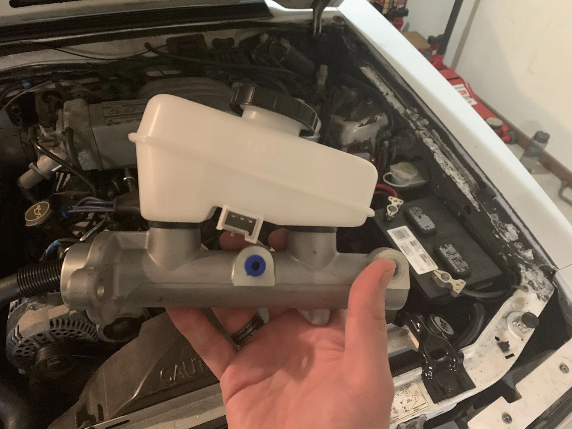

I went ahead and ordered the 93 Cobra MC and installation kit. I'll try and figure out a solution for the front port line when the time comes.
Nice work on the alternator wiring, looks good.

I went ahead and ordered that kit. Supposed to arrive today. Thanks again for recommendation. Also, Cobra MC and installation kit arrived last week. I still need to pick up some flare wrenches and brake fluid. Hoping to start working on this soon.

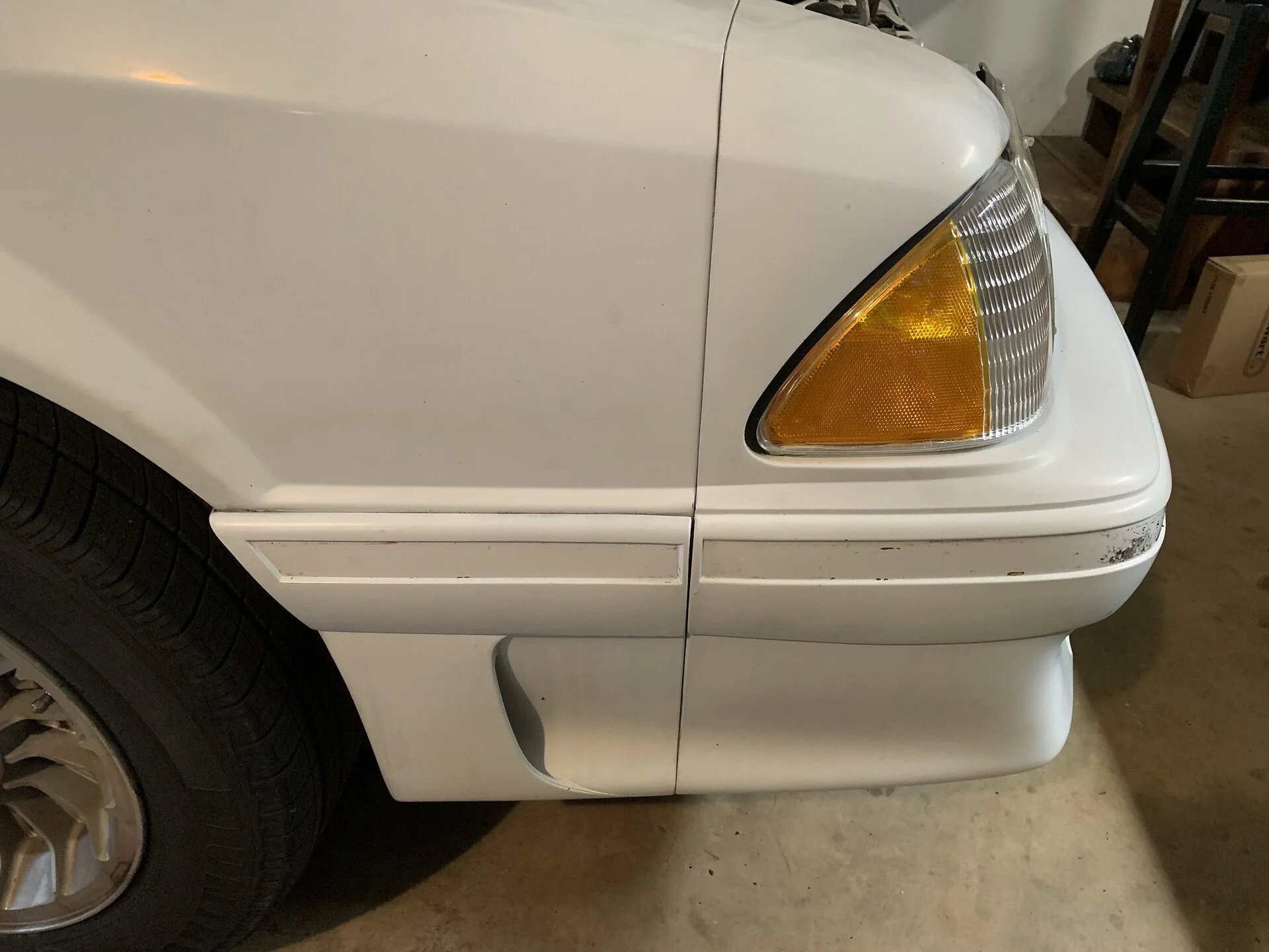

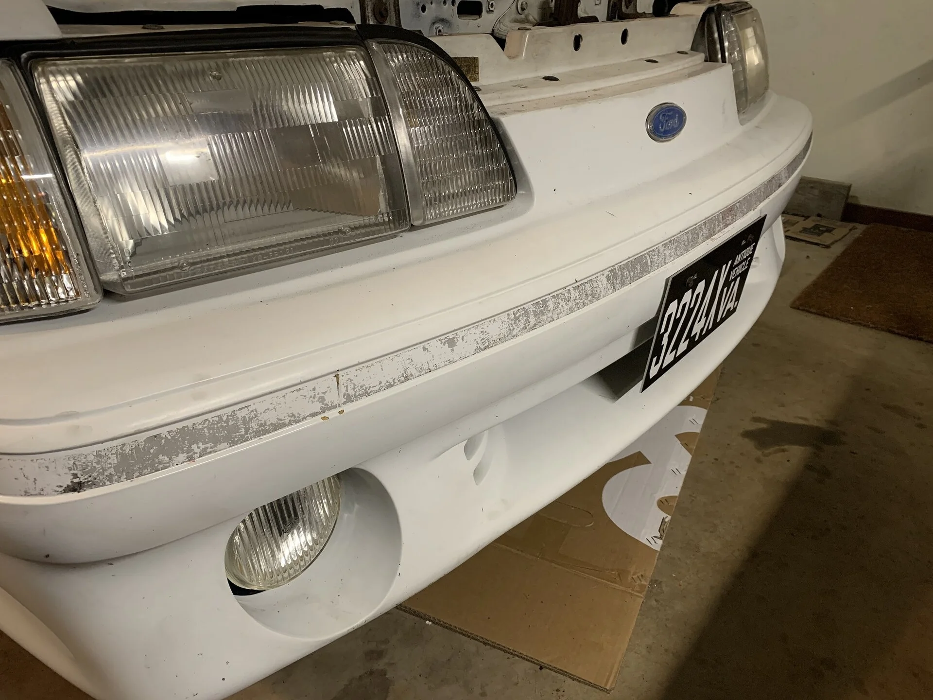

In the meanwhile, I've made some progress removing the gray residue that was underneath the body molding stripe. Also used some touch up paint on a few spots that weren't looking great.

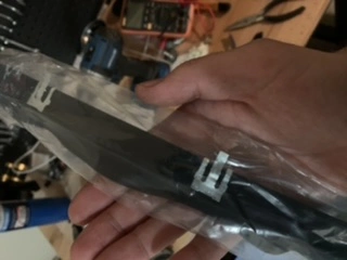

Hey Olive, did the new one come with the metal clips..... I’m pretty sure i damaged a few of the old ones taking it off.
The firewall to hood seal didn't go on super easily for me...at least not compared to the LMR install video, lol. It seems it needs to be bent around the hood hinges. I was thinking of buying the new hood hinge cups and replacing those, then doing the firewall to hood seal while the hood is off the car. I made a video that partially documents that failure...

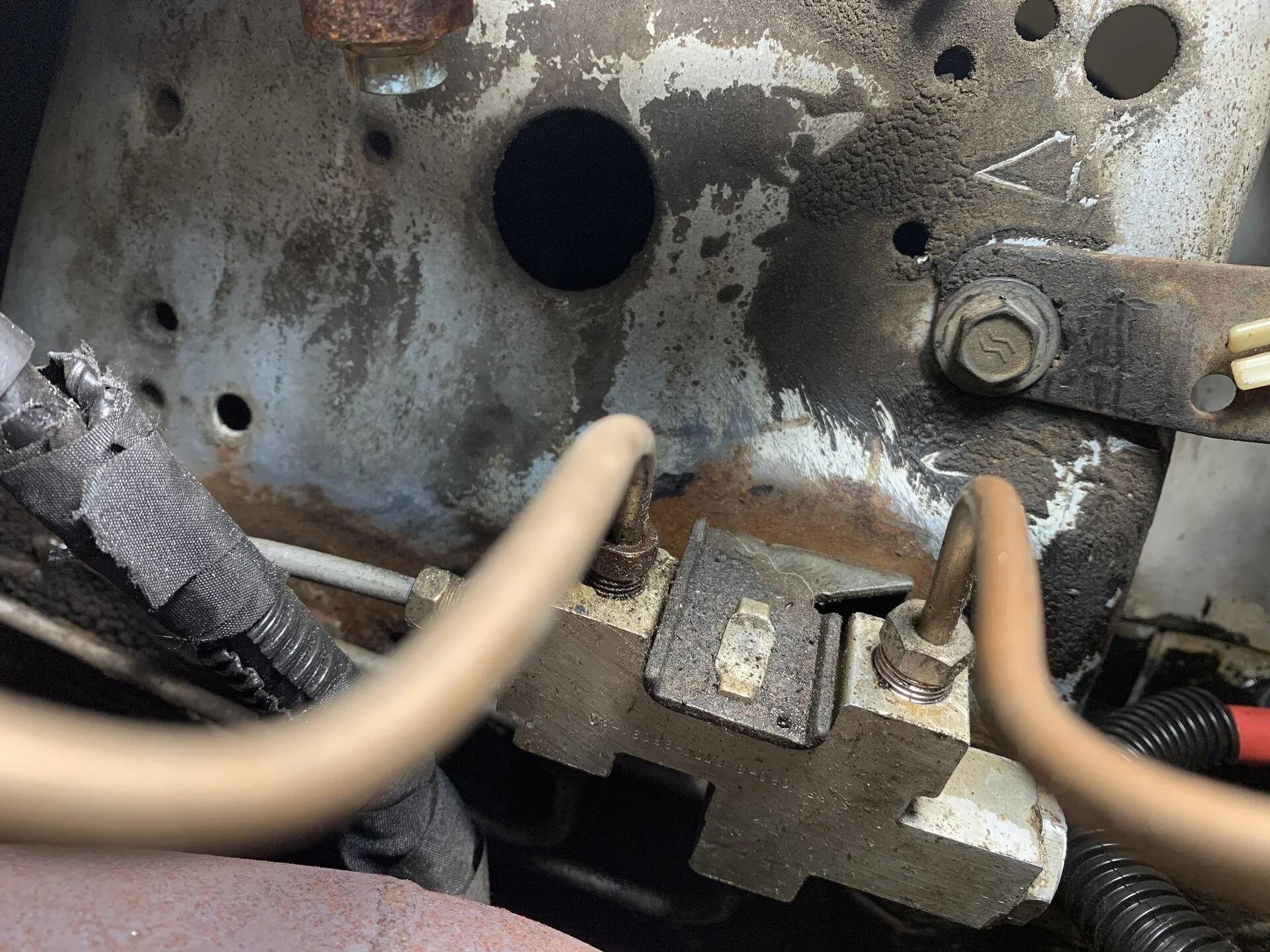

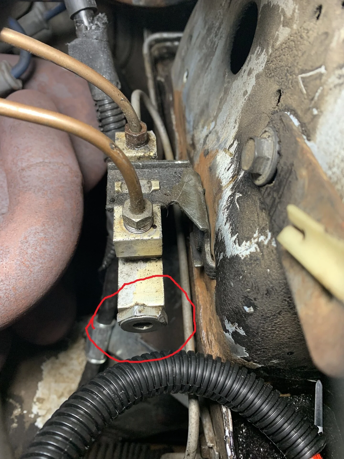

Hey, thanks for chiming in. I hadn't seen that specific piece before. So...here's a pic of my stock proportioning valve as it currently sits.
Is the piece circled in red basically the same thing as the valve plug you suggested?

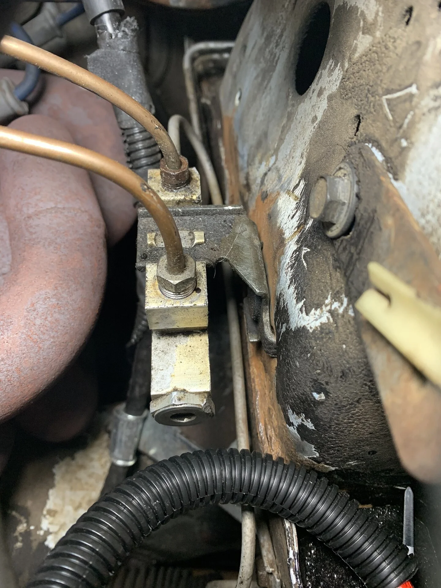

Yes, that’s it. Remove that, pull the shuttle and spring out and install the new plug. If your existing plug is in good shape, you can reuse it instead of buying the MM part.

In order to use the factory plug you'd have to drill and tap the end, where the rubber grommet is, and install a plug. A 3/8 pipe thread tap and 3/8 plug works well for that. It looks ugly though...and as cheap as the aftermarket plug is...its worth it not to have the hassle. I bough mine from LMR. It didn't come with a new o ring so I used my old one. It goes at the end of the threads by the top of the cap.
