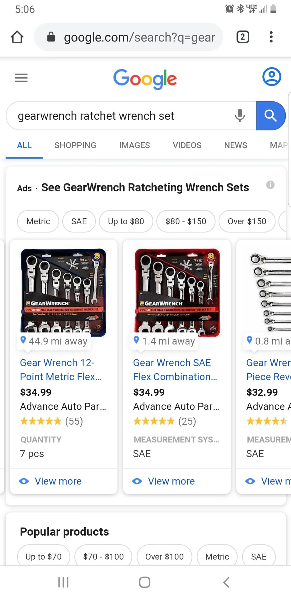

Gear wrench?
Gearwrench...I've had a set of these for 15yrs. Only had to replace the 10mm and the 13mm out of both sets.

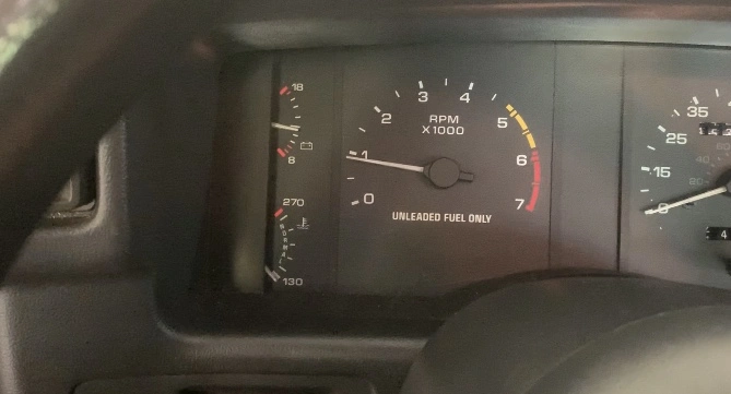

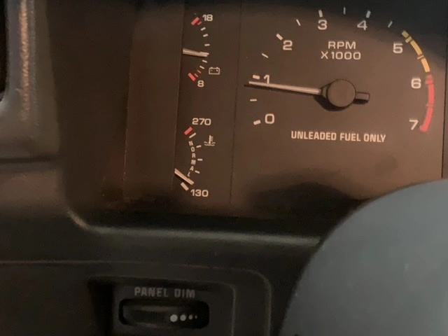

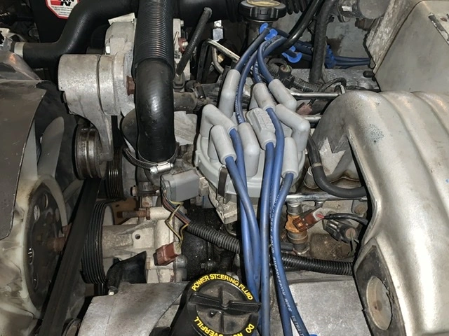

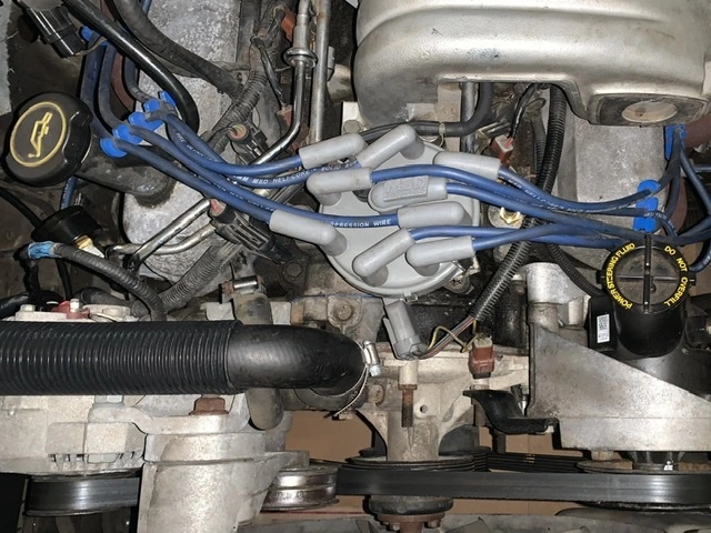

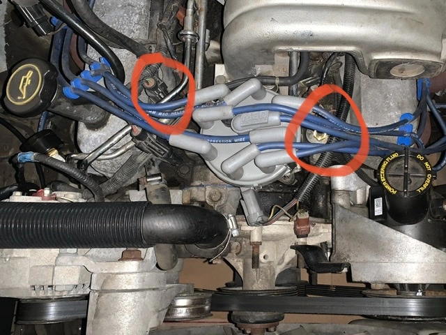

So my temperature gauge doesn’t work. Today I replaced the temperature sending unit today and that didn’t appear to do the trick. I did some searching and another possibility seems to be the coolant temperature sensure...though I’m not sure exactly where that is on my car. I looked at a customer pic on LMR and it looked a bit different than mine. These pics are from mine:
3214129A-E755-477B-88DA-12C27D5CF8F8.webp 415E6D80-B19F-4875-BC0D-E3AE3B766AF8.webp
I assume you changed the sender i circled on the right since that’s the one that looks new. Under the connector I circled on the left should be the sensor.
Sender tells the gauge what to read, sensor talks to the ECU and effects how the car will run.
Thanks! Very helpful. Yeah...The one on the right is the one I changed today.

Just watched your resent video. Did you ever find that other temp sensor? Mine was on one of the hard piped heater lines. Left side of the motor. You need to install that new power steering pump. The oil pan is not fun but not impossible. OK gotta go. Leaving work now!

Jump the sender wire to engine ground, turn on the ignition and it should sweep over to hot, gauge is good.
Just to make sure I understand how to do this correctly....would I use an extra piece of wire and put it in the connector end, then ground the other end?

To test the gauge, yes, a jump wire, get two small alligator clips, a piece of wire, mine is 8 or 10" long, and solder a clip to each end of the wire, now you have a multi-use jump wire, one end clipped to the intake someplace ( ground) and the other end to the temp sender wire. Turn on the ignition and the gauge should sweep to hot, turn off the ignition. Gauge is ok. If no movement you either have a bad gauge or a break in the wire to the gauge.

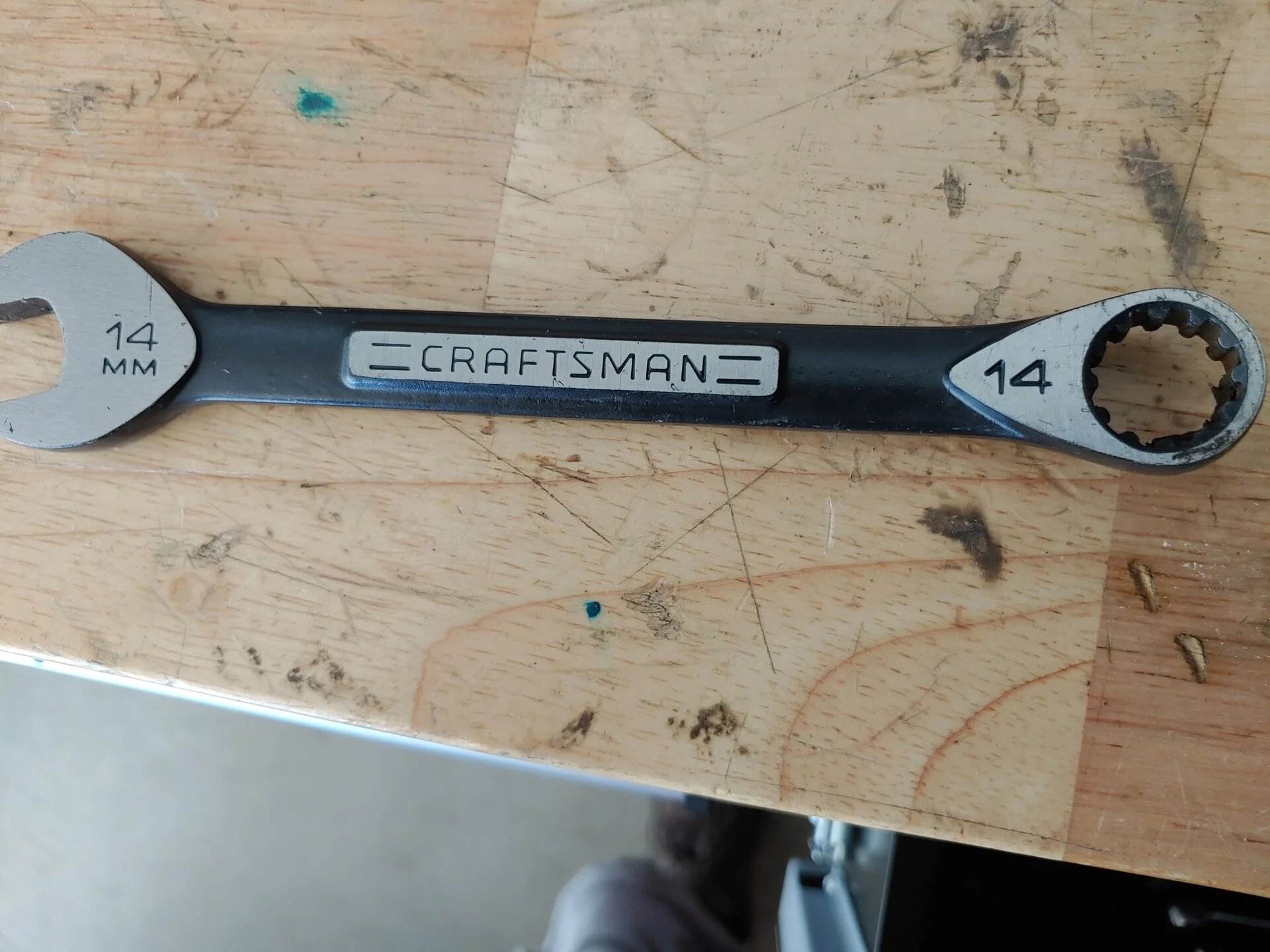

I changed my m/c over the winter it's definitely 14mm although 9/16" would work but it would be slightly looser.
It's sounds like yours is probably buggered up a bit causing a wrench fitment issue, could you get a pair of small vice grips
clamped on it just to crack it loose ? I'm guessing you soaked it in penetrating oil already , if not you should.
I used the closed end of this wrench turned so the arch faces the firewall.

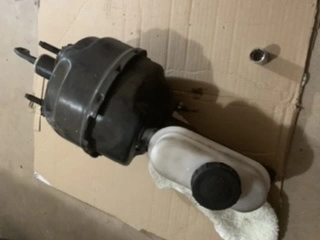

Took forever but I got the brake booster out. First, after I removed the four nuts in the firewall and moved it around a bit to give myself more space to wrench on the impossible nut...still no lucky then pulled the whole thing out and now I still gotta get this damn thing off.
