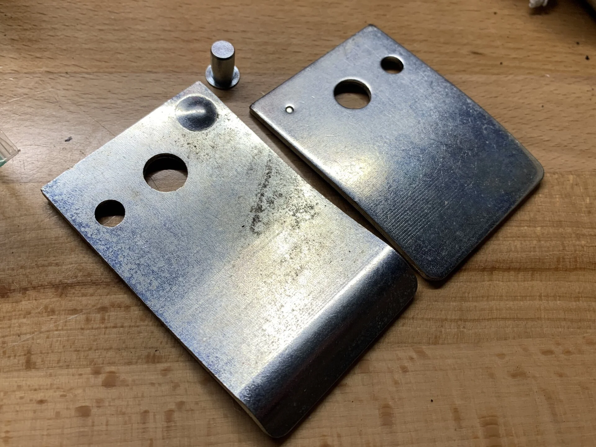

Finally got the driver side door able to stay open, by replacing the lower door hinge tension spring.
The installation video from LMR definitely made this seem like an easier install than it actually is...at least for me.
View: https://youtu.be/RHfewEuIt8Y
Reactions: Olivethefet

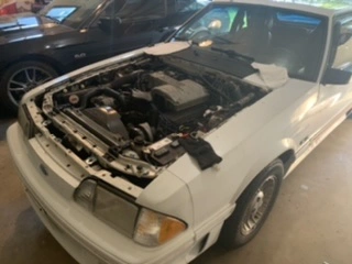

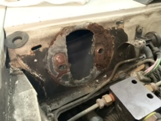

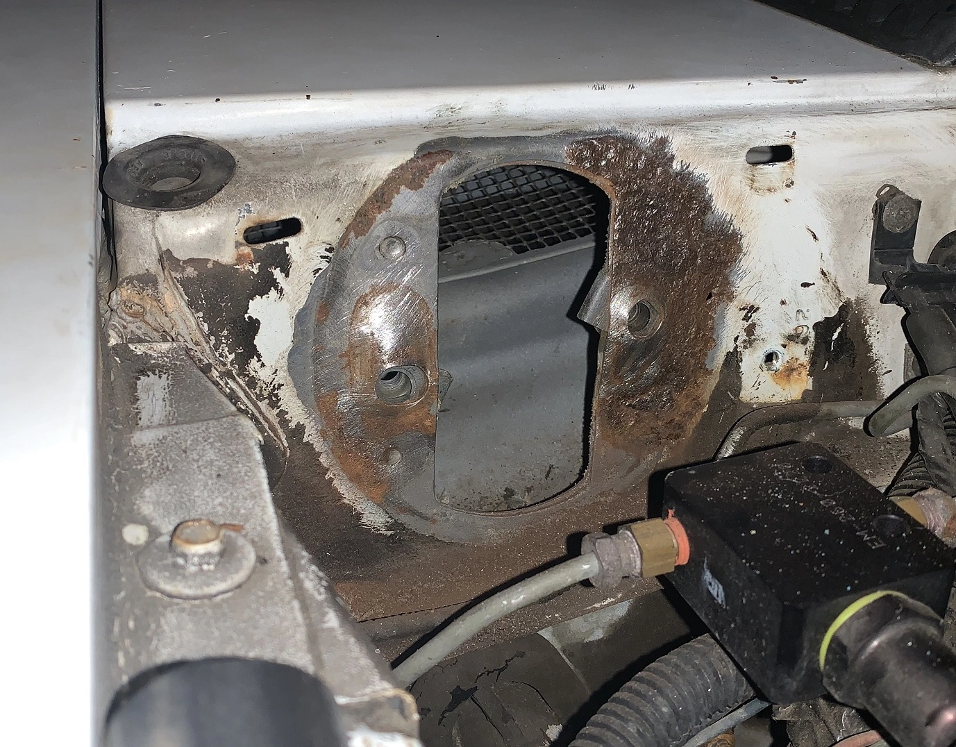

I removed the hood to replace the hood hinge cups and to install the hood firewall seal, but it seems this will make the brake MC installation a bit easier as well.
Passenger side is quite rusted...so I’m glad I decided to replace these.
Driver side isn’t as bad but still needs some work.
I also ordered valve cover gaskets so I’m planning to do those and also clean up and paint the valve covers and intake manifold while I have them off.
Rdub6
So while I wait to figure out my rear end issues
5 Year Member
Dec 29, 2017
3,958
2,939
153
Long Island, NY
Jun 30, 2020
#350
  • Jun 30, 2020
  • #350
DudeStang said:
Awesome. Thanks!
So true, lol
Very helpful, thanks!
Wow..... I guess that rust on the hinge cups was a product of the bad hood seal. Havnt really heard of that being a typical rust spot.
Right? I was thinking the same thing....I need to look back through my pictures and see if the seal was significantly worse on one side because the rust is definitely a lot worse on the passenger side.

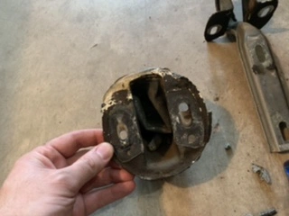

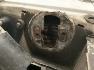

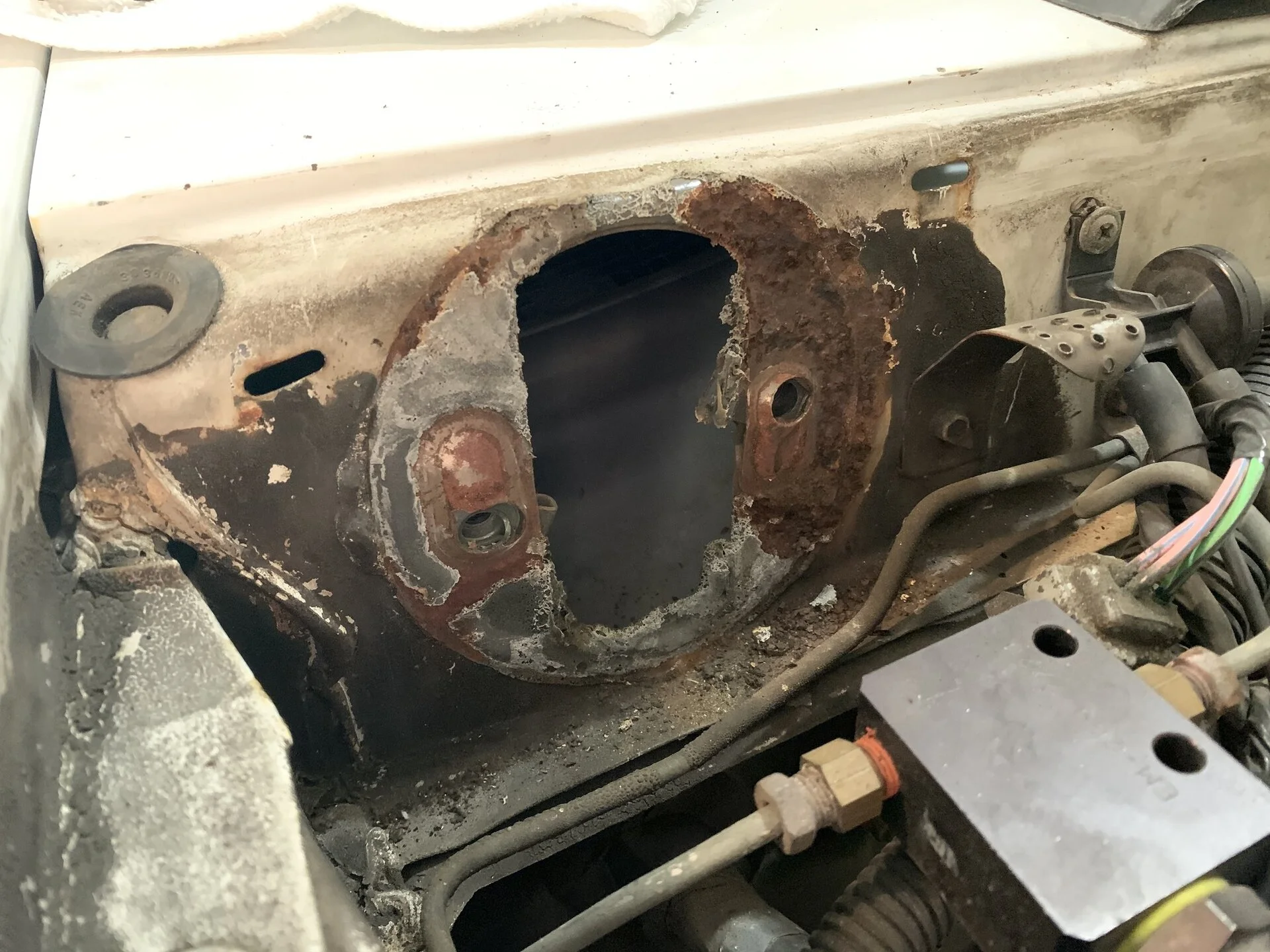

I did a little bit of drill brushing last night. This is the passenger side.
Before:
After:
Still gotta do some more work. I'm hoping the small can of POR-15 I got recently will be enough to cover both this and the shock tower but I guess we'll see...
Reactions: 90sickfox and Rdub6
CarMichael Angelo
10,641
8,909
Birmingham, al
Jul 1, 2020
#352
  • Jul 1, 2020
  • #352
Before:
After:
Every fox body car I've owned has had ( including the current one) significant rust issues in those areas.
Reactions: DudeStang
