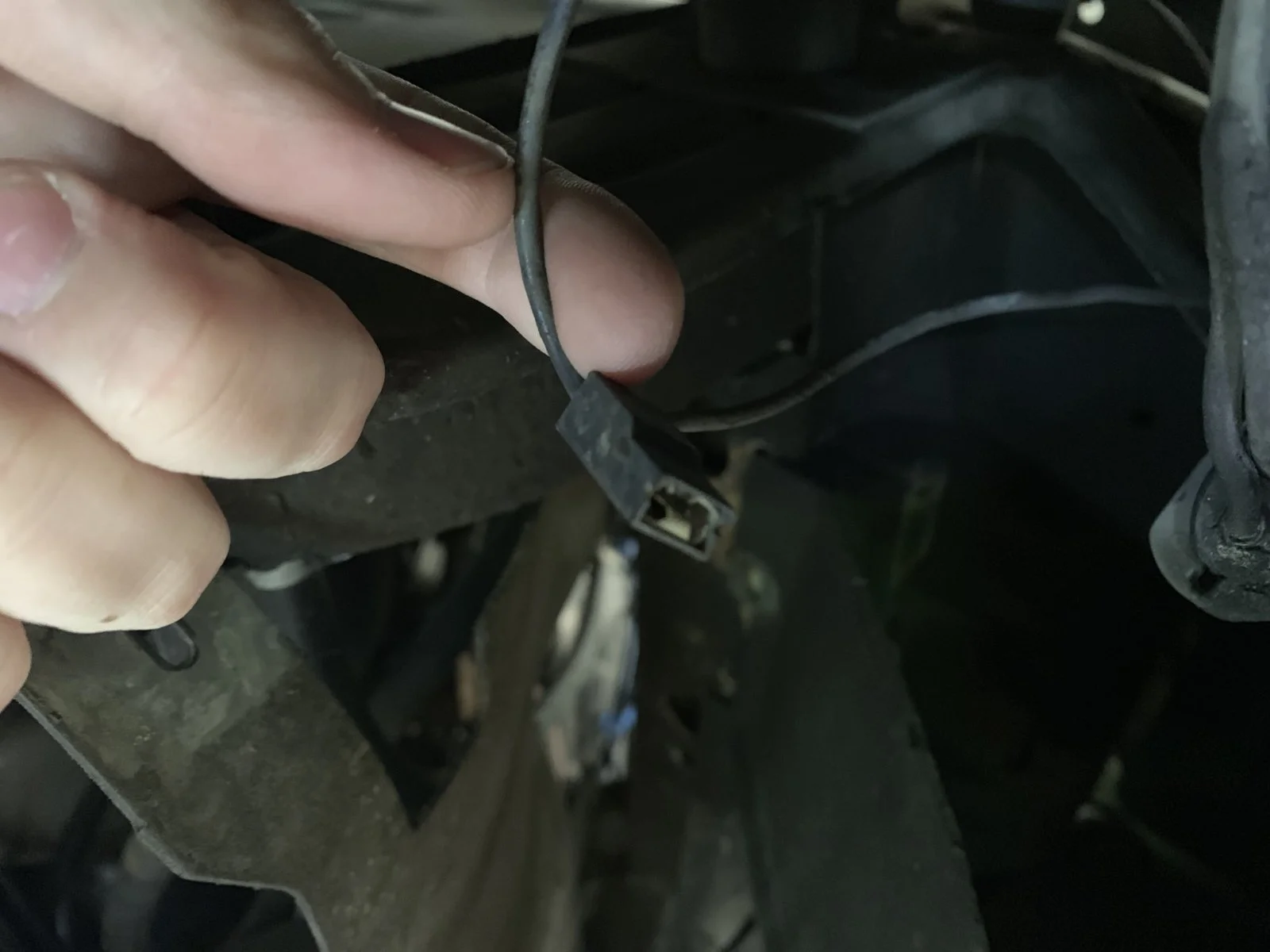

I found this underneath the driver side and tried to see if the horn worked after plugging in one horn and the other. Neither one worked. Now I’m looking at another thread from a few years back where someone had a horn missing from their 1988.

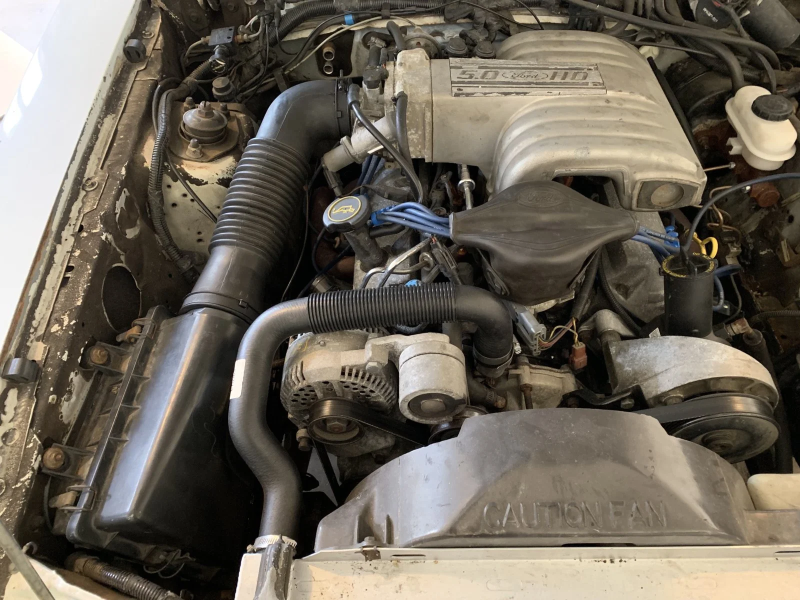

Because I’m a master of procrastination and not doing the thing that I’m supposed to be doing, I put the factory cold air intake back on rather than actually try to troubleshoot the horn issue.
I’d like to get an aftermarket intake that puts the filter in the fender but that can wait.
Throw a K&N filter in that stock box and call it a day. You’ll spend almost $300 bucks on one that you are describing and won’t gain anything out of it. Youll need the adapter that goes where the mass air flow sensor goes if you car is speed density. That thing alone is $70.

That definitely looks like the horn wire. I guess now the question is whether it’s the wire or horn that’s bad?

That’s the right wire. For the horn to work, it needs to be bolted to the chassis to ground it out.

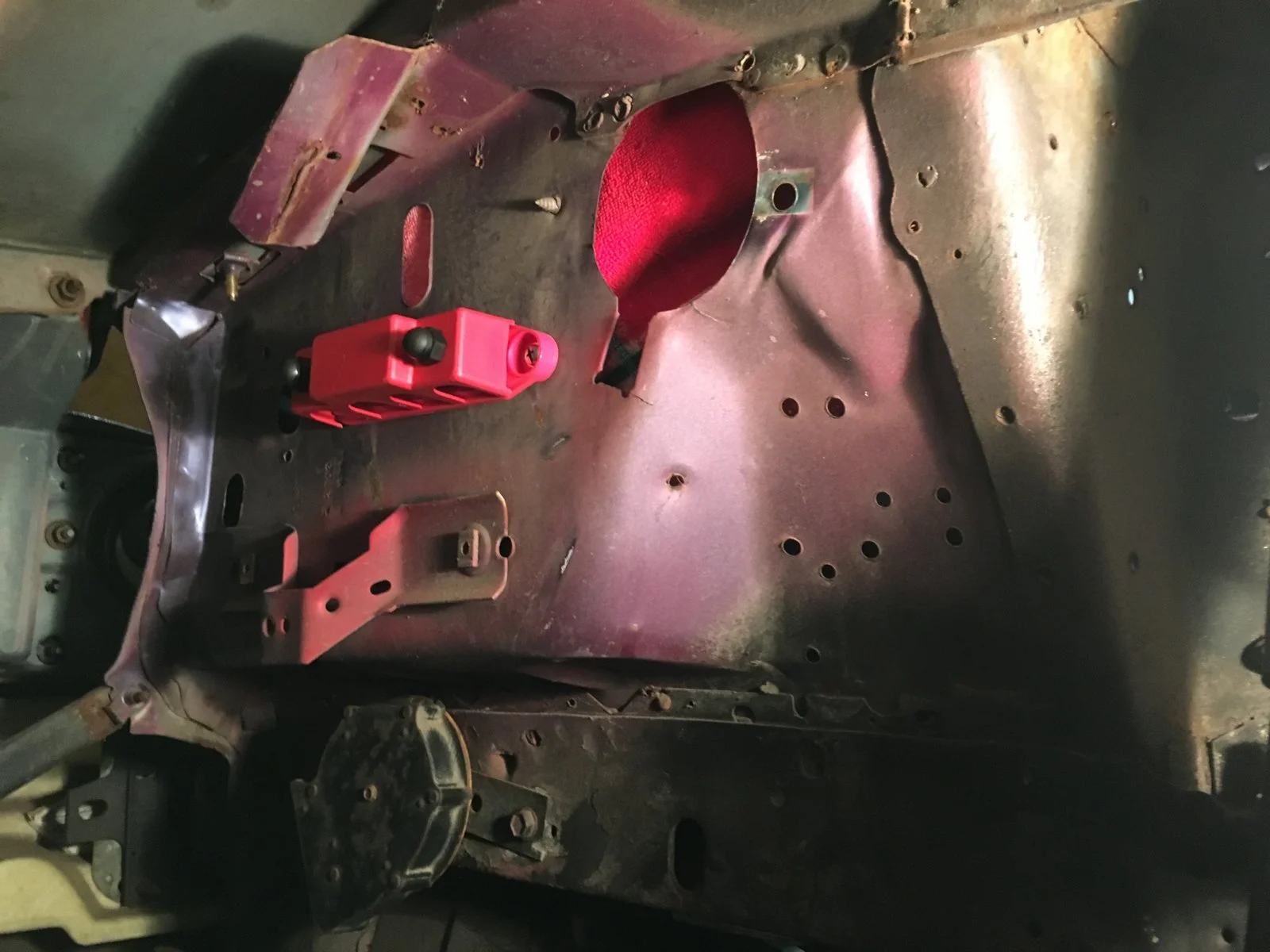

I have the fenders off my ‘88, I can get a pic of the horns tomorrow.

I thought I had found a reasonably priced BBK intake that worked with the speed density setup but maybe I misunderstood the product description.

That would be awesome man. Thanks a ton. I’ve tried to find a few pics online but not seeing anything that really helps me figure out exactly how to get the horns back in, like where/how they are supposed to be mounted.
Thanks! Where is that taken from? I’m an idiot because I’m having a hard time telling...if it’s from underneath looking up or from the side with the wheel and plastic guard thing off
Yes, the inner fender is off in the picture, but you can probably reach it from the front, without removing the wheel and inner fender.

As mentioned, your stock air intake system is fine. You will waste money buying a "cold air intake". Try hooking the horn wire on the horn, hold the horn bracket against the frame to ground it and have someone push the horn button. Maybe wear earplugs while doing this....if that doesn't work it could possibly be the clock spring in the steering column.

Still speed density but you have the 3G 130A alternator.
BTW, both horns are on the driver's side.

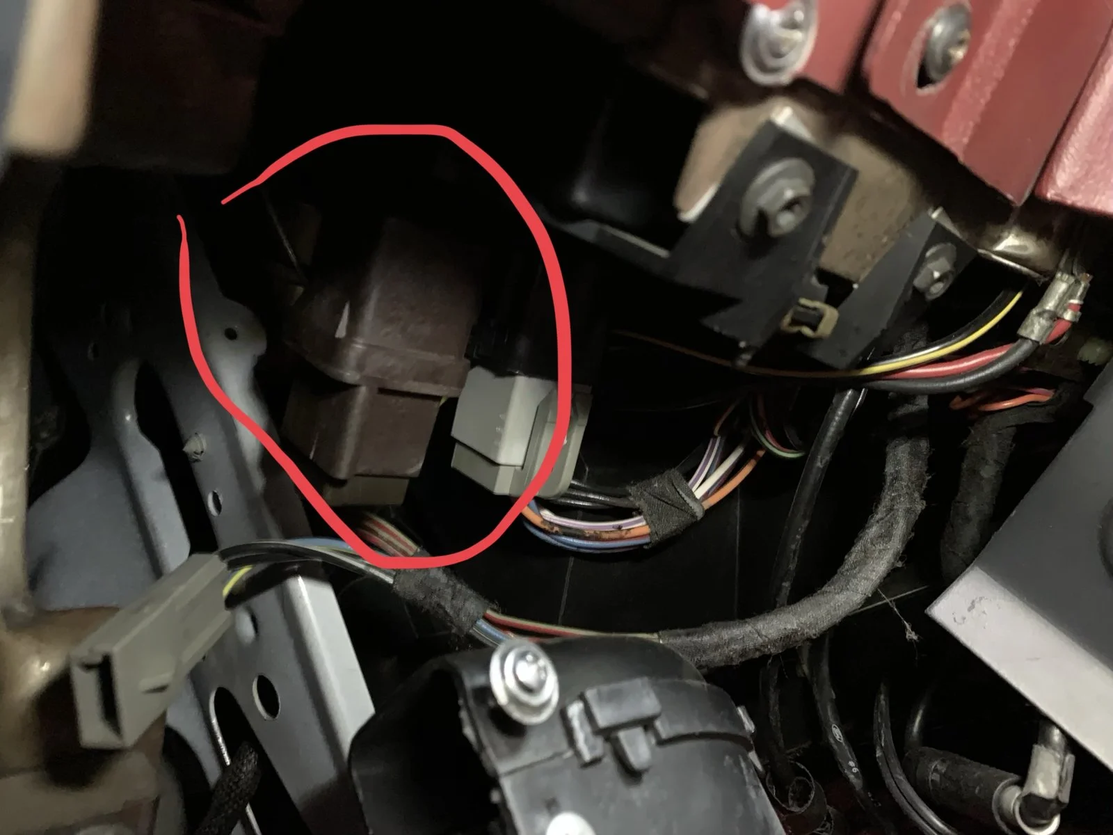

Can anyone confirm if this is the horn relay?
Bad horn pad or relay. Both of which are available.
