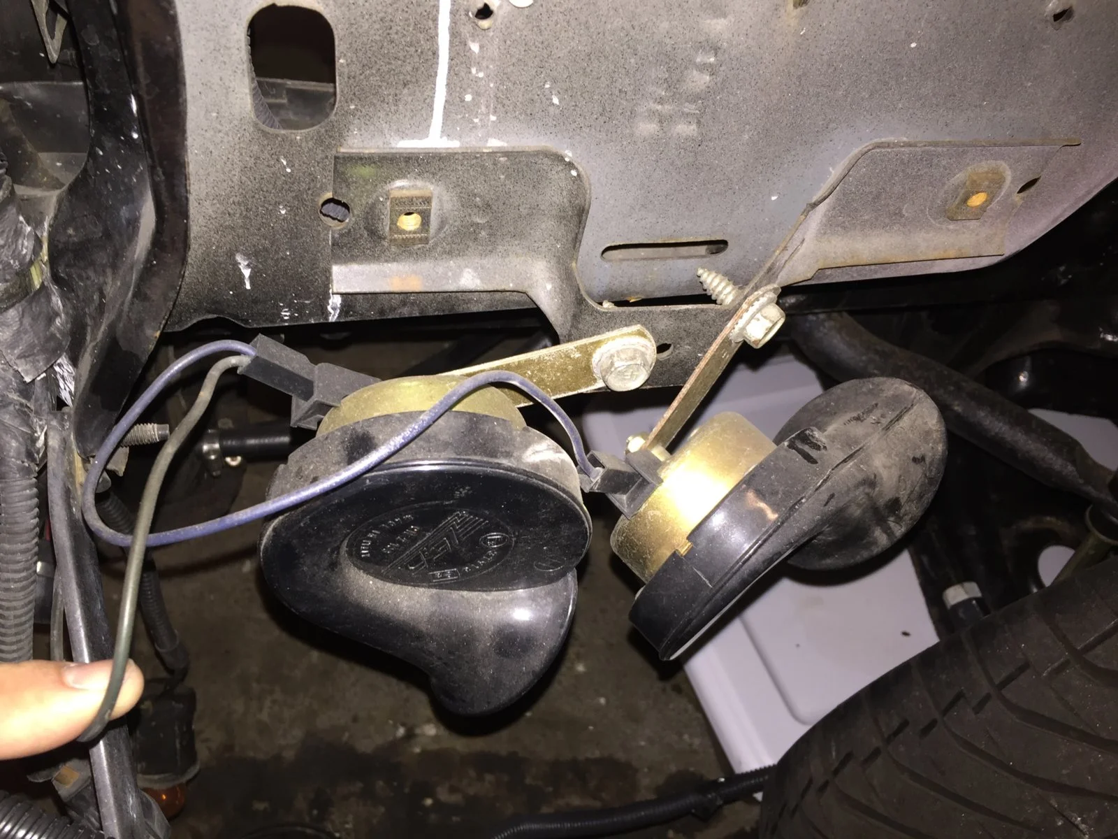

Here’s how the horns are mounted/wired on my ‘88
Power in on black wire, jumps between both horns on purple. Grounded to bracket

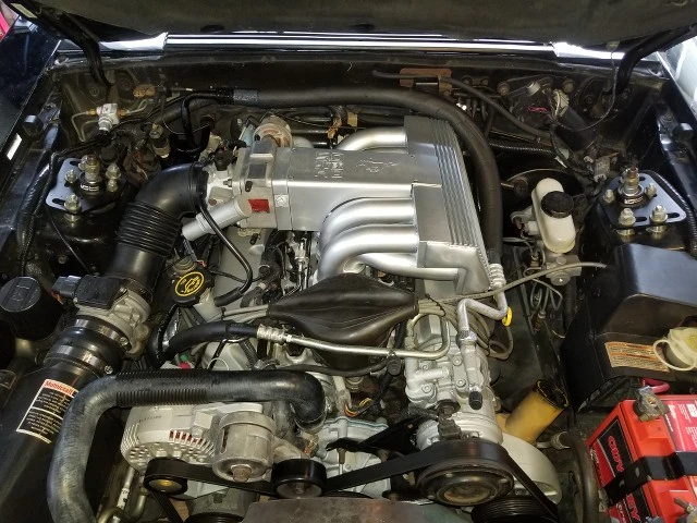

Holy crap that’s a clean engine bay! I love that intake manifold, it looks so badass

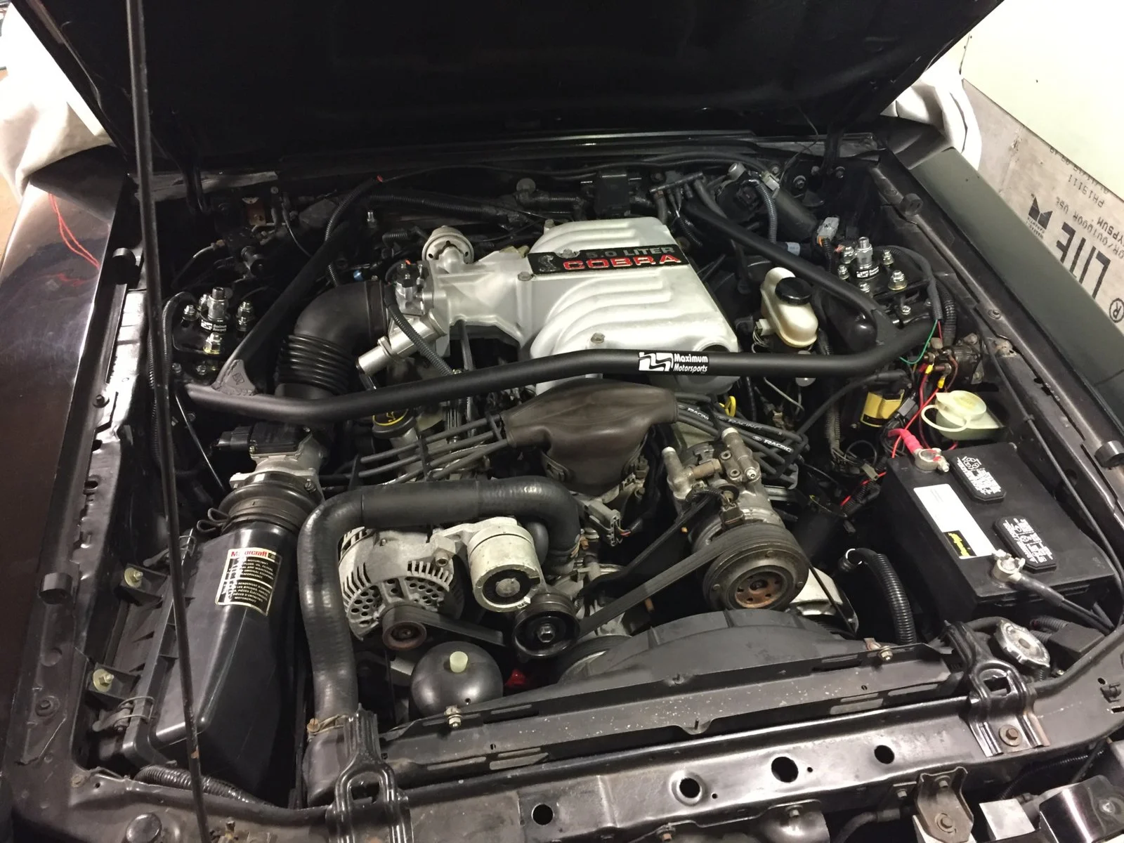

The intake you are asking about is the GT40 Tubular. I have it on two of my cars, my third car has a trick flow. I like the looks of the GT40 tubular personally.
My 90 GT

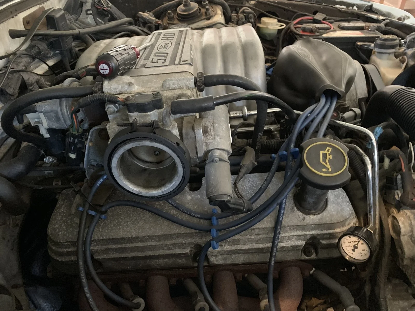

Awesome. Thanks for the additional pics and details. I love the way that looks. I’m assuming that if I eventually went with a GT40 intake, I would have to have my speed density setup tuned to get any real gains out of it?
Nah, not for just an intake. Get an adjustable fuel pressure regulator and bump the fuel pressure up a tad and you’ll be good.

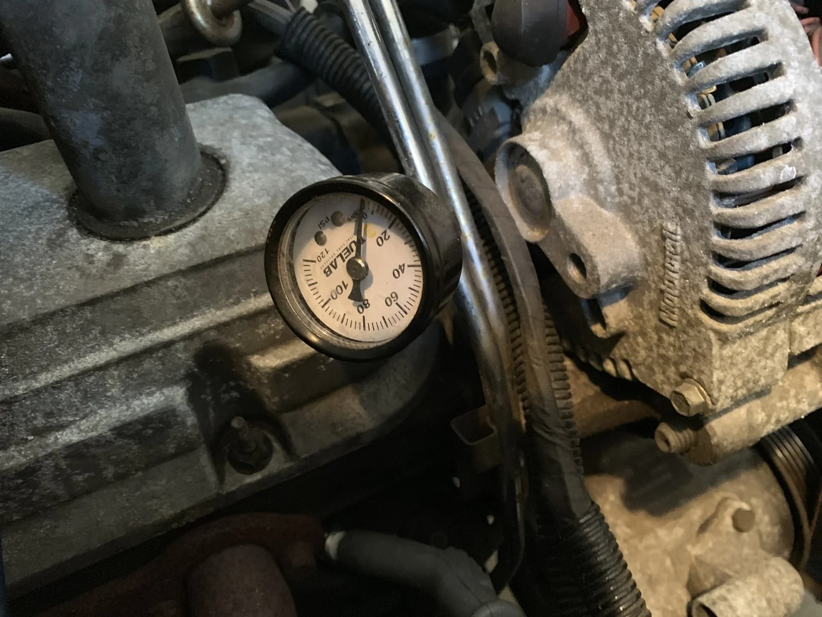

I did notice this gauge when I was putting the stock CAI back on (fuel pressure it looks like?) but didn't notice anything else so maybe it's just a gauge and I still need the actual fuel pressure regulator. Unfortunately didn't have a ton of time to look around as much as I wanted because we had some friends come over.
yes, that is a fuel pressure gauge... it's hooked onto the sherader valve on the metal fuel lines that feed the fuel rails..

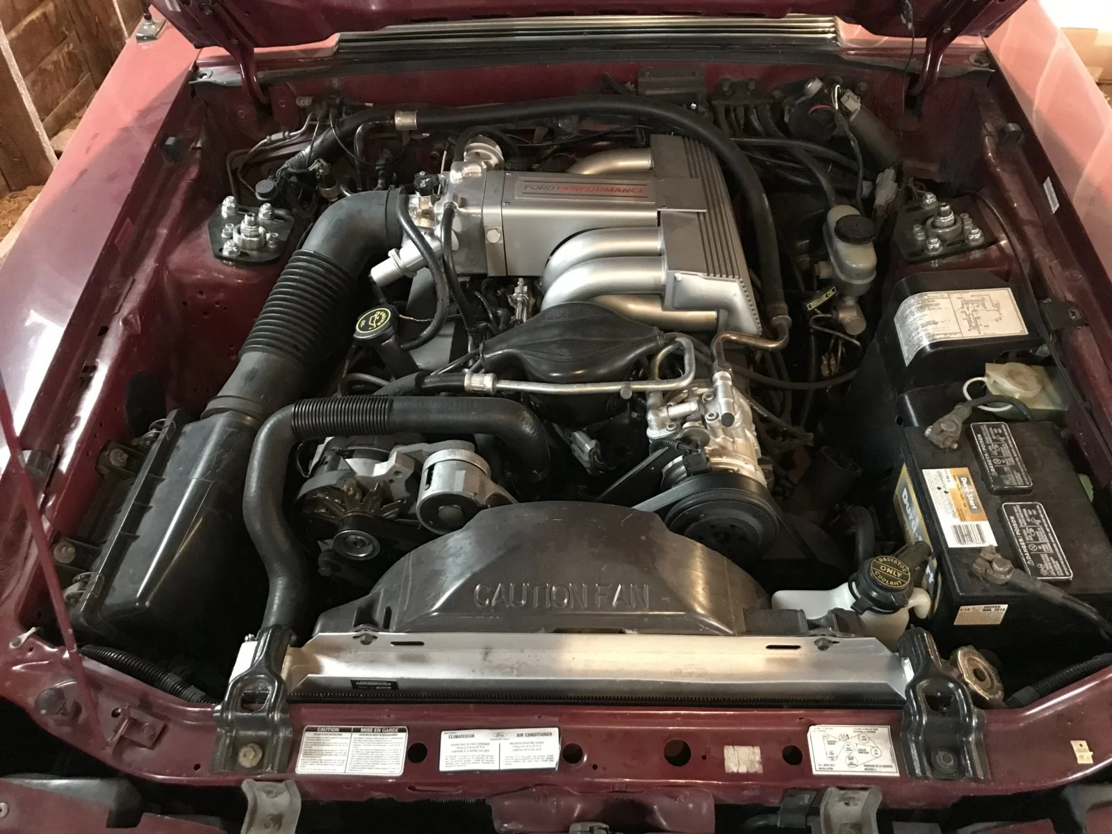

Let's see under the hood. Is it still speed density?
'88's are a transition year, MAF's were California, only.

I'm a little late responding to some of these more specific questions. Obviously by now you know it is a speed density car. Before I got the car I didn't know much about the differences so I've been doing some reading online.

The AC compressor is missing for sure. Looks like the dryer may be over in the passenger side on the firewall. If it isn't getting the parts and fixing it isn't too bad.
That car still has the factory spark plug wire cover on the distributor. Very nice.

To make sure the horns work you could lay the bracket end on the negative battery post...take a piece of wire and put it on the positive post. Tap the wire on the horn where the plug goes. If it doesn't make noise the horn is bad.
