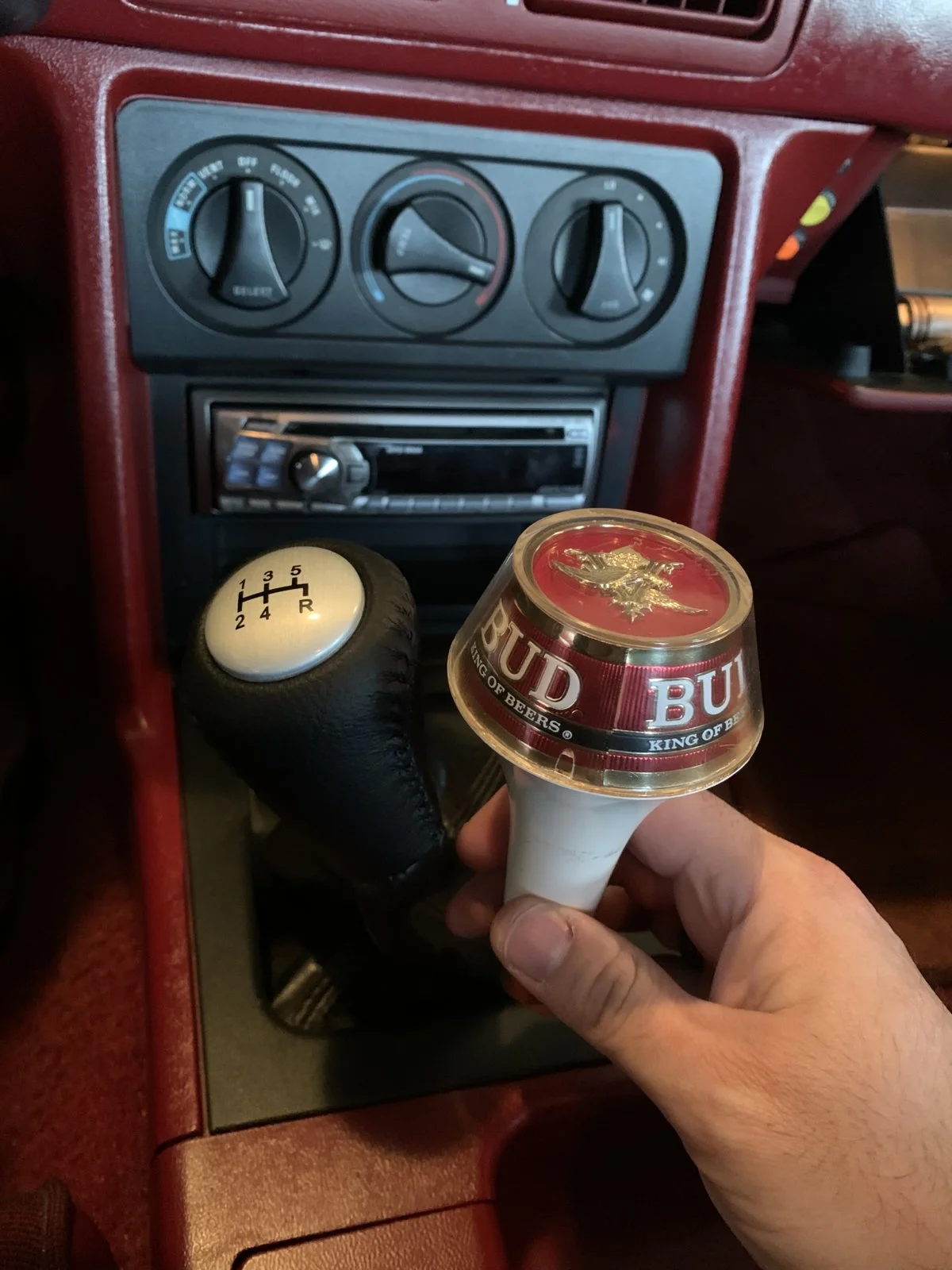

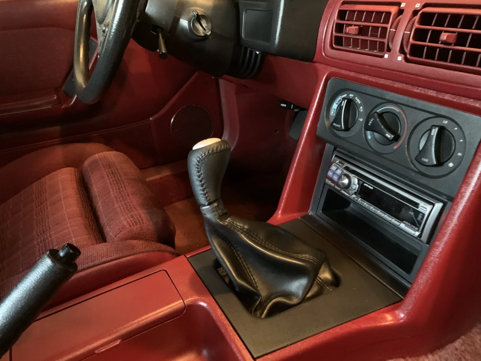

The small box to the right was the SVE 03-04 Cobra style shift knob. It's a small thing but I always loved the shift knob styling in the Terminator Cobras and I think this feels great and looks pretty good in the fox.
In case anyone was worried, I still have the King of Beers shift knob though....I'll keep that around for special occasions, lol.

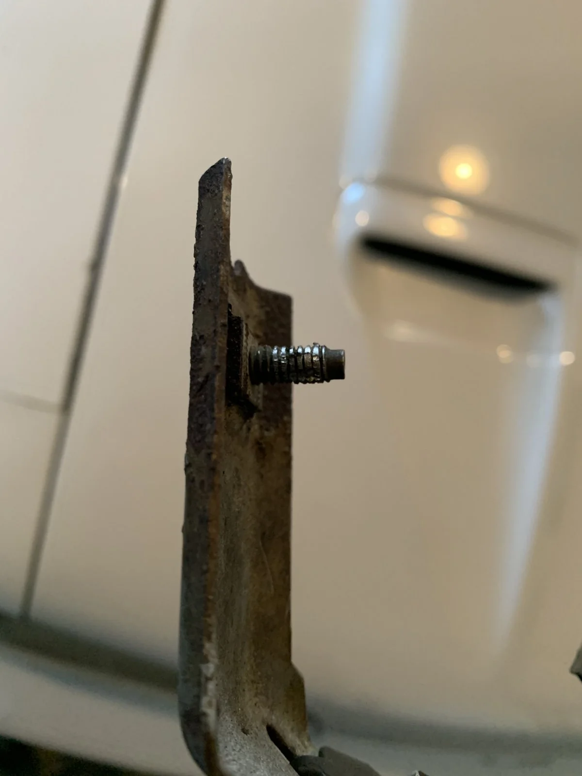

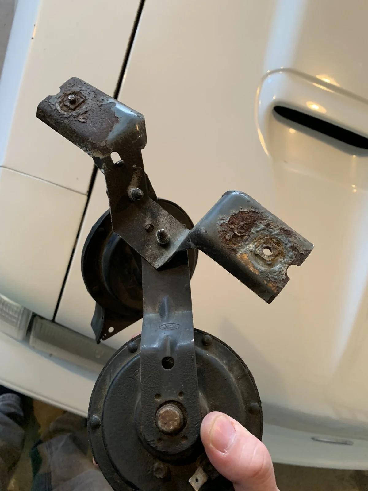

I would just take a wire wheel to that bracket. Then a little prime and paint, and it will look good as new.
Duly noted on the points about cleaning up the bracket...thanks. I don't have a grinder or surfacing tool but will see what I can borrow or make due with.

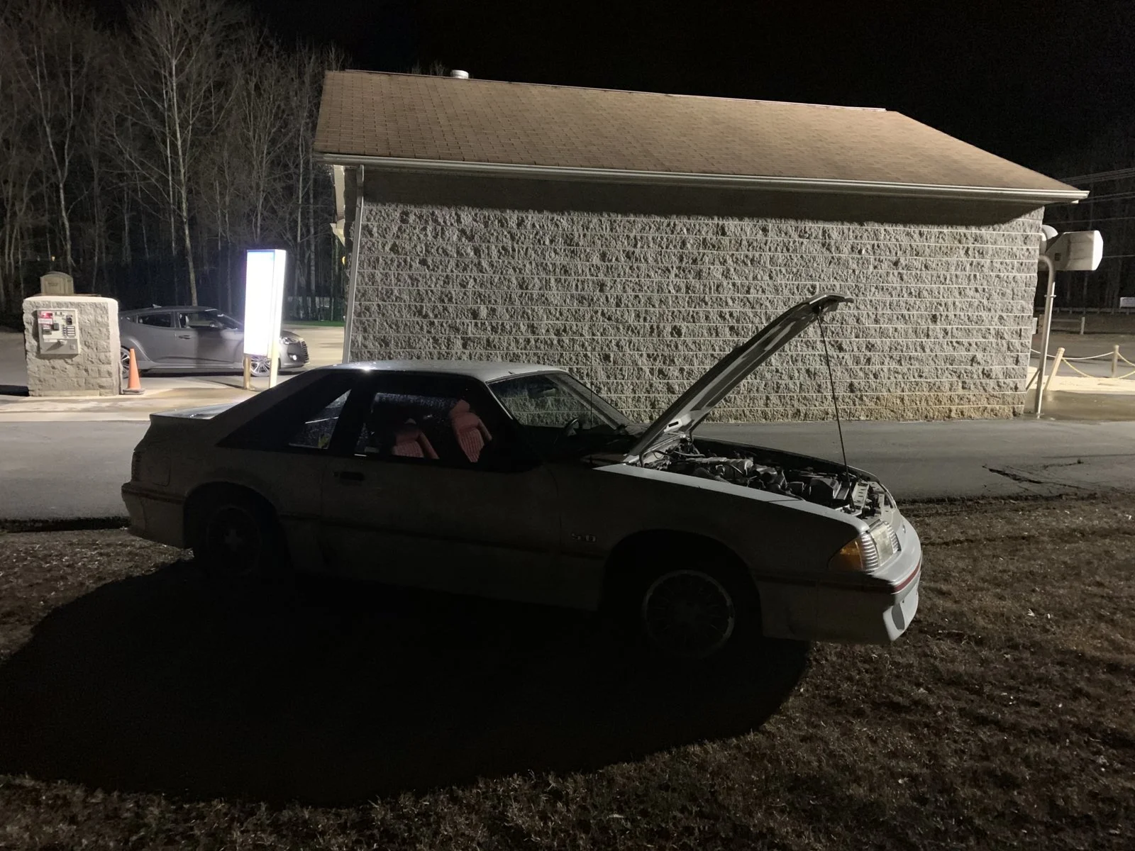

On an unrelated note, points were scored for Team "Get Rid of the Ram-Air Hood" tonight, when I took the fox to a car wash and it failed to restart. I ended up pushing the car out of the car wash myself, then fortunately had the assistance of someone else to help push the car to a better spot where I could get a jump start when my wife arrived in the black car.
Good times. :rlaugh:
Those horns are also at chain FLAPS and are louder than stock. On my newer Merc, I need to instal a relay so it will beep when I lock the doors, not just click. But honk and people jump.
I think some of those ram air hoods had a piece underneath to push air where you want it wile going down the road, and it should keep the engine dryer. The piece should be cheaper than a new stock hood and painting it.
No special tools needed. Just a $5 wire wheel for a drill and a drill and you can get that bracket cleaned up. A bench vise also to hold it would be good.

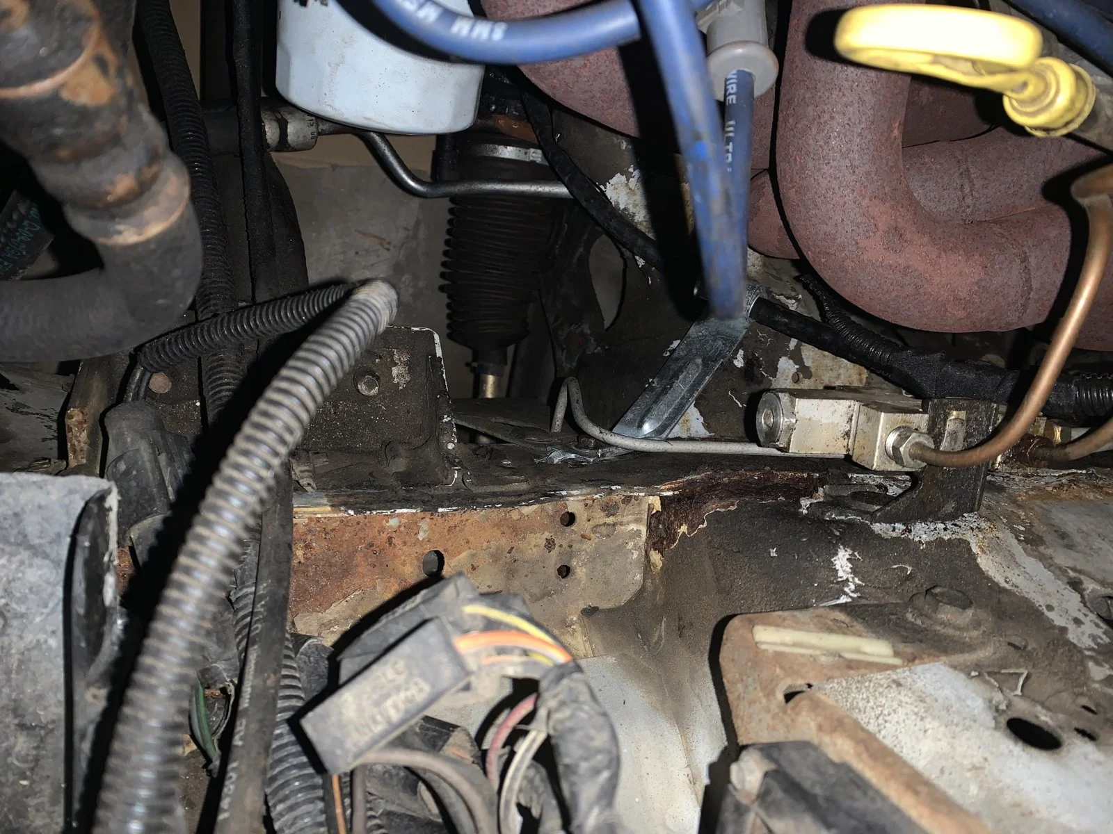

Did a little poking around today, because I couldn't stay inside all day, and noticed something I wanted to highlight...to see if anyone has any solutions or suggestions. There's some rust in/on the engine bay/frame on the driver's side - how much should I be freaking out about this and is there anything I can do to prevent it from getting worse? :confused:

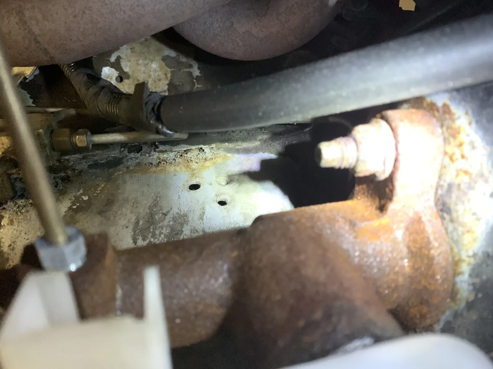

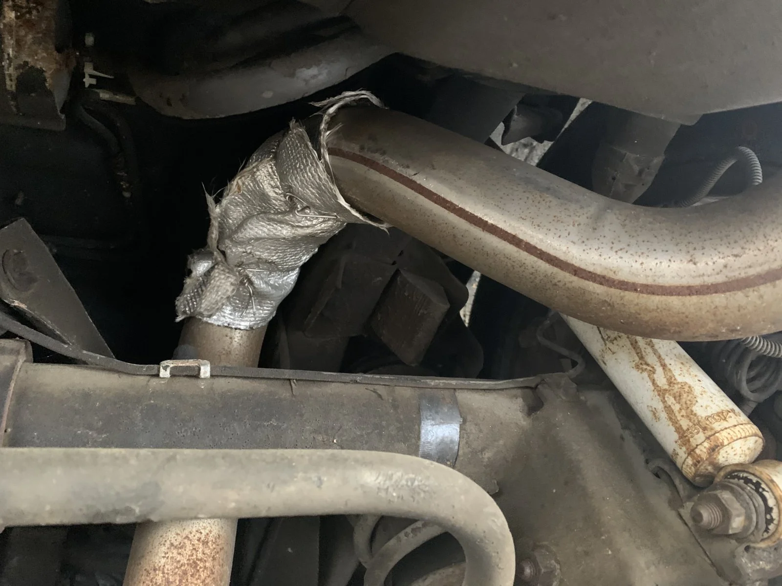

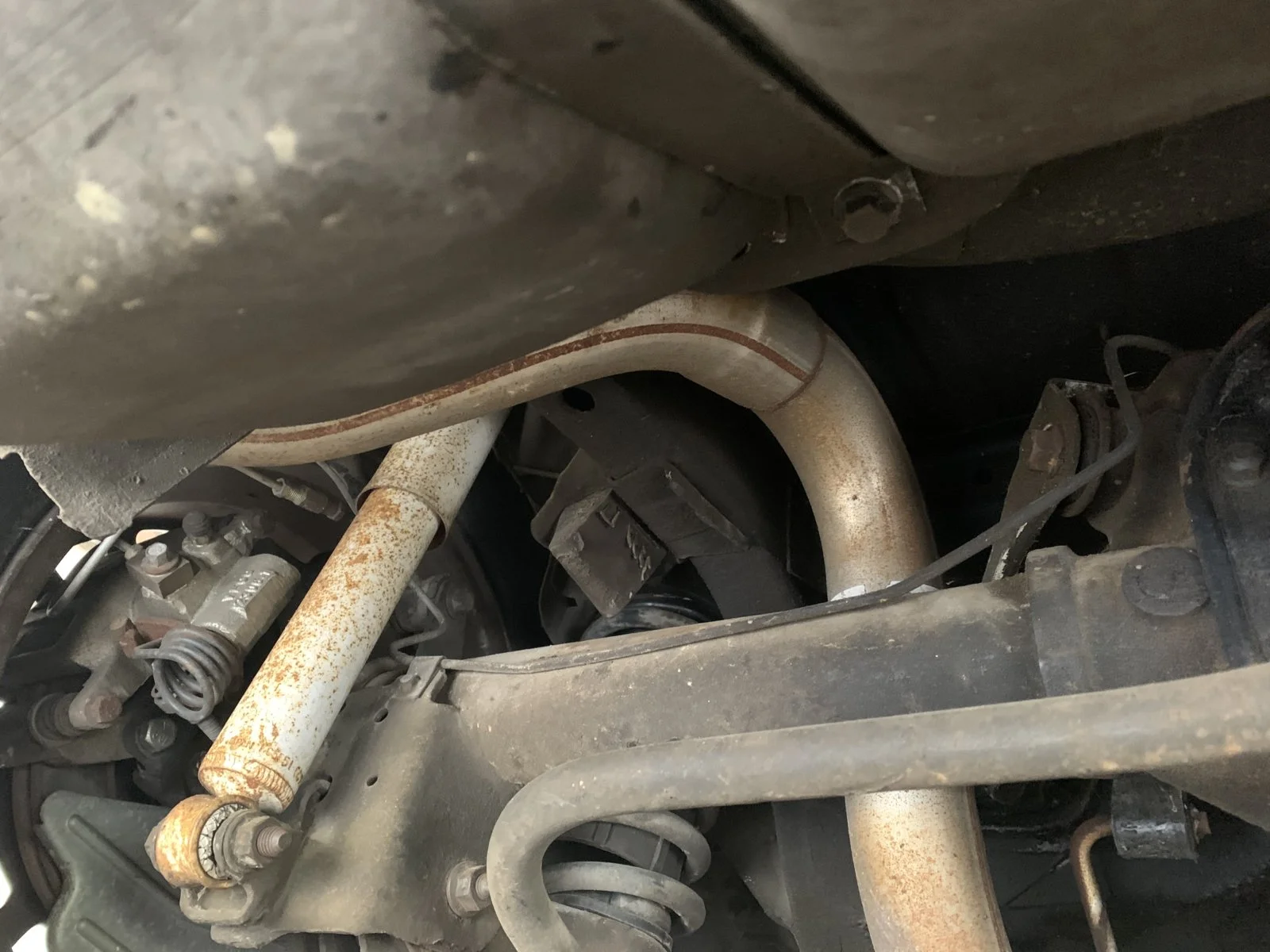

Also, I noticed this wrap looking thing on the passenger side exhaust over-axle pipe. Anyone seen anything like this or know what it might be for? It's only on the passenger side. Driver side looked normal as far as I could see.
