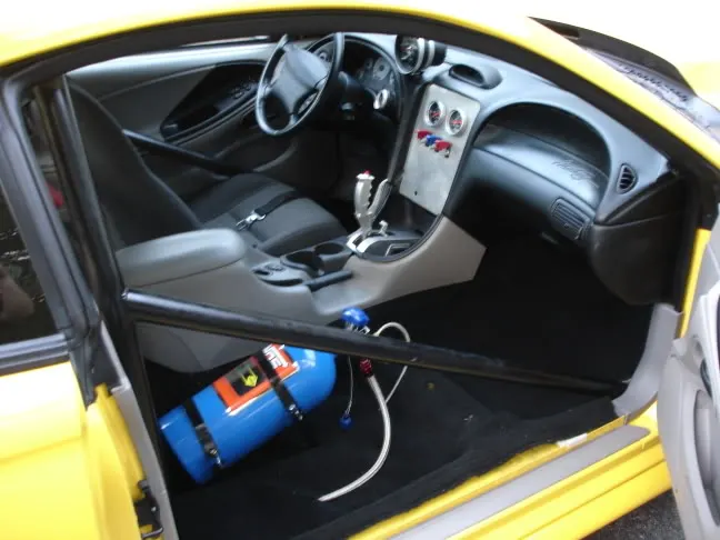

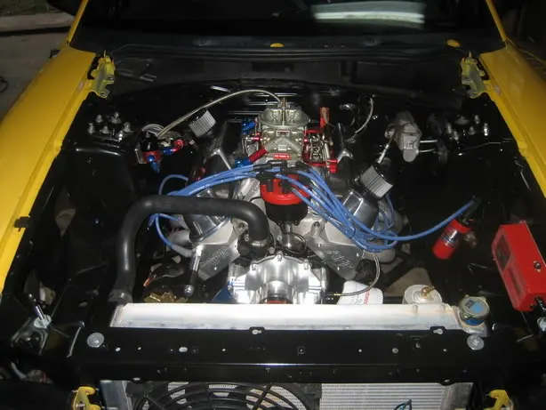

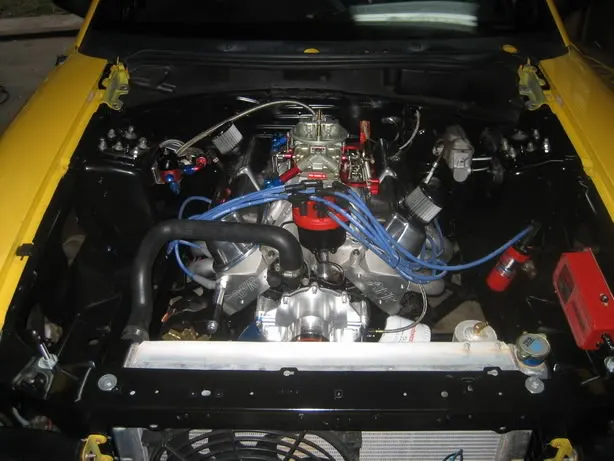

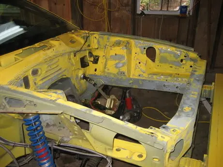

Let me see..If I take the factory weight 3450 add 40# for my stoker - fibre hood 25 - a/c 40 - smog 10 - fender weight 25 - air bags 25 - cats 40 - strut twr brace 15 - vert motor 12 - spare tire/jack 35# - 45# heads = 3218 rough.
Car is a 95. ABS removed all stock sup. removed. D&D K member, A arms, coil overs. All under dash removed, Air bag deletes. all pading , wires, brackets removed. Fiberglass hood, most sound deading removed. And i cut off any bracket that i could under the car. inner finder wells remver, wipers motors gone.
here is how far i took my car down.
This is all thats under the hood
Sorry, not trying to get off focus but WOW!! That is quite a lot of work! :eek: I had a scary enought time swapping engines and a TB. You know...when we have our cars apart like this and depending on th eexperience level, you can feel like you are on the dark side of the moon and start thinking will I ever get it running again. Hats off to you. :hail2:
Edit: I also like your placement of the fan. Gives more room in the bay. nice.
