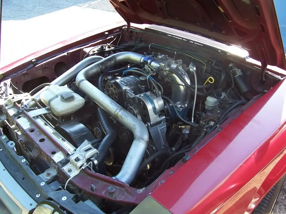

i started out with crush bent 2.5 ...depending on the angle, it wont noticable hurt performance. I eventually made a mandrel bent 2.5, didnt notice any improvement outside of the looks/fit. :cheers:
what IC rad combo you got? I couldnt make my old brackets work, i had to use the ZIP Tie patented Mounting mechinism. and couple threaded rods for brackets. that looks nice though, i need something like that, and where did you get the overflow, i had to ditch mine, and am currently without one.

Yes.. boost is a wonderful thing, I looked for an explorer rad (2 core) but all i could find was a ranger (1 core) so i am hoping it has enough capacity to keep it cool. I went with a farly pricy Hayden Fan to make sure i got plenty of air flow. so hopefully it'll be alright. Ill have to get some pics of the way my IC is mounted and some IN car engine shots. I cant wait to get my ic hooked up, and the exaust connected. so i can drive this thing again.
Dr.
I hope Wood doesn't mind me jumping in but, I know he's got a Volvo radiator in his Stang and that is one of the 2 styles of coolant fill bottles. The other is round. The Volvo rad is a closed system so you add coolant through the fill bottle. I'm not sure about his IC but I'm sure he'll reply when he gets a chance. I'm running a Volvo rad and NPR in mine (still under construction). Click on 'Thunderstang' in my sig to see it.
Evintho is correct, its a volvo radiator/coolant tank. The intercooler is a Saab 9000, looks just like a volvo one, except wider with stretched end tanks. I originally was going to use my mustang radiator..this IC *Almost* made that possible.
the brackets are both the standard mustang ones (those hold the fan in place)
aswell as the volvo radiator bracket (which holds the radiator). The coolant resivor is custom.
