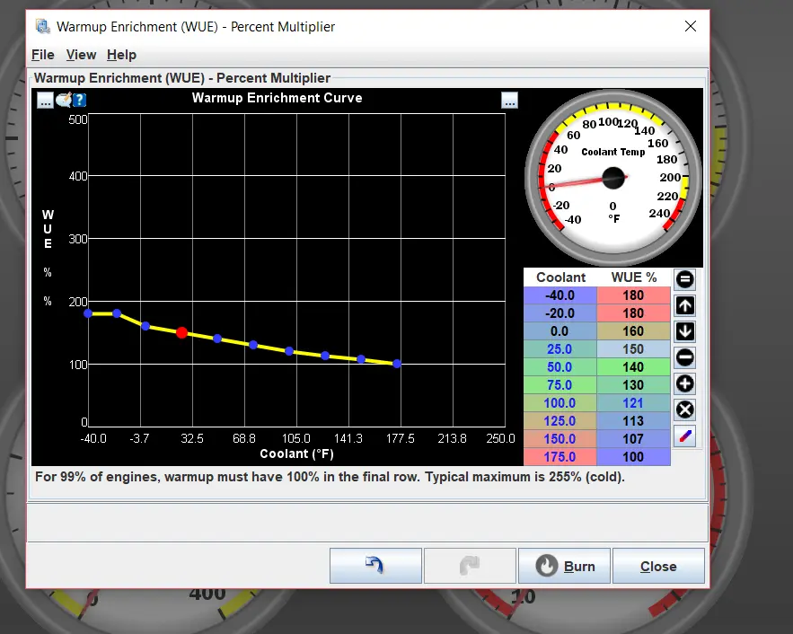

the startup looks really good, you may want to extend the warmup enrichment out until 175* and give it a few percent '105' at 160* and let it taper away to 100 at 175. this will stop you from going lean at that one little spot.
k now you think the warm up enrichment autotune would possibly correct that.. or would it be better if i adjusted it manually?
i was gonna run a WUE autotune this morning when i go out
man. Its starting pig rich. Like 11.5 afr. Jesus its way off target. No surging tho. But god dam
