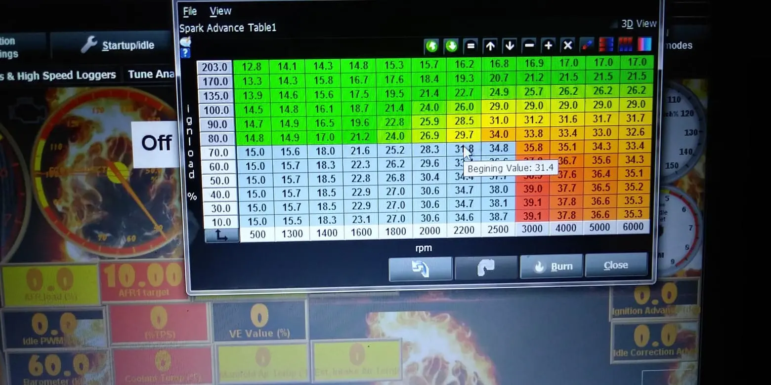

well alright you know i hate messing with the timing table. lol but ill give it a try.. and ill add a .5 second to the idle advance delay to see if that helps. heres a pic of the smoothed idle to 2500, i figured since im idling at around 60ish/KPA might aswell go from 70 down and over to 2500. but if thats a problem let me kno

well i think ive got it.. but it seems now to only drop low when the cars fully hot.. kinda weird how when it cold or warming up its fine.. but when full temp. it wants to drop.
