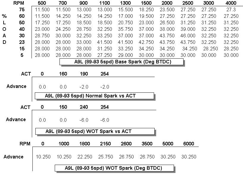

Hell i never realized that the A9L ecu 10* base commanded a total of 42*timing at 25%map and 2k rpm.. lol i had a problem with pinging using 14mech with the total added in... but that was cause of a :poo:ty gas station and poor quality fuel... i only run 91 now.. funny the info you find when your bored cause its too cold to be out in the shop LOL

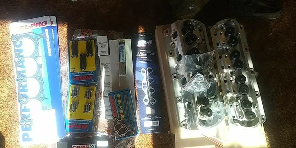

breakin out the spring time goodies.. lmfao cannot wait till this is done and built.. gonna be a blast to drive if i can get over this learning curve on the ms
