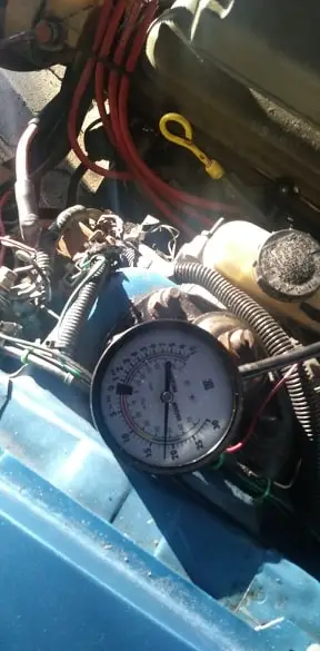

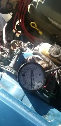

hmm ill go take a pic of the engine and post it.... but i noticed my egr valve has vacuum.. but ill post a pic in a sec
My vac gauge hooked up to the vac tree shows 18.. So if theres a vac leak its gotta be somewhere on the motor.. Cause i unhooked the brake booster pluged that hole and unhooked all the accessories from the back of the intake "egr vac canisters and heat controls" still read 18.. But the car was surging so its bouncing from 17 18.. But with everything as it should all hooked up. Its still reading 18.. So i duno what to think
