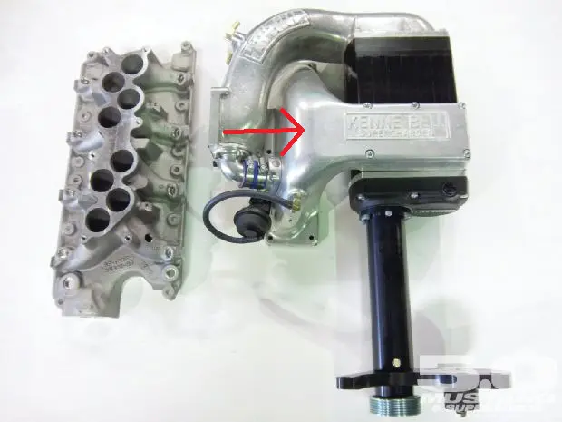

Regarding meth injection, I'll add a 14gph nozzle to my 2" Accufab TB spacer. I'll tap a couple holes because likely, from what I hear, the 14gph won't be enough especially if I increase PSI. Likely I'll run (2) 10gph nozzles (but I'll start with the 14gph first).
I suggest tapping the outlet from the blower, then start with one 10gph nozzle
I've heard mixed reviews about doing this however most peoples results vary even if their combos are very similar. Many people have run nozzles in the TB, inlet, and discharge and most report the discharge location didn't change anything. Best results were pre-blower. I will start there and if the results aren't that good I'll tap in to the discharge.
For the KB, that is approximately here:
