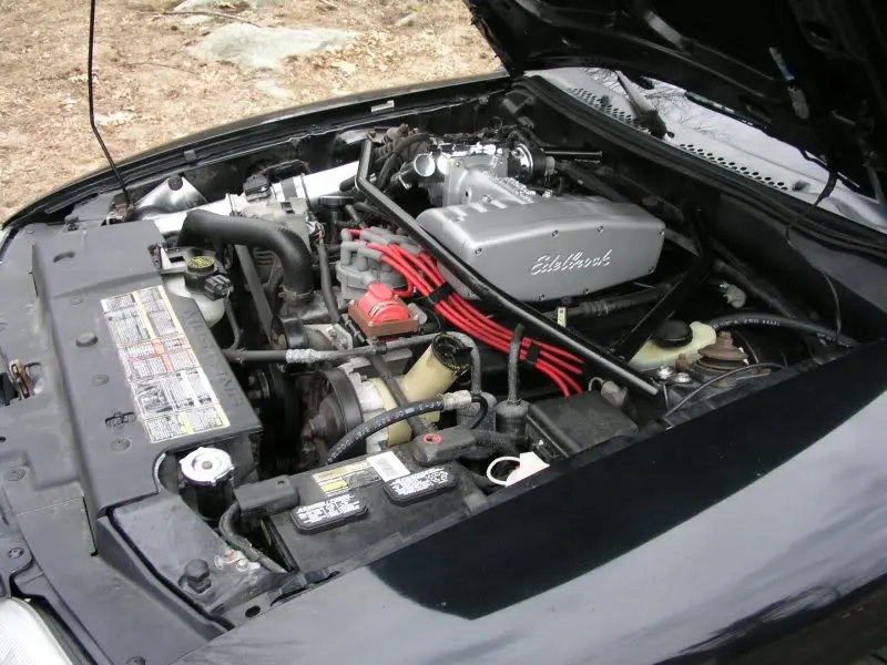

FOX THROTTLE BODY CONVERSION PICS ARE IN!
I know I'll be told to "search" but I already have a engine out of a fox and the TB is on it... Besides the TB what else do I need and how much $$$ am I looking at?
Also, what are the advantages of the TB conversion?
Hey 95cobraguy where did you get the discharge tube from? I have a vortech setup, and I hate the small plastic discharge tube that comes with the kit.
After seeing your setup, I am definately going to have to do the fox T/B swap, and get a new discharge tube. Looks Great.

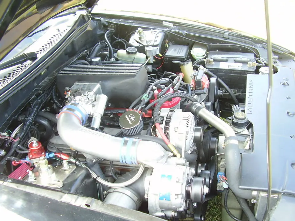

i got it straight from vortech, its basically the discharge tube that comes with the 87-93 kits. it was about $160. i had to cut a few inches off of it at the blower side to make it work, no big deal. make sure u get the aluminum pipe, not the plastic one. the aluminum one has the provision for the fitting for the bypass, the plasic one doesn't.
I did the same last year. My discharge tube came with my blower kit,though I didn't need to trim it.

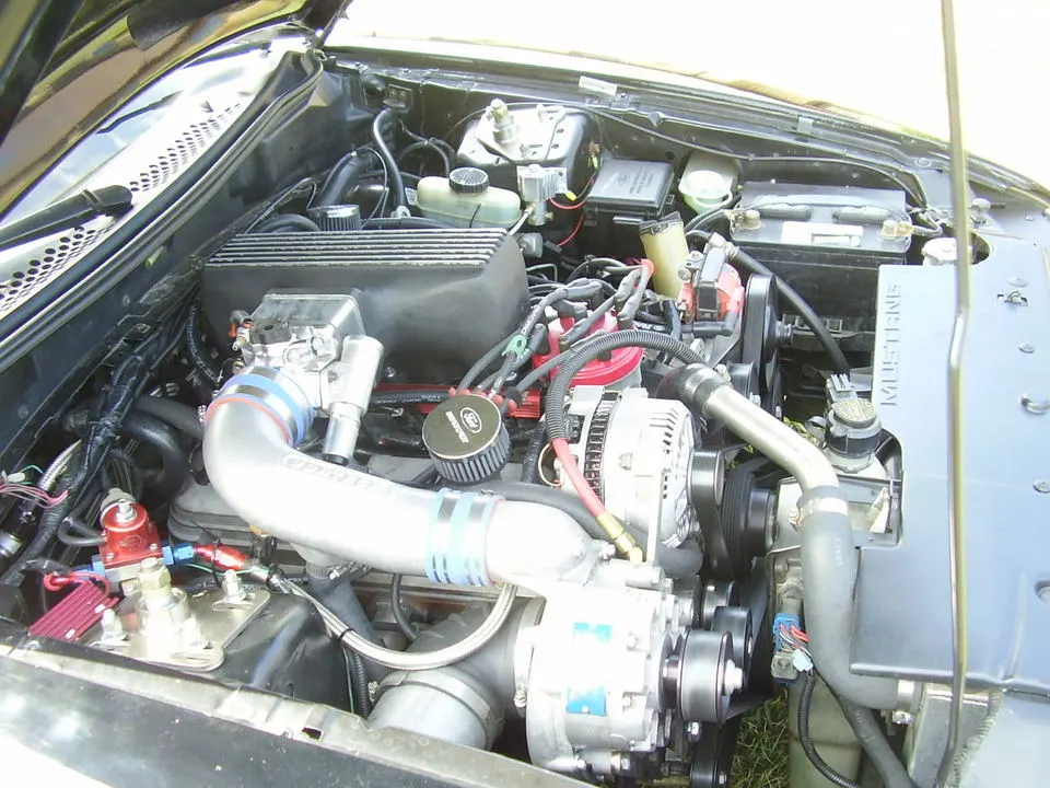

eades5.0 said:
Back in my s/c days...hehe

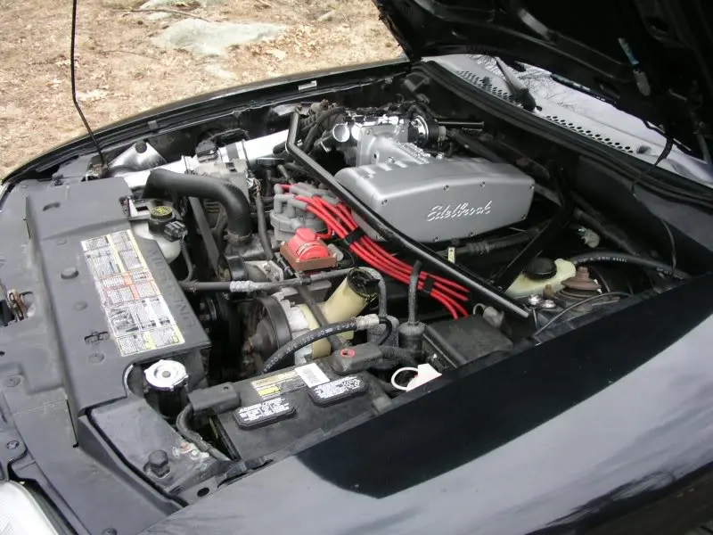

Mine:
