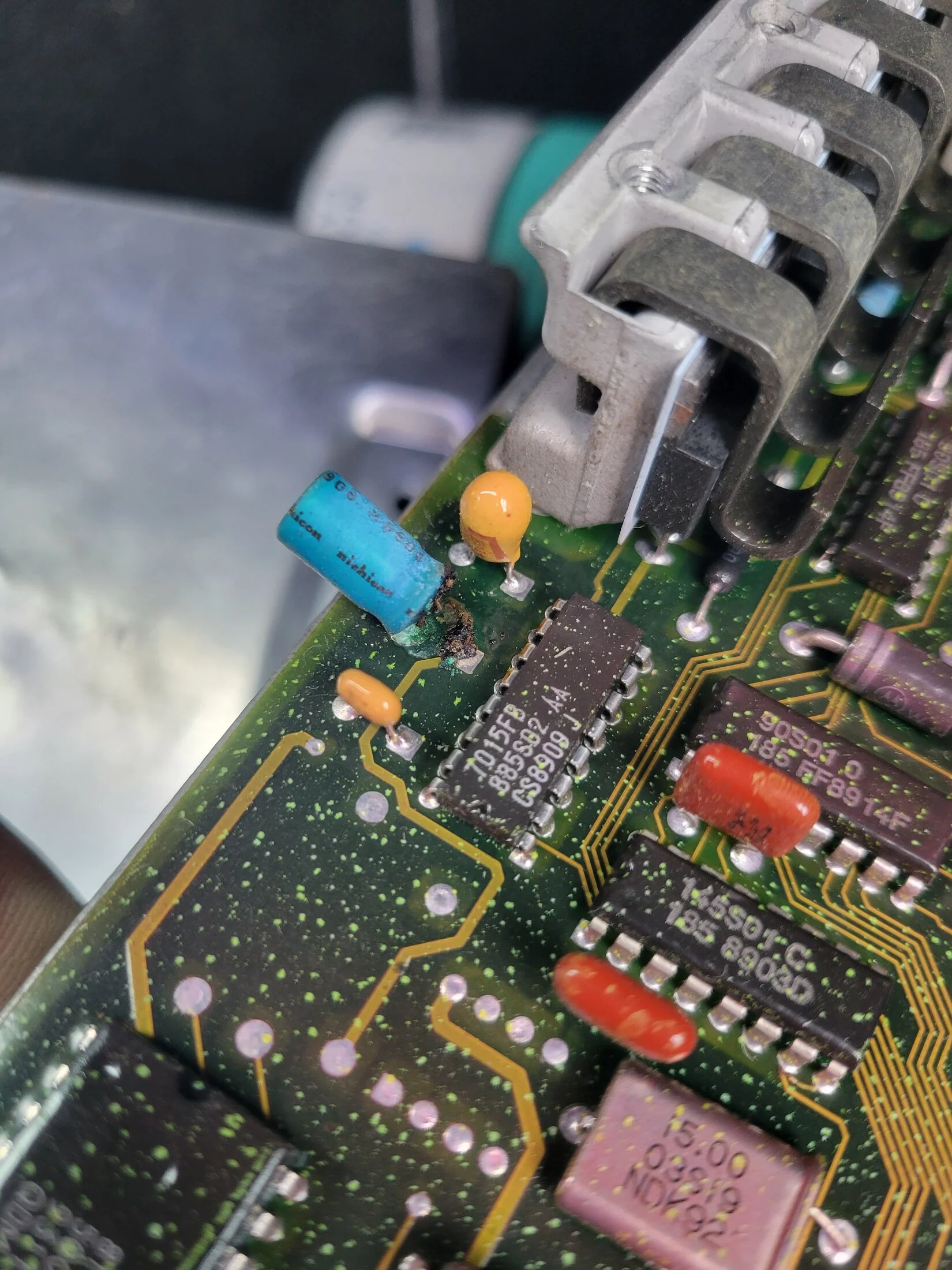

Alright so I looked at the computer again and this capacitor looks like it shorted out and fried one of the connections. Anyone know what could've caused this? Should I attempt to replace the cap or should I just get a whole new computer? I've tried a new coil and ignition module on the distributor and I also bypassed the msd and nothing changed so this is the only thing I can see is wrong at this point. Thanks

Looks like it burnt the trace so I would say send it off to ECU Exchange. Mustang5L5 may be able to tell you what that particular cap does so it would give a clue as to a possible reason it gave up the ghost but in all honesty the ECU's are 30 years old at best and the caps are just not meant to go much longer than that. Would not surprise me if the cap gave it up and burnt the trace.

See the green fuzz, that's corrosion for the cap leaking, any where it leaked its going to start eating away at the trace. Need to clean it , remove the conformal coating, fix any damaged traces and pads and install new caps.
This is who I would suggest if your not comfortable doing that type of repair... This guy has done some repairs most places would tell you can't be fixed, he's out of VA.
