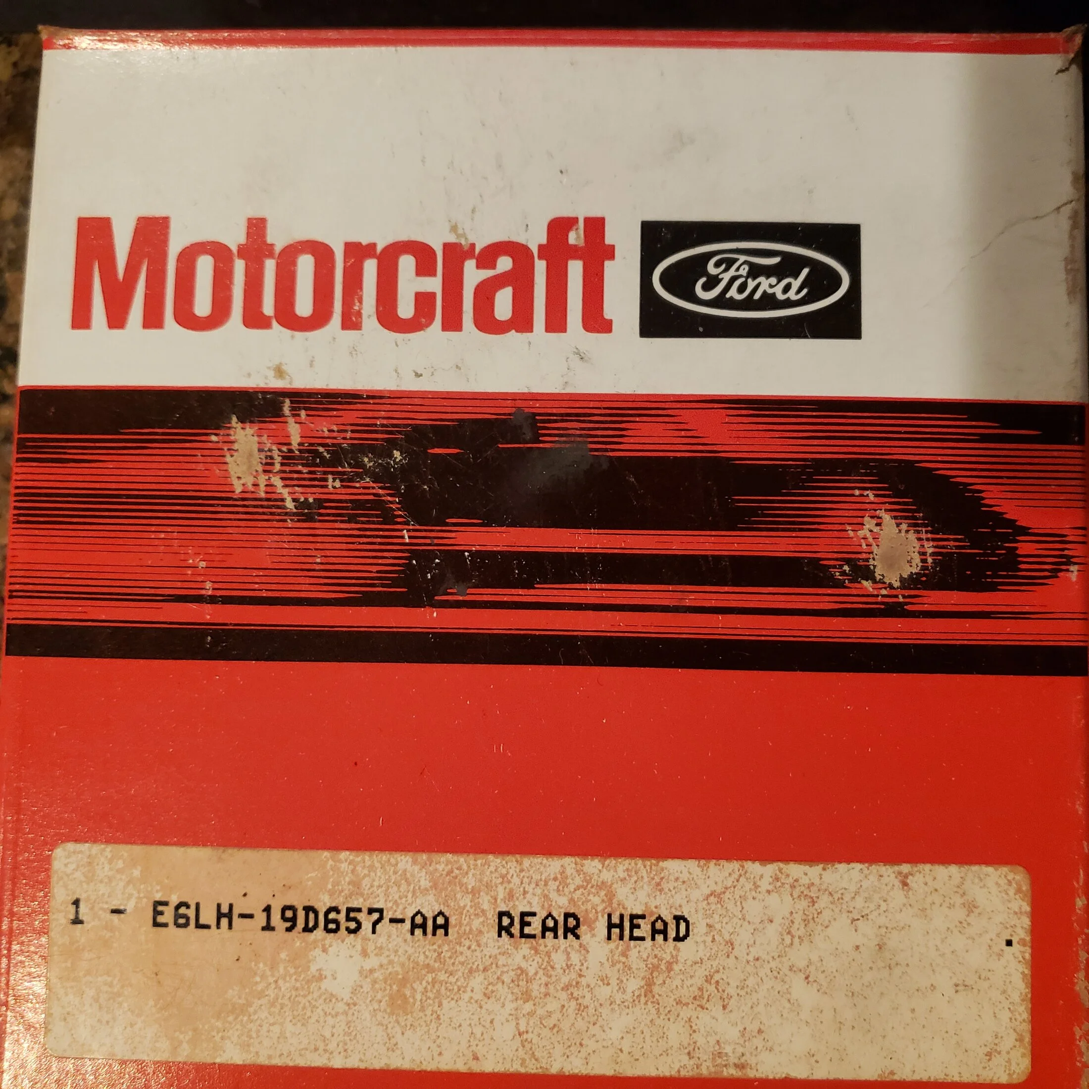

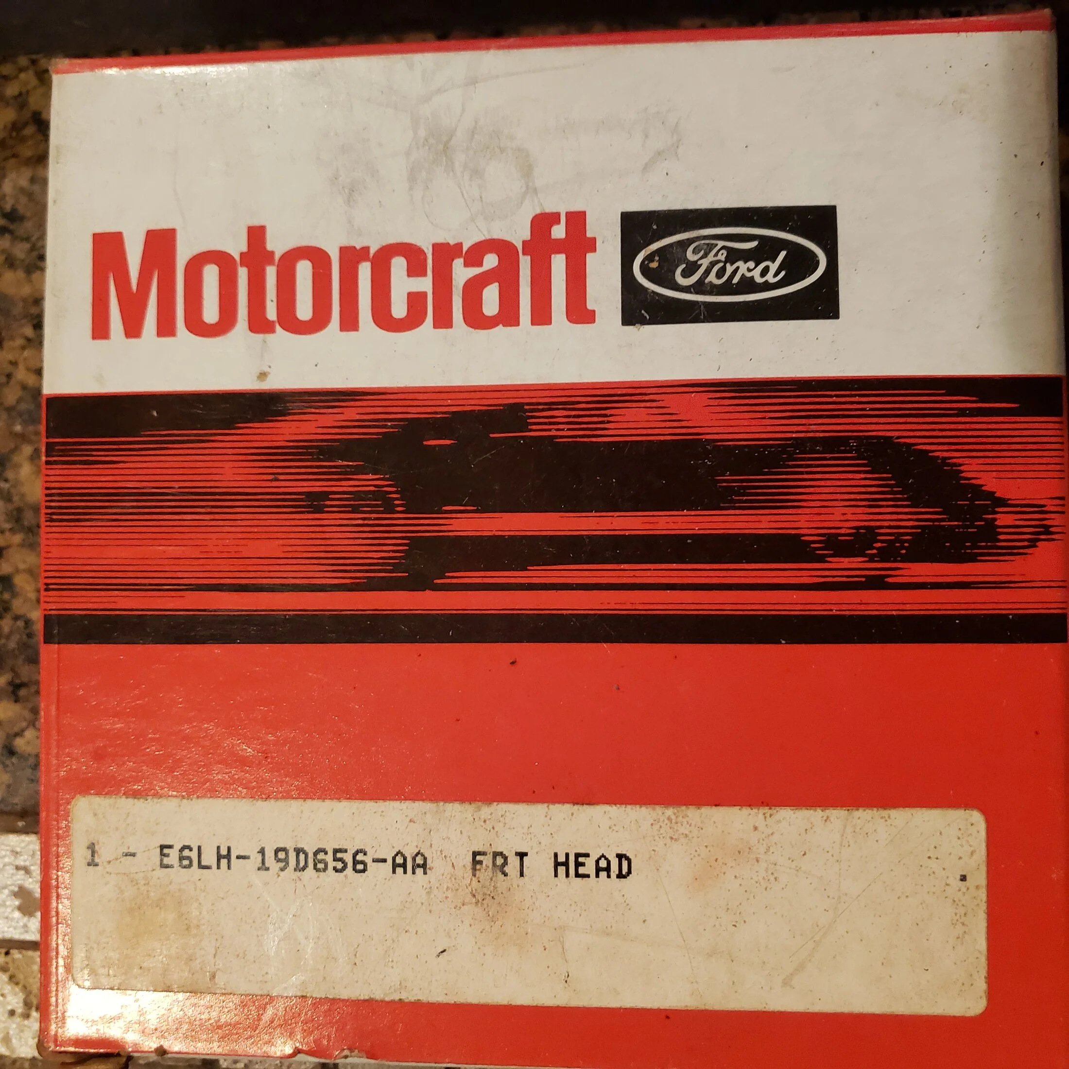

I knew there was a reason I didn't toss the original compressor from the Junk Pyle.

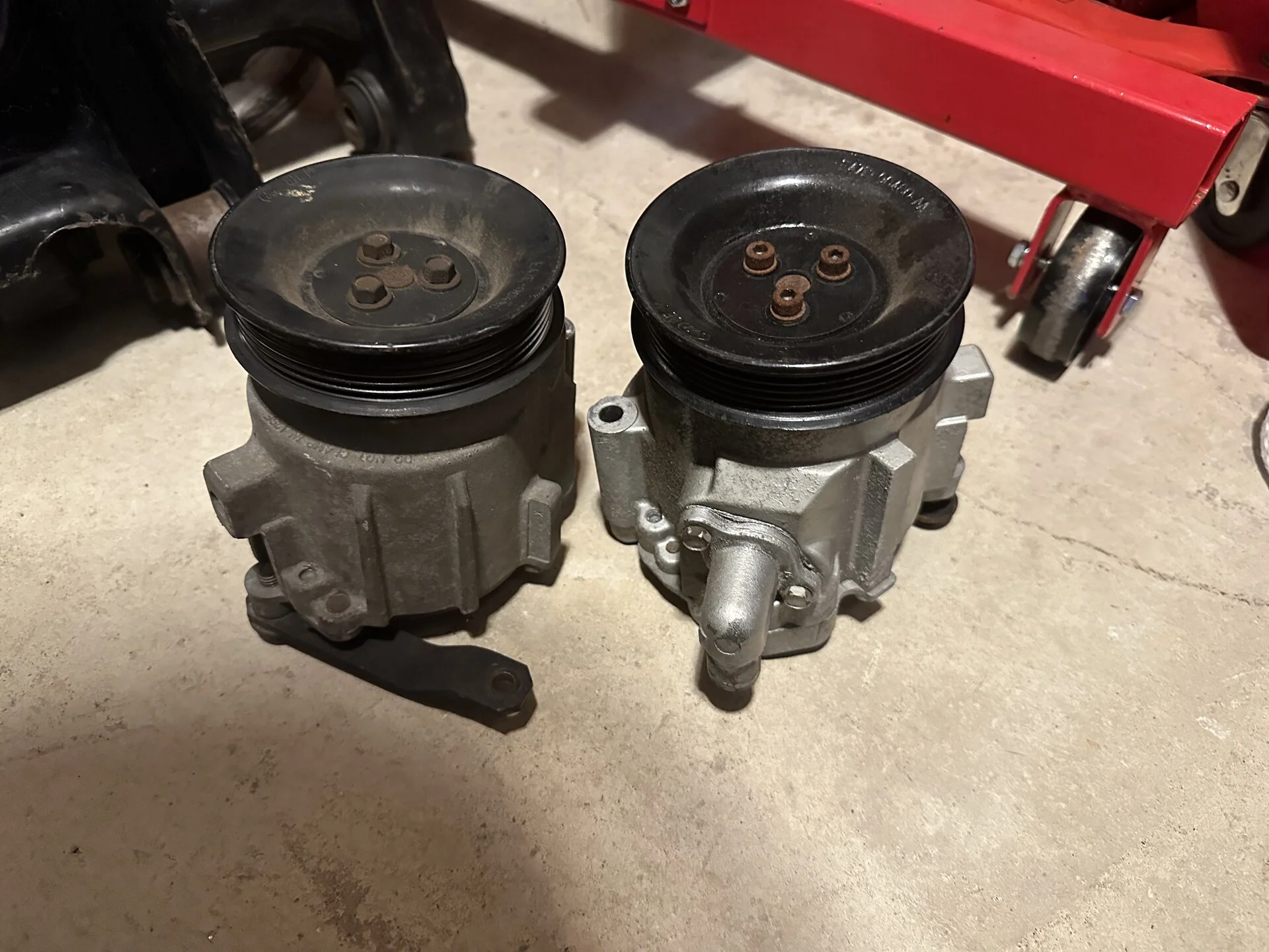

I'd like to see something like this done to an air pump. There's just about no info available an the correct way to rebuild one. I did find a part number for the front bearing but no videos. Just people smacking them apart with hammers and spraying wd40 in them before smacking it back together. There's gotta be a better way.
I found the part numbers for the bearings. Front bearing is 6203-RS. Rear bearing is BA248Z. Inner small bearings are SCE65 but I do not know how you change those. Those are the part numbers I bought to do mine.

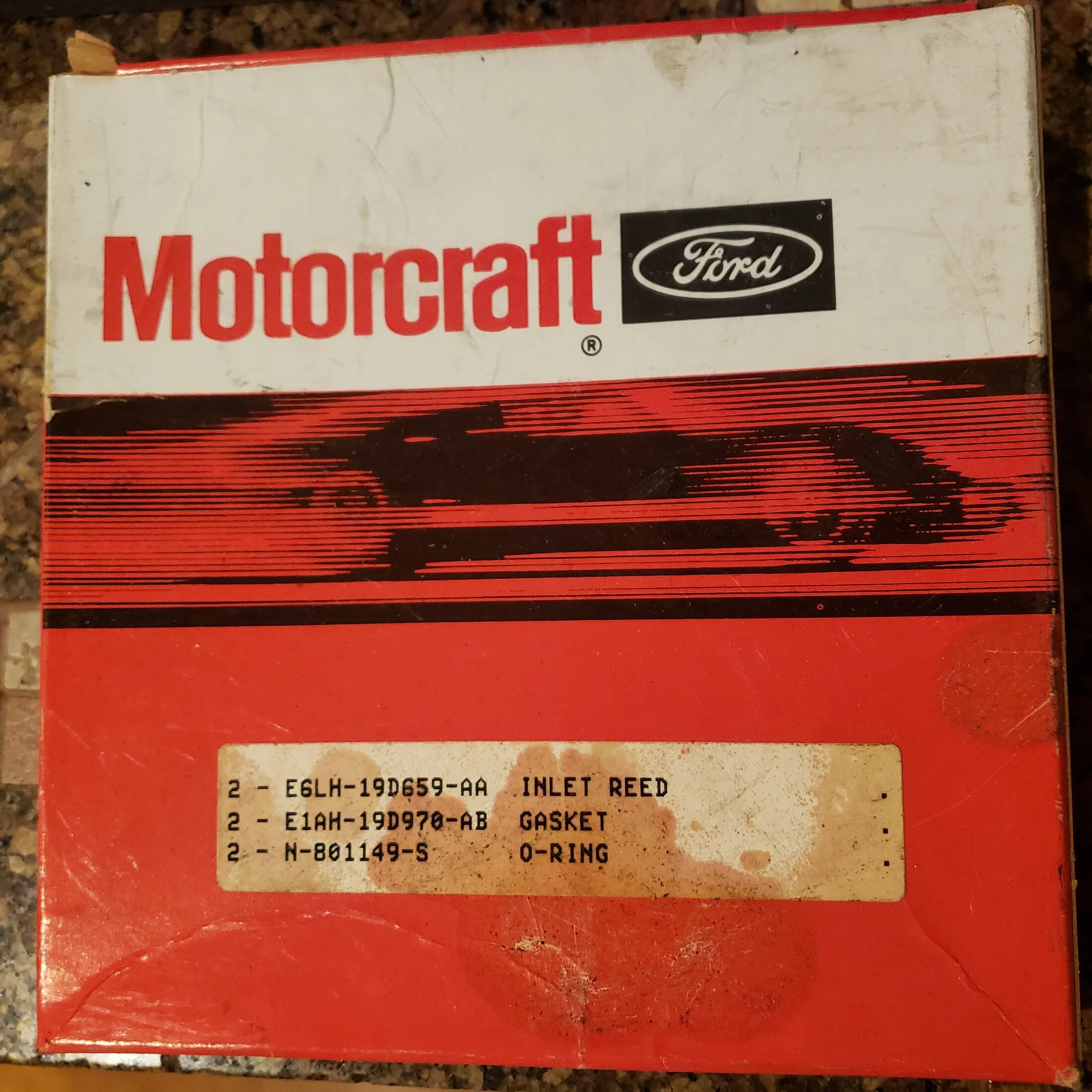

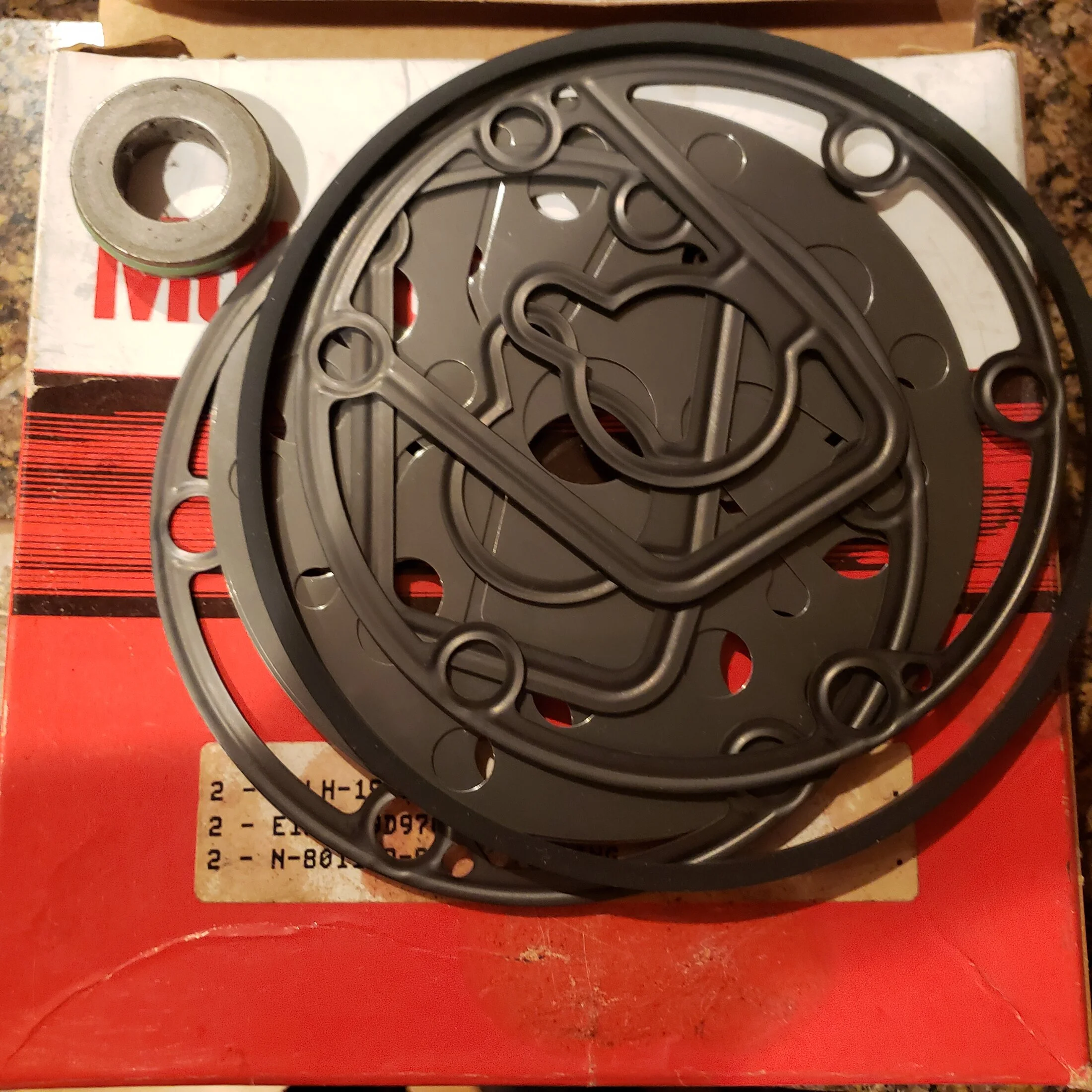

Hey, I’m considering tackling this job soon. The links to the parts in the first page are all dead. Do you have any current good links to the seal kit and shaft seal kit?
