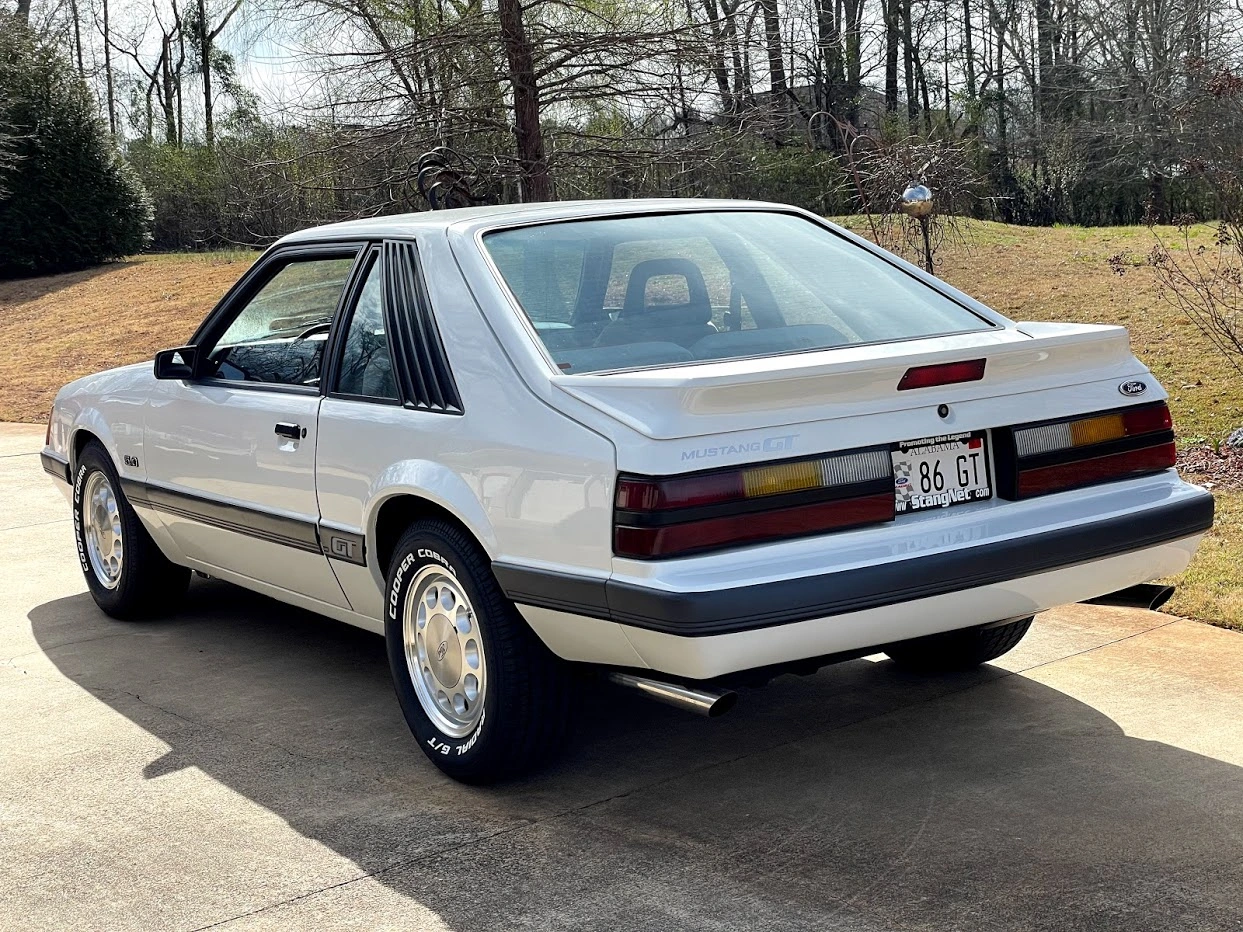

OK, I think she is good to go. Took her on a shake down run this AM. Seemed to do well. Brake pedal is not at top but not sure it was supposed to be, I can press and get great stopping power and pedal does not bottom out. I also completed the exhaust during this phase... which I think I will now call the done phase. Need to adjust one tip, hangs too low, go figure their bracket is wrong (Flowmaster tips == China). But they had the nicest one for my setup.
Exhaust == Stock Manifolds ==> Magnaflow Catted X-pipe ==> Pypes Extension pipes ==> Borla Mufflers ==> Flowmaster Tips and used custom Pypes muffler hangers for the mufflers.
I spread my love across multiple brands :)
Google Album for those curious.
