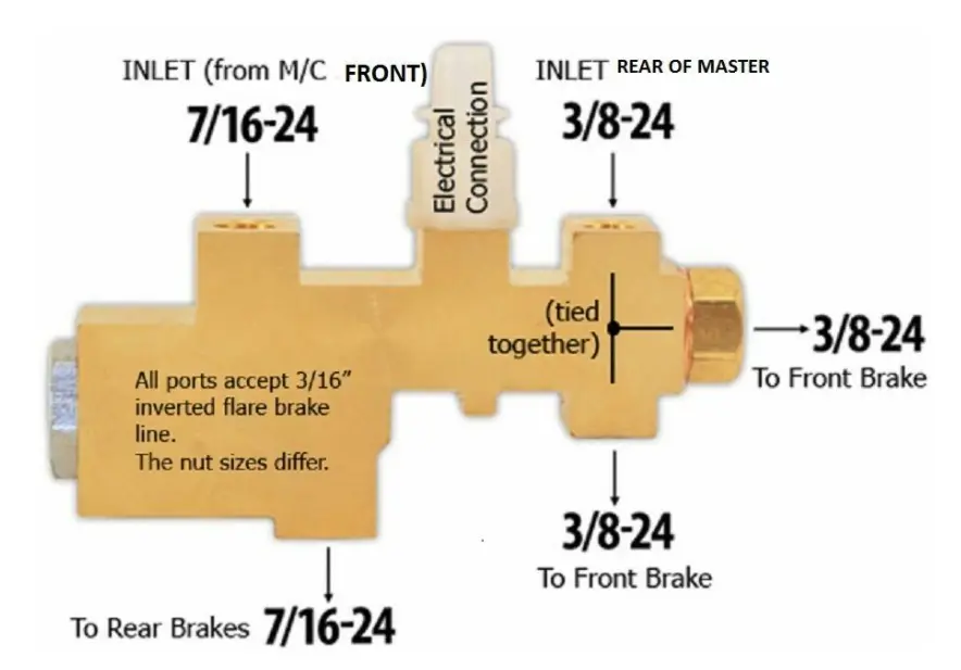

Prop valve is only available used. You’ll need one from an ~80 thru 86.
I’m not sure if the 87-93 one can be used. I know the top two ports are 3/8-24 and 7/16-24 inverted flare. I can find out the bottom two shortly
edit: looks like the bottom two ports are also 3/8 and 7/16

Is it this one?

Is it this one?

actually, of those port sizes are correct and 87-93 valve would work. You would just need to take the 3/8-24 fitting off the rear of the valve and swap it over to the 87+ valve.
you would lose the brake pressure switch though
