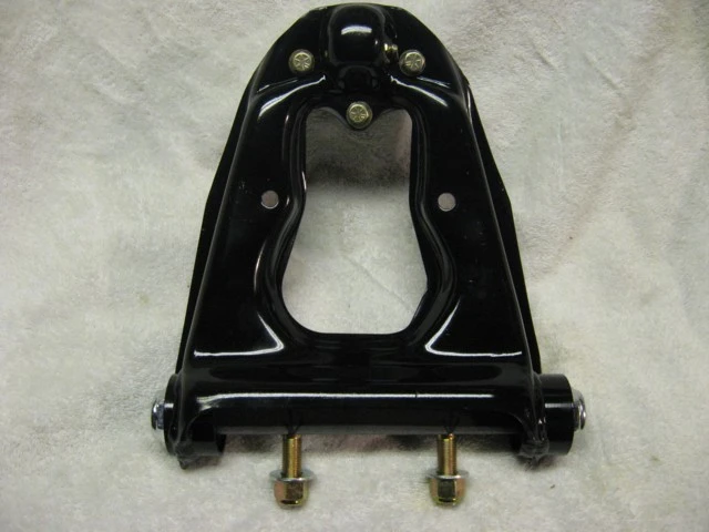

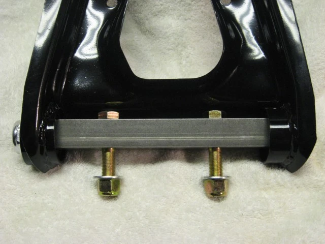

I also think moving the upper ball joint backward is a better way to go than pulling the lower arm forward to get more caster. Pulling the lower arm forward changes the location of the outer tie rod end and messes up the steering geometry. It also brings the tire closer to the fender. We offset upper arms often to get more caster.
Here is a photo of one roller set I did for a pro drag racing team that wanted 8deg. of caster. I offset the upper arm 1/4". You can offset the shaft kit in the stock arms since they are right hand threads on both sides. You end up with a right and left side upper arm. We have done that to our cars and it works great.
