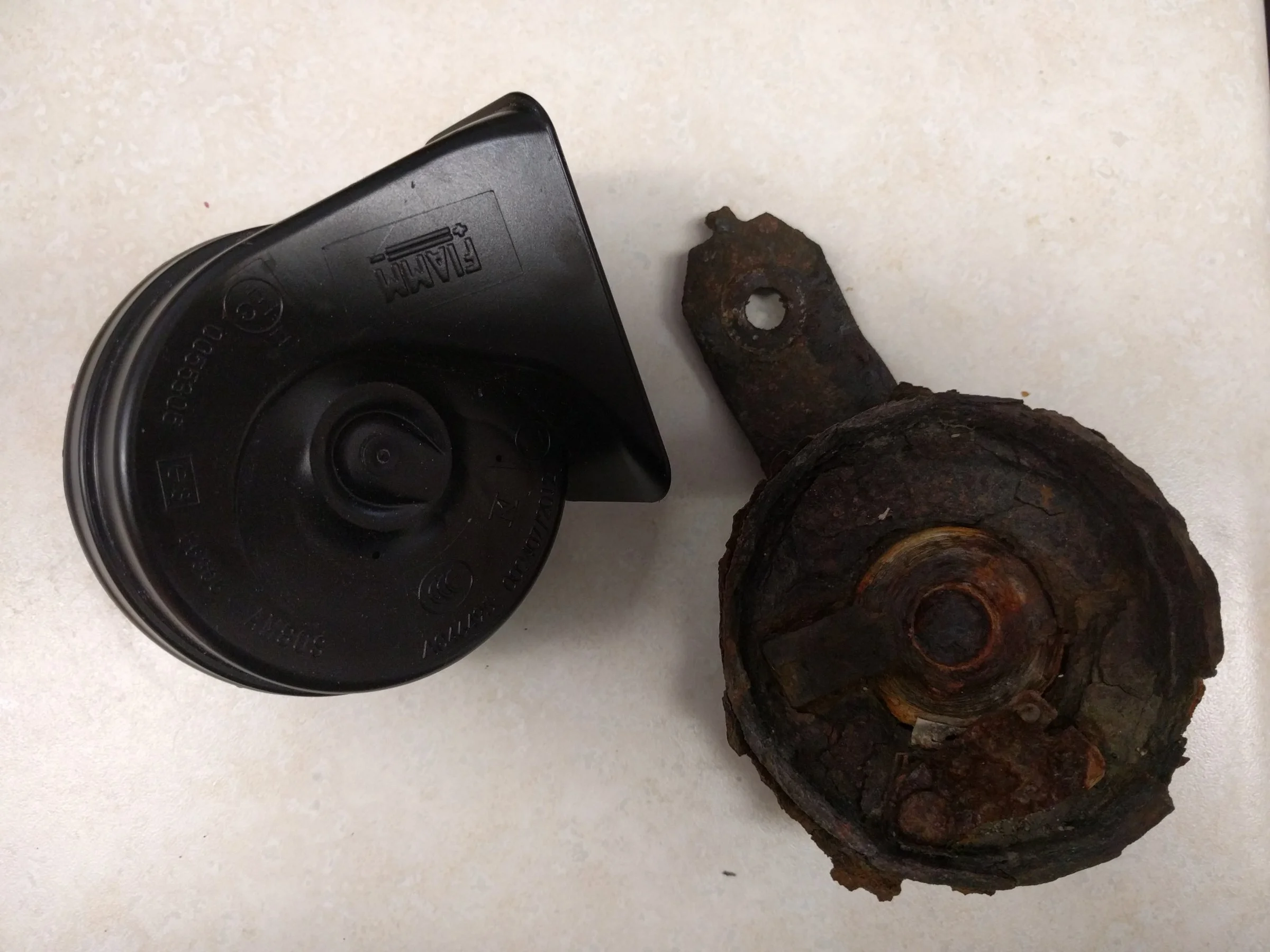

I think one of the horns fell out of the car during previous work, and I didn't even recognize what it was. With new high and low horns, everything is properly loud again.

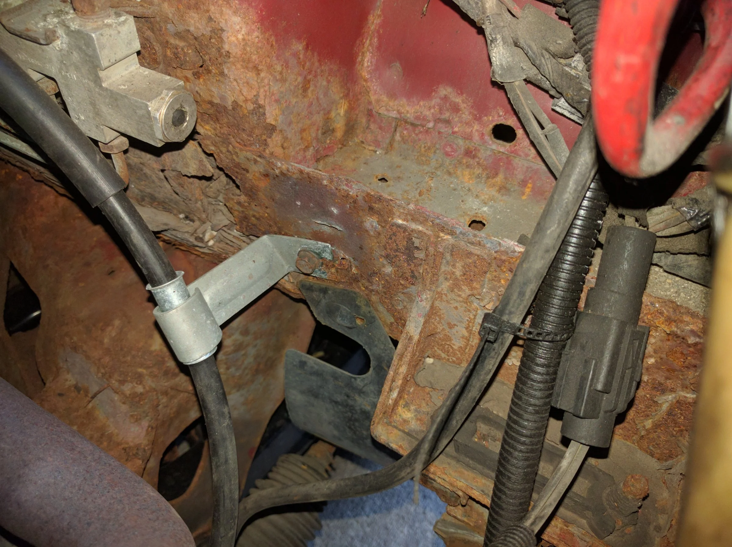

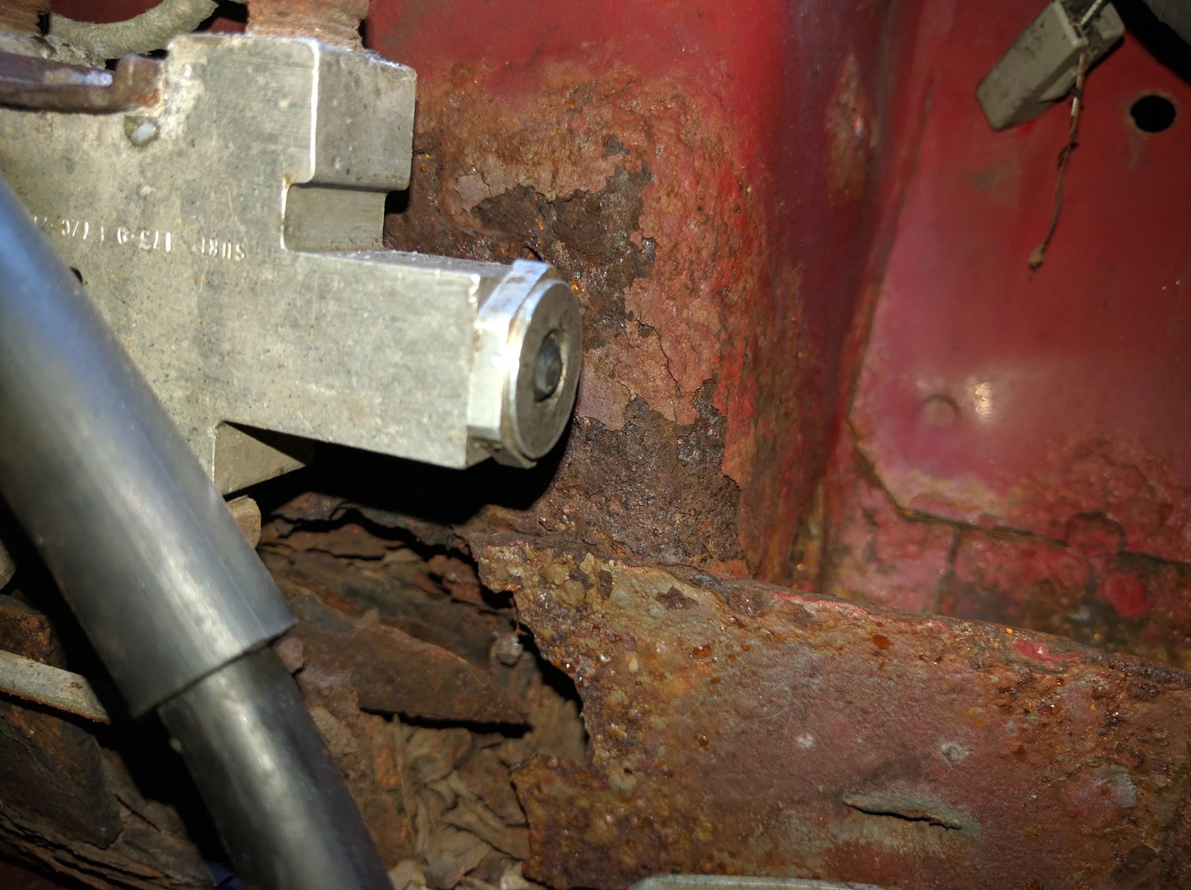

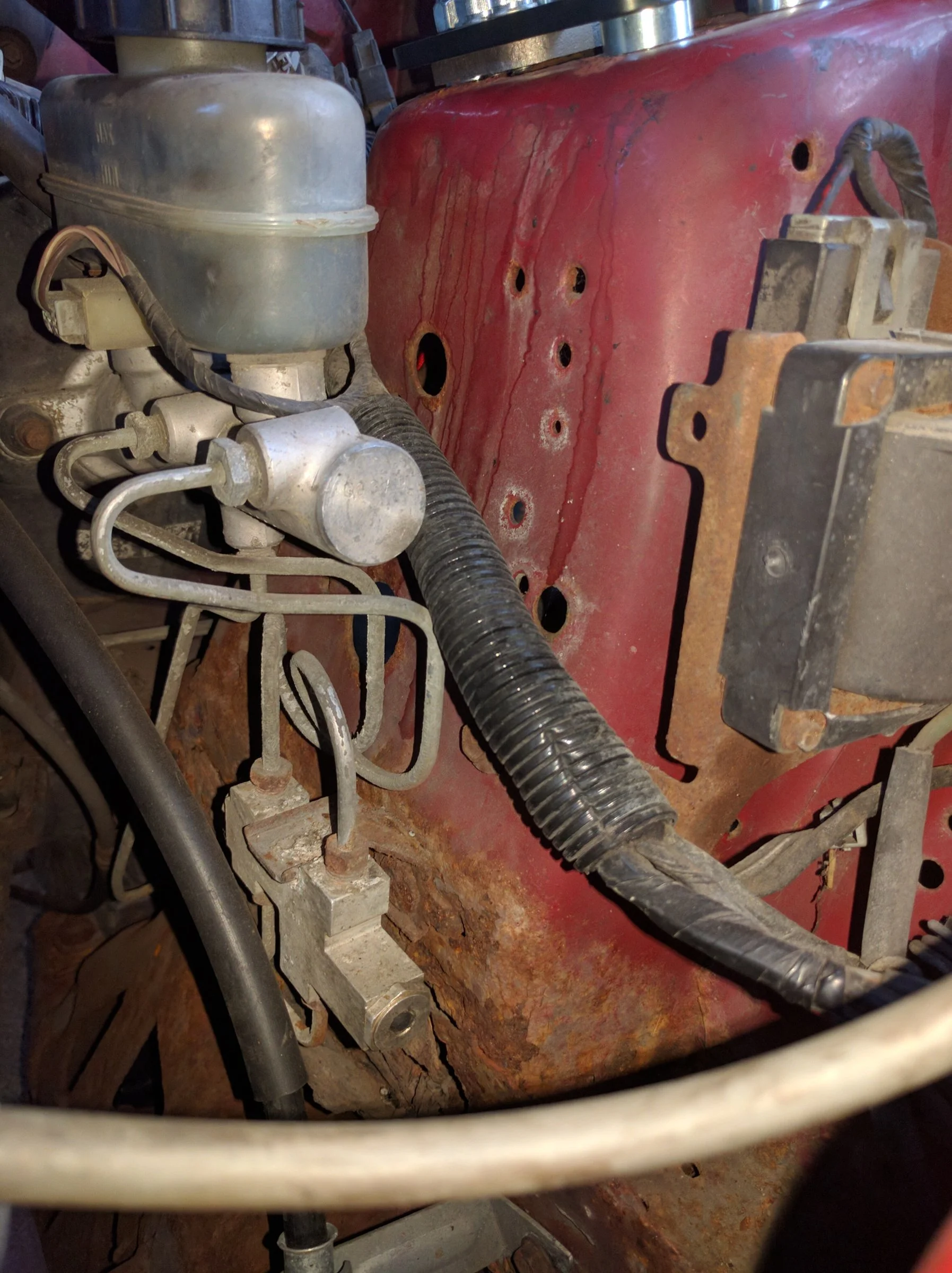

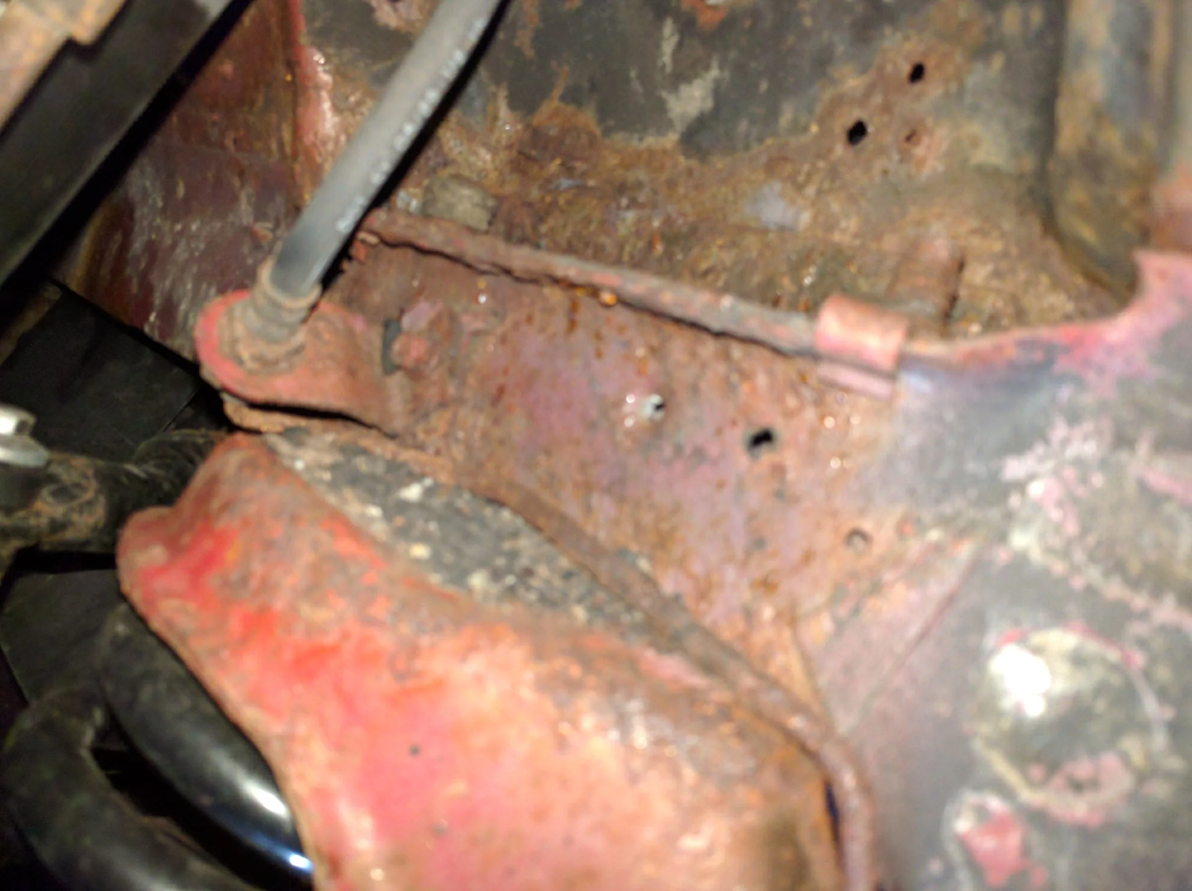

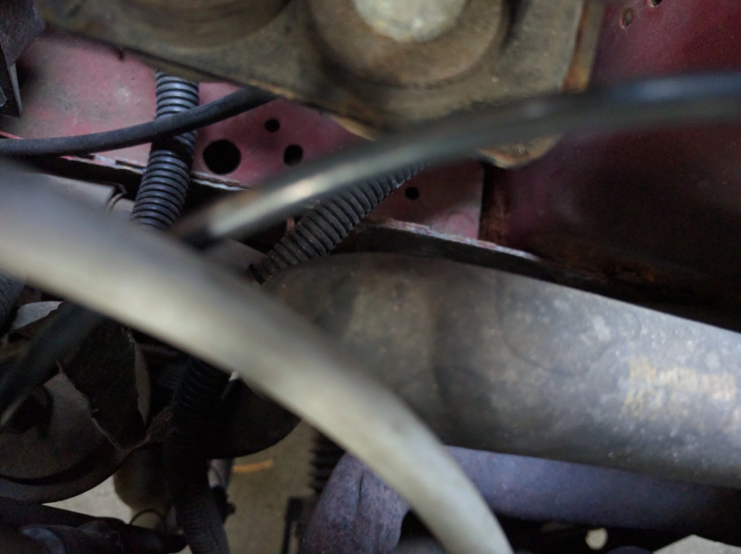

Wow, that labor cost seems cheap considering what would need to be done. Post pictures of your front end around the shock tower area. I would be curious to see it.
Passenger side:
Driver side:
It was difficult to get good pics of the passenger side, even with the intake tube off. Let me know if you want more angles. I might try again tomorrow after the sun is higher. But the passenger side is definitely in better shape.

Passenger side:
Driver side:
Supposedly, the guy is retired, and does this just to keep himself busy. He seems to have a good reputation with a few of the people I was talking to at the time.
Wow! Yeah, new frame rails and shock towers are definitely in order.
Maybe a new front section wouldn't be such a bad idea. I will assume he has the equipment and ability to make sure it's square. If he's got that, then cool for you brother. What a deal.

It looks like major work man. A full front clip may be an easier option....but go into this knowing that you could find a clean 4 cylinder body cheaper than repairing this one. Pull the carpet and check your floor pans. Take a look at the frame rails above the axles in the rear. Will the integrity be the same after the cut and paste ?
I could've fixed the rust in my towers....and replaced the floors, but after weighing my options I decided on another body. I had to remove everything for repair so why not put everything into a good body.
A 4 cylinder body, the same year as yours, seems like a better option. Everything can be swapped over easier than properly replacing the front clip. A clean body with minimal rust will always be worth more than a chopped up v8 body. If it looks like that in the towers there's going to be more rust other places.
If there is sentimental value in this body I completely understand. Anything can be restored with time and money..... I didn't have enough of either of those. Lol

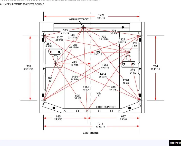

If and when you replace the front clip, this will help
The drivers shock tower and frame rail look a little concerning, Is its solid where the k-member bolts up?
A jab with a screw driver will tell you soon enough,

Thanks, @89oem, for the encouragement, and the chart.

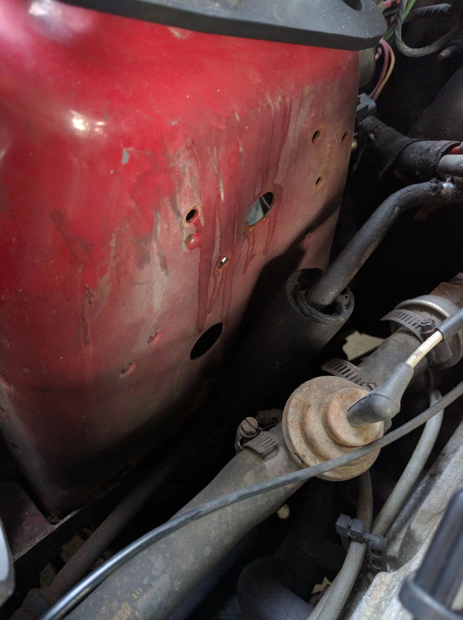

It is, and it isn't. Here's a clearer picture of the area:

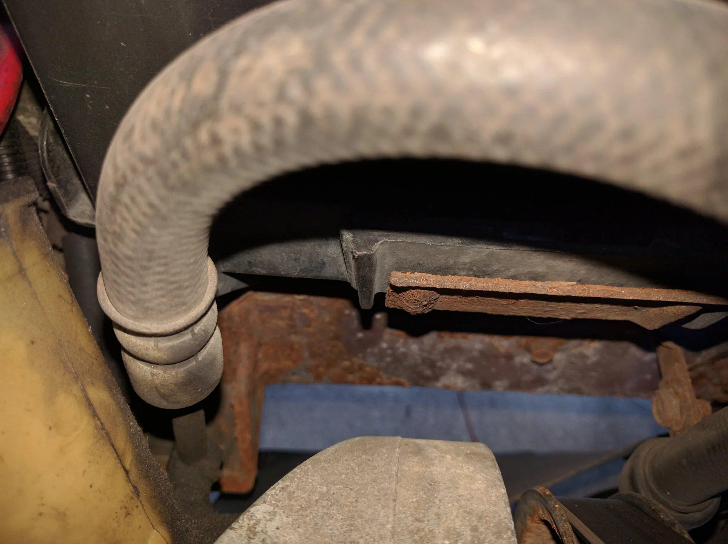

And here's a picture from the wheel well side:
Obviously, the metal on the engine bay side is pretty much trashed, but the metal on this side is solid.

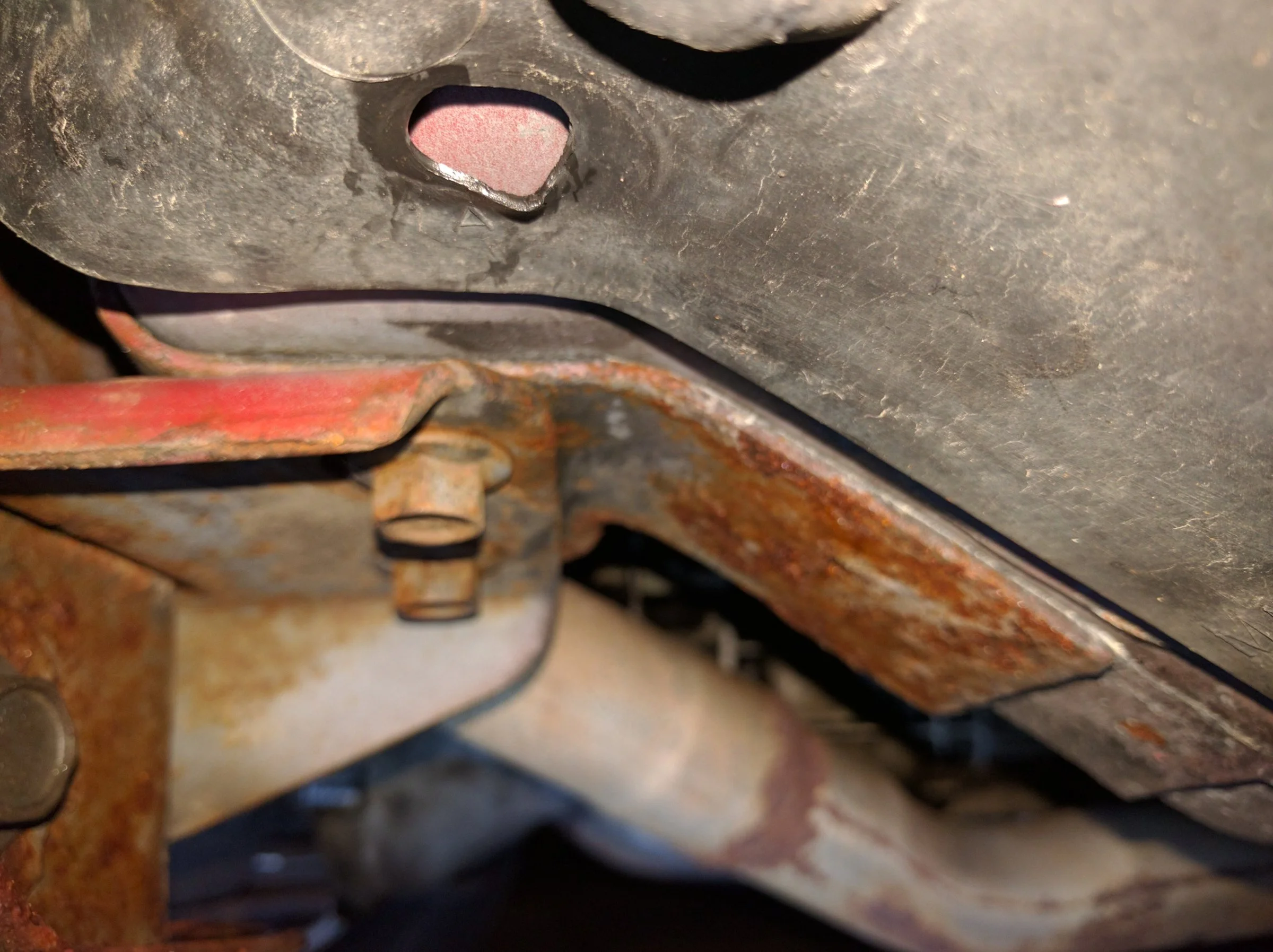

I also got pictures of the area where the K member bolts by the control arm:
This part is solid, too.
Oh, that looks better than the bay angle for sure,
It looks like someone let allot of brake fluid run and stay on the inside starting the whole mess....
It wouldn't surprise me. There are tons of hints that the PO was just handy enough to start doing things, but not quite handy or motivated enough to finish them, or do them right.
