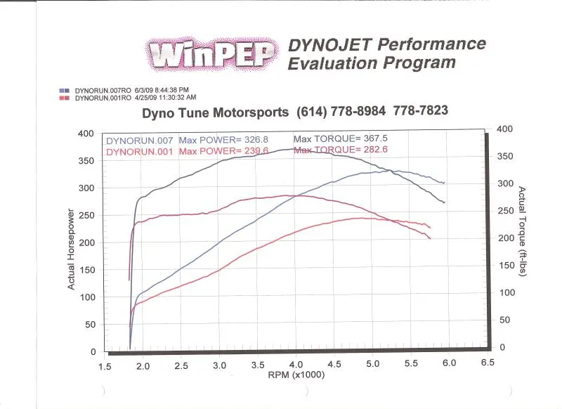

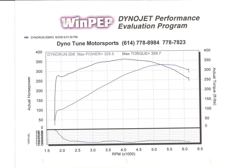

Well, my 331 build is finally finished! I had Woody at Fordstrokers.com build the shortblock and with help from a buddy, I did the rest. Its about 10:1 compression with Twisted wedge heads, Track heat intake and tfs stage 2 cam. BBK longtubes and o/r h-pipe. Lightning maf and 42lb injectors. It made 329.5hp and 367.5tq at the wheels. Thanks to Brian at Dynotune Motorsports for all of his help with the tune!

I tried to load the dyno sheets, hopefully it worked. One of them is an overlay with the stock cobra motor with pullies, jlt intake, shortie headers and o/r h-pipe.

You are leaving ALOT of power on the table with that setup. Still not too bad.
Throw on a Edelbrock RPM II intake, 80+mm Accufab TB, and a different cam. I bet your car picks up 50rwhp or more and alittle more torque without giving up and driveability.
that torque curve is nasty looking! nice flat and smooth. 300tq at 2500 rpm, i'll take that any day.
i was thinking the same thing, hell he has 275tq as soon as he hits the pedal. :lol:
and like adam said not bad at all for just a TF kit.
remember you paid for it, so as long as your happy with it that's what counts. if your looking to up the numbers in the future, it shouldn't be more than a cam swap for a bump.
btw how was your overall experience with woody? i have been considering either a 331 or 347 and his prices are very good.
Nice looking set of curves :nice:
Notice the word ... Actual ... That means STD
therefore
If the pull was done with SAE calibration the values would be lower
All in all ... Like Adam said ... for ots stuff ... I think it is pretty good :)
A more suited intake would not hurt drivability IMHO
and
I don't think it would shift the tq curve up much ... if any
With the added cubes ......
A bit more radical cam would not act as radical
as if
You only had the OEM block to work with ;)
anywho ... I'd have to say that would be a REAL FUN street car :spot:
