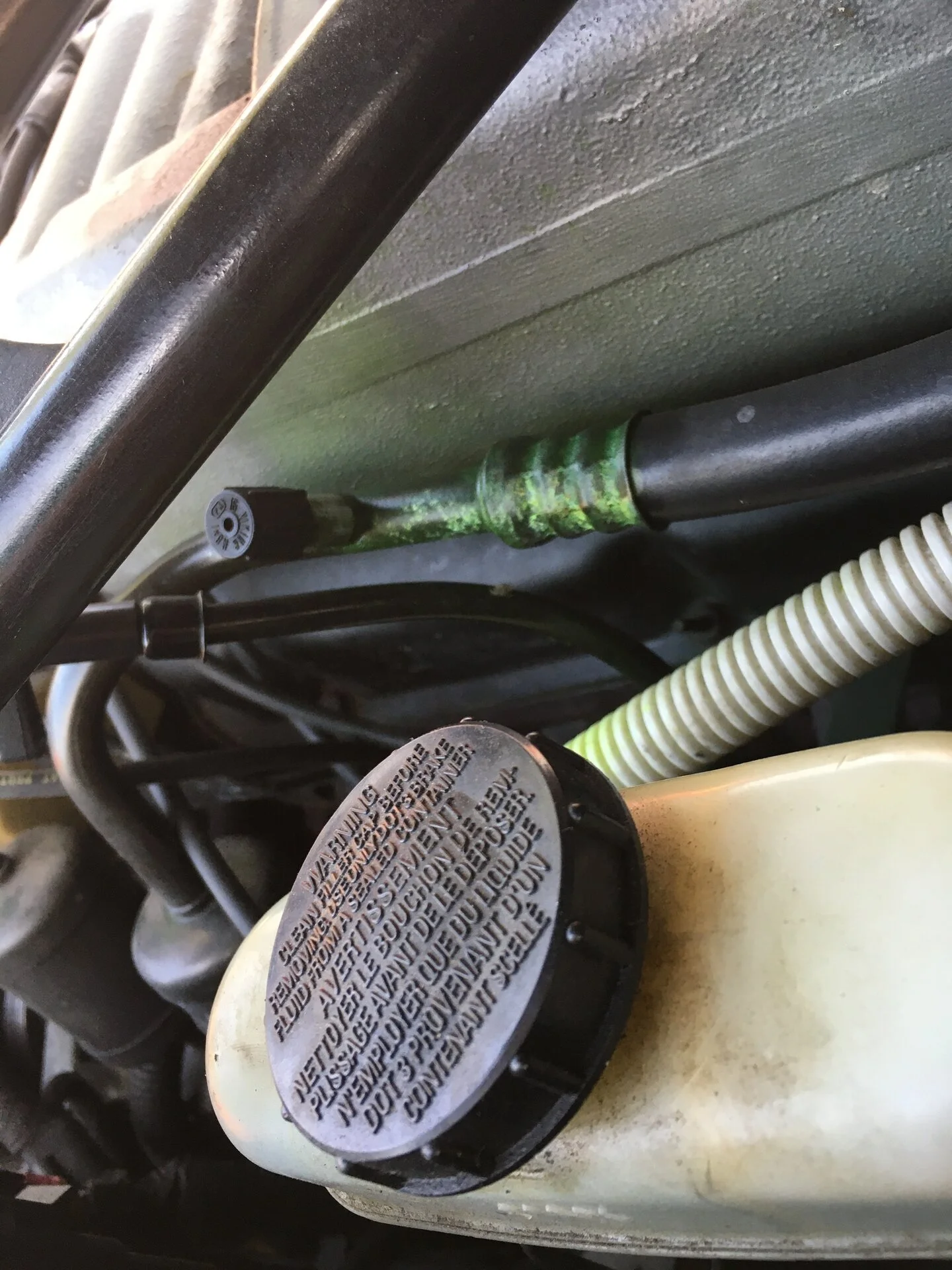

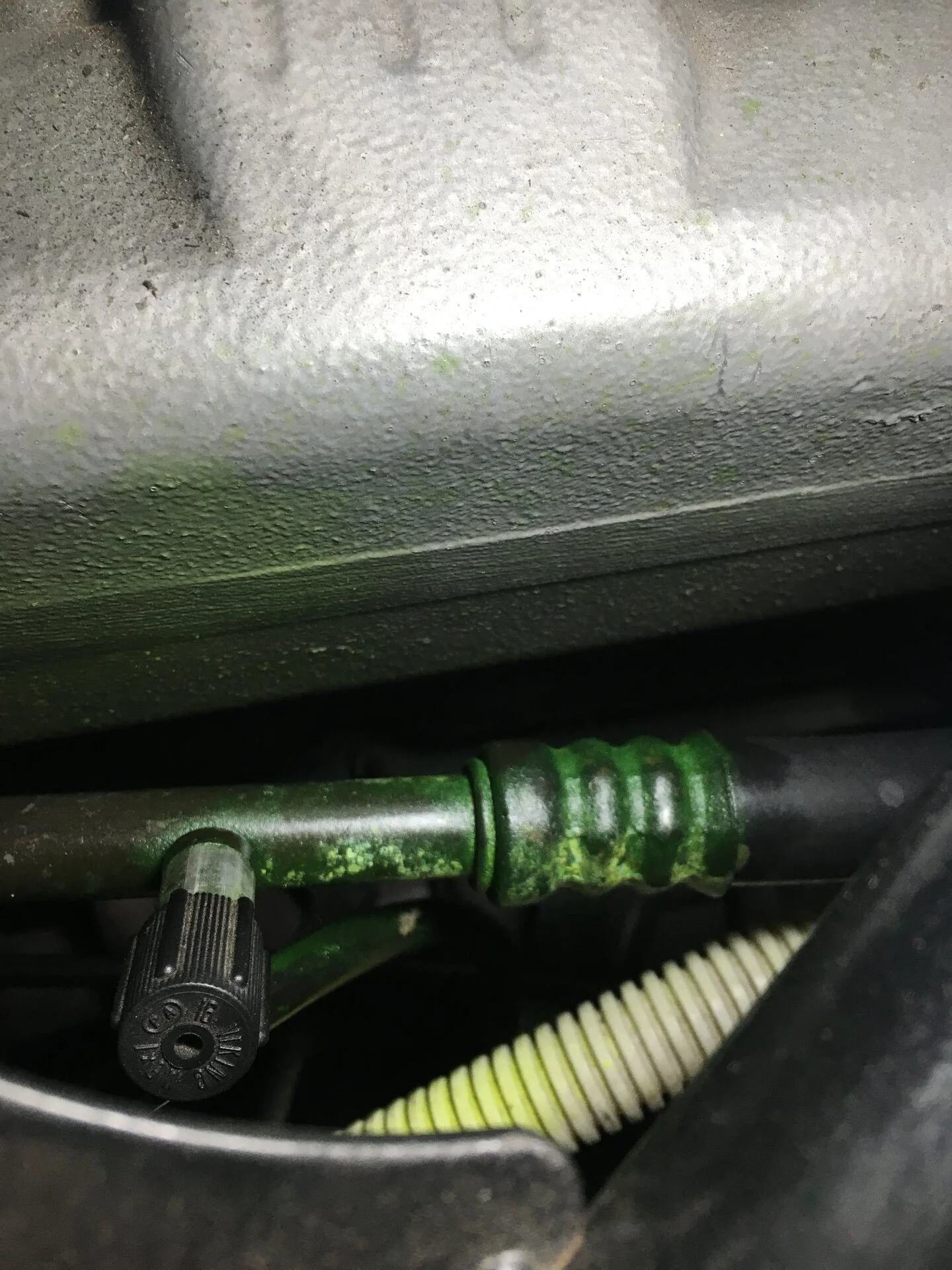

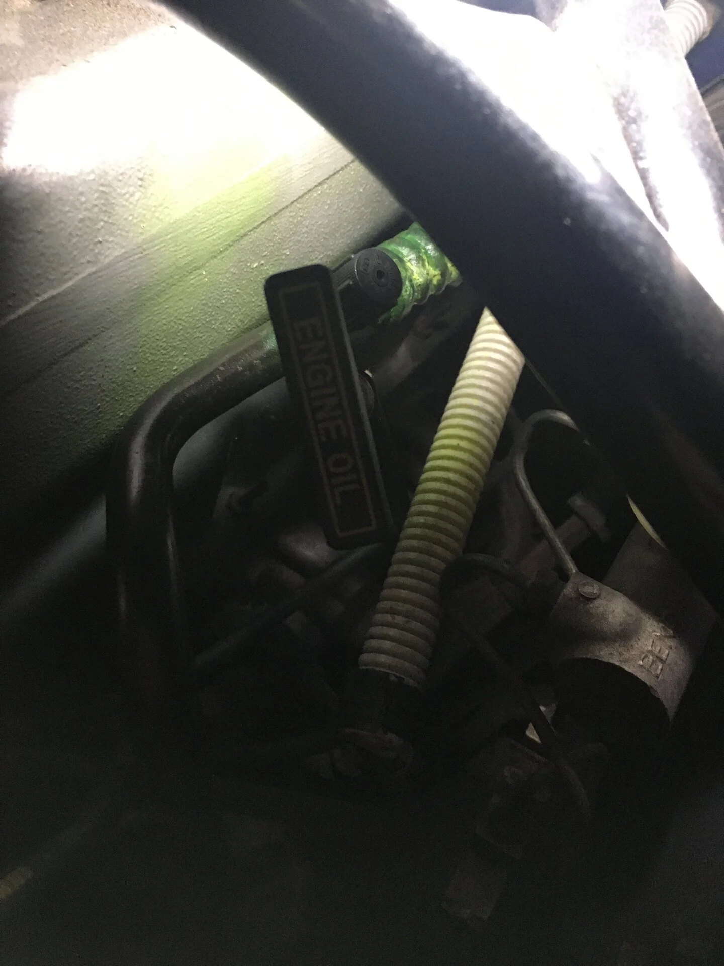

Hi guys. Something sprayed the side of my engine green and I can’t get it off. It looks like it came from the low pressure valve if my a/c line but the cap was on tight and when I took off the cap it wasn’t green inside nor was the valve. I’m attaching some pix. If anyone knows what this green stuff is and where it came from I’d appreciate the info. Thanx. I have a 1995 GT 5.0

The alien blood.. It came from the high side AC hose that is all green. That is UV dye added to the freon. Replace the hose or the manifold assembly and evacuate and recharge the system. I would maybe add an ounce or two of PAG oil with dye when recharging it. Some pag oil for sure blew out when the hose went. Brakleen cleans the oil with dye off pretty easy.

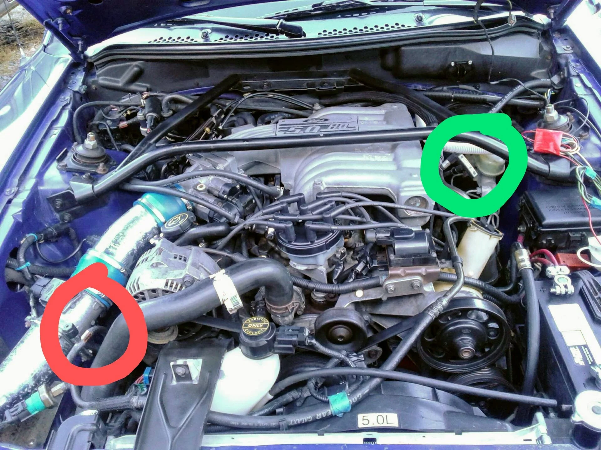

Manicmechanic007, those r pix of the a/c valve on the driver's side, isn't that the low pressure side? I had the car in a repair shop 2 weeks ago to have the a/c charged and they wouldn't do it. They said the valve on the high pressure side had come loose and was a pressed in style so I needed a whole new line on that side. He showed me the line on the passenger side of the engine and said it was the high pressure side. In the pix attached, the green circle is where the green spray is on my engine. The red circle is the high pressure valve. The mechanic said I needed a whole new line on that side. The other pic, is that hose setup I need for the green sprayed hose? Thanks for your help.

asaNYr, Yes, The Low side goes rearward towards the firewall. I could not tell from that first picture which line it was. That is why I said manifold assembly. The high side goes forward to the condenser and the low side goes rearward to the evaporator. Either way replace the hose. Whole new line should be cheap on ebay. Go to CheckerPepZone and see if there is someone like me in your area. I have AC machines plural registered with the EPA at my house and do that kind of thing cheap. Just did a Tacoma last week and the hose cost the guy 35 and I charged him 60 to replace it and he bought the new R134a. It gets ugly expensive if you have the new R1234YF ebay # 363311367532 should be your maniform for 73.21 free shipping from Chicago Check Ford because sometimes my jobber price is cheaper
